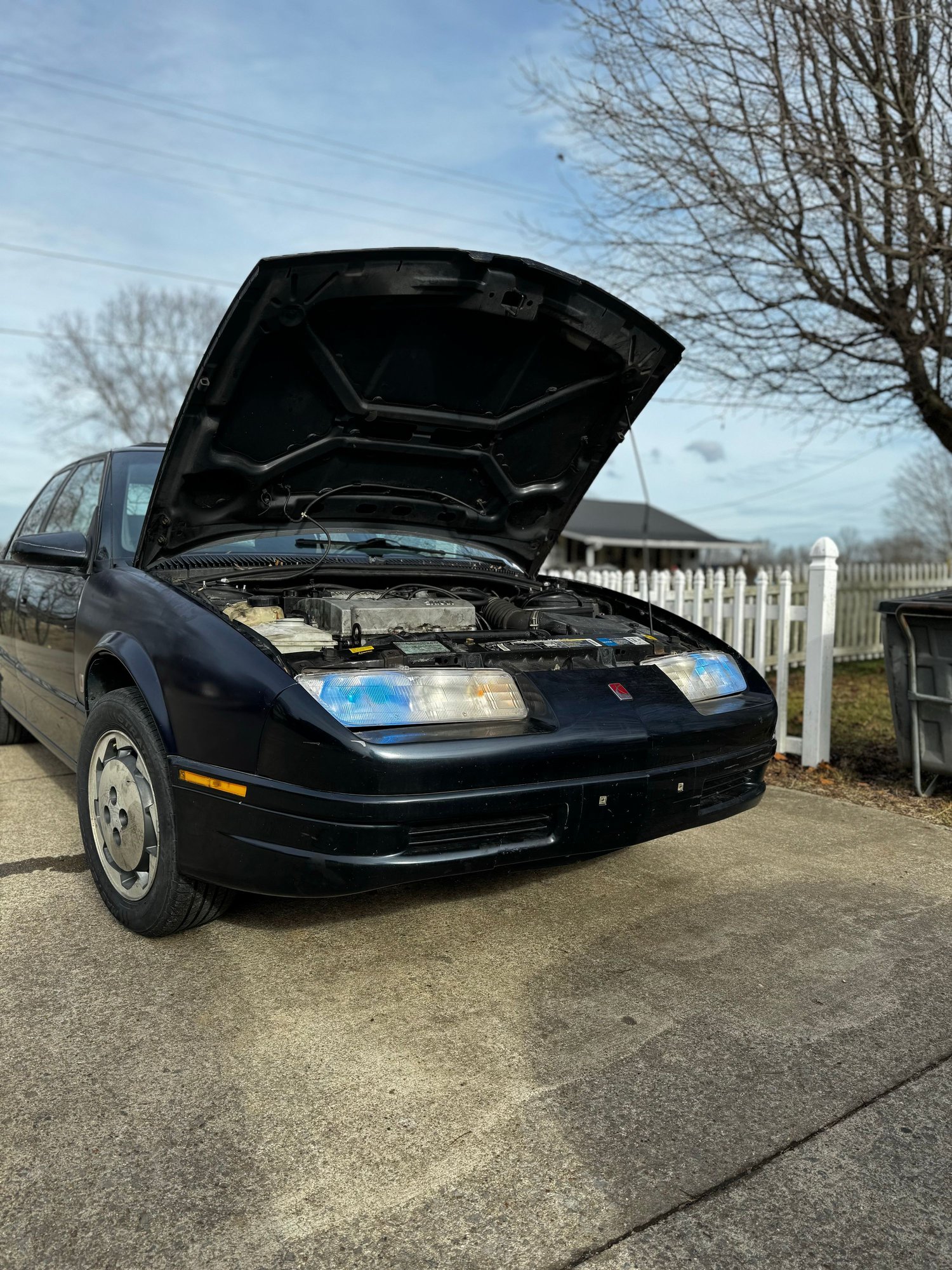

I recently purchased an abused 92 saturn sl2 with a 5spd and a fart can straight pipe. I’ve done some stuff to fix some missfire issues and ghetto rigging but that’s it. (Changed the oil, plugs, coils, icm. Cleaned the throttle body and egr valve. Replaced the battery. Gone through all the fuses, ran a cleaner through the fuel system)
(after its maiden voyage to the shop)
drove 40mins on loose front struts, loose motor mounts, and didn’t know manual.. we know it was dumb.. We didn’t die tho..
Side note I paid $500 for the car and have maybe $750 in it tags and all.
Car was/is in pretty rough shape. It has soul though and can be saved in my opinion. I’m not a mechanic by any means. I know basic maintenance and how to throw parts. I work at a orellys part time and do boat patching full time.
i have a list of things i plan on fixing for the car and have done some lurking in Saturn forums for a bit now. I plan on doing the Coolant sensors, intake and exhaust gaskets, getting a new egr and possibly throttle body. Gotta do water pump and thermostat, etc, etc, etc…
i was wondering if there’s any wisdom that y’all might have to lend to me. I don’t know much aside from nuts and bolts (ohms law, and stuff like that is alien to me)
some issues I’m facing right now are the engine mounts are missing hardware and I don’t want to go to a pull a part and just leave a motor hanging.
it’s leaking oil heavily from the rear side of the motor (pancake size pool on ground after turning car off few drips a second while running) and burns oil really bad when under load (going up hill not just high rpm)
It has hesitation randomly and gets a random missfire if you feather the throttle at 2-3k rpm (its most noticeable in 4th or 5th)
if y’all have any advice tips or just want to laugh at me im here for it. I hope to hear from y’all, thanks in advance
