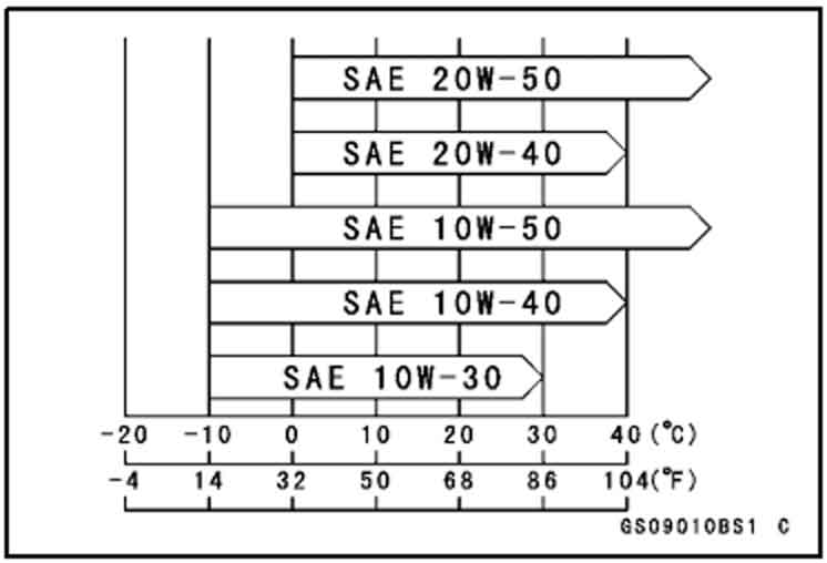

This is in my opinion a very important experiment. It has been reported many times when a Saturn engine (and this is not restricted to Saturn but to many modern engines that have had a steady diet of light weight oil, tht oil consumption as a function of miles and time has been excessive. And when disassembled the pistons and rings are carboned up and stuck in their grooves. I my self have pulled many engines apart, well at least a half a dozen or so and never found that to be true unless from expected abuse.
That is defined as driven way to hard for way to long with a light weight oil.
What is a light weight oil? One that is recommended for winter use and then when summer came not changing it to a summer weight oil. A practice universally done up to the time some one said, light weight oil improves gasoline mileage and the engine will last long enough to get out of warranty using the stuff. This makes the feds happy that we are getting better gas mileage and as long as it gets through warranty we don't care.
Or something like that. Enter 0W-20 oil which means at zero degrees or lower this is fine. W = winter the second number = summer the result in my opinion is overheated engines in hot summers and excessive oil consumption as a function of miles.
I have seen both.
I also have seen using what used to be recommended viscosity having engines last almost for ever.
10W30 was pretty much standard used at that time and 100,00 miles was hardly broken in.
I use 20W50 in dinosaur oil and 15W50 Mobil 1 in my Chrysler. I live where it has been over 100 degrees for 3 months. The oil I choose to use fits the environment I live in according to the attached oil vs viscosity chart. My saturn uses no oil and I do not expect it to. When purchases as a 2 year old used car it was serviced using 10W30 oil and changed to 20W50 about 3 years later. I suggest what was accomplished was a hell of a good idea and probably is a solution to a lot of ills. A little crude but effective. I like it. Now pick a better oil to use. At a minimum a 10W30. At best do a throw back to back in the day and look at the oil chart and select something.
