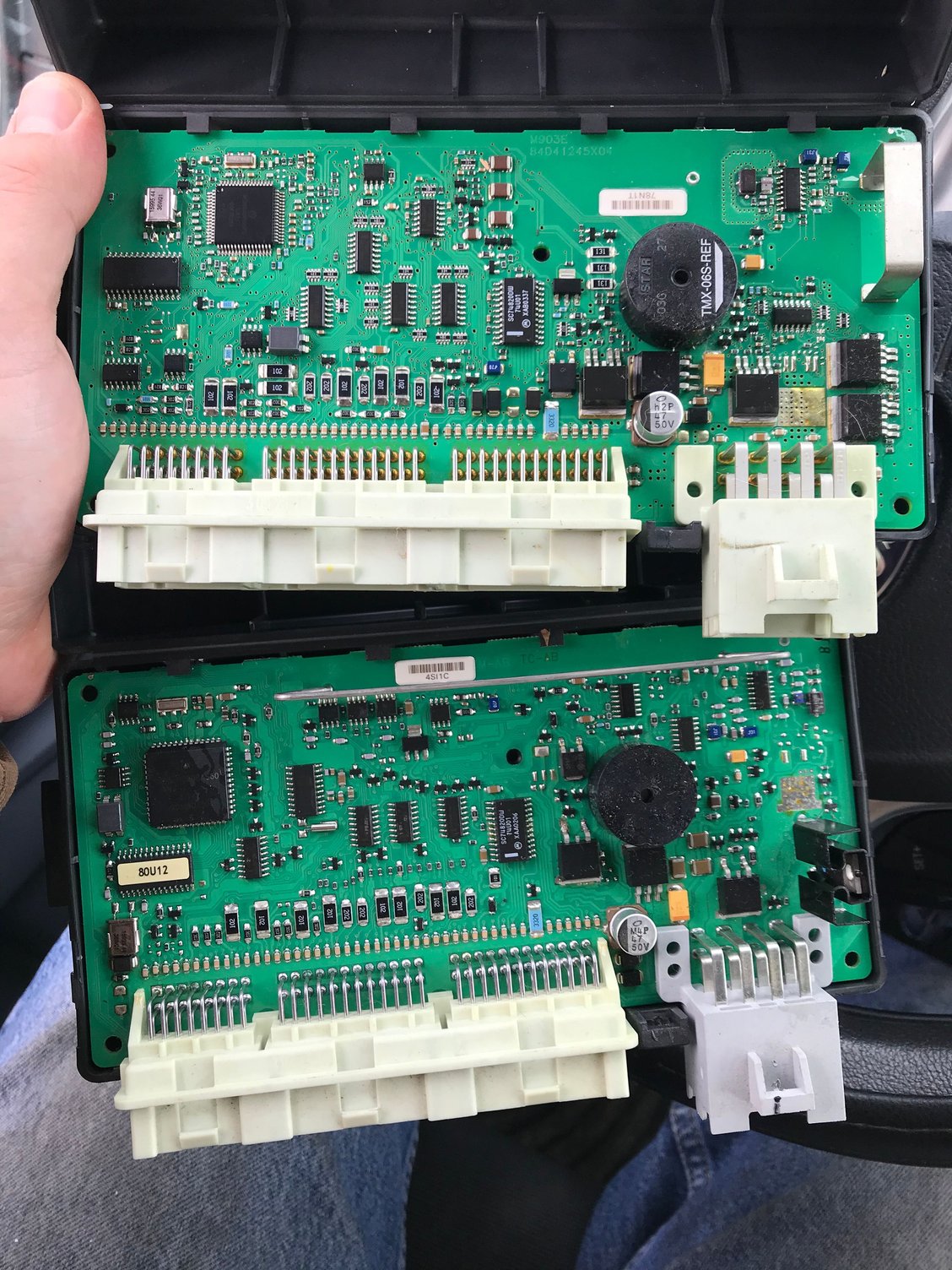

I just left the junkyard and grabbed it to body control module’s. One from a 2002 V6 and the other from a 2004 four-cylinder. Both are “A” modules and look as though the one in the 2002 had been replaced at some point. I’ll put the one from the 2002 in first and do the 30 minute pairing process.
I can at least then see if the car runs properly after that. Then possibly buy a refurbished unit that would have key fobs since I lose theor functionality. The other thought I have is I could install an unused remote start kit that I have in the garage. That would give me two remotes and remote start! But one step at a time. LOL
There are definitely some differences on the inside hardware wise. I’m curious if one is updated?
The top one in both pictures is the one out of the 2004
