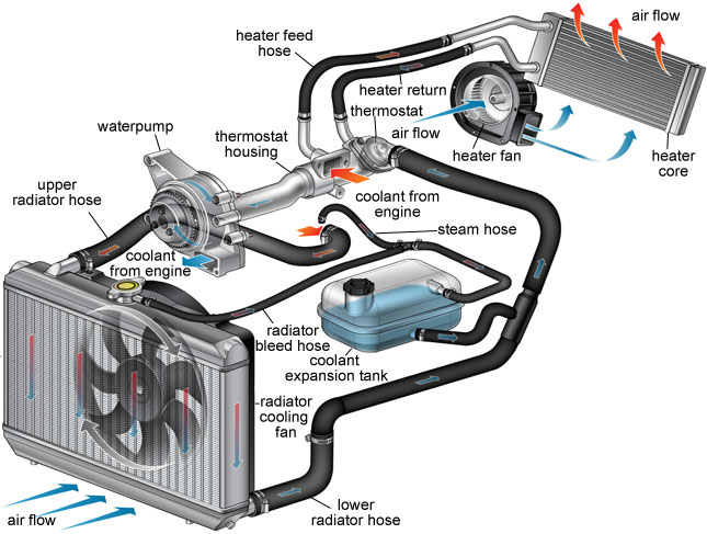

This is a drawing of the L200 system. It may help you understand the s series system. The coolant has to flow through the heater core. The coolant in the block and head has to get up to thermostat temp before full flow is allowed. The thermostat only allows coolant from the radiator to flow when the engine is up to temp. If you have an air lock in the heater core you cannot get the thermostat to open. I would open the system at the top hose and at one heater hose to let air out as you fill through the reservoir.Name:  IMG_0065_2.jpg

There are several things that are different on mine. I assume my 98 SL2 is the same as L2000 but the drawing you put on is a bit different. As I said, the bottom hose from the reservoir does T off, one to a metal tubing and the other goes to and enters the manifold just below where the bottom radiator hose enters the engine. The metal tubing must go to the heater core. I didn’t have a radiator cap on the old one and neither on the new one. I will open the top hose from the radiator and one of the hoses that go to the heater core. I want to thank everyone for their time and patience. I thought when I got everything reassembled that the difficult part was over.
