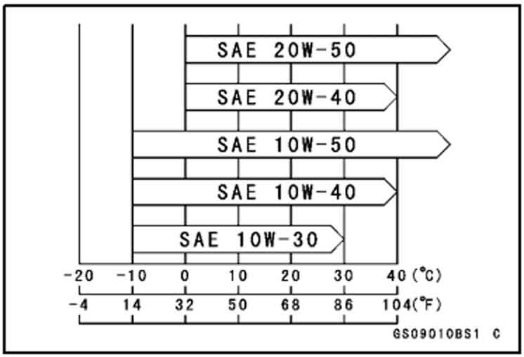

and a lot of people are wrong! There is a children's story that represents things like this. Chicken little ran through the country side shouting the sky is falling, the sky is falling. And he gathered a group of people to address the king! Who determined an acorn had fallen out of a tree and hit him on the head.
One person looked at the logic behind things and found it flawed! The repair suggested is flawed for a number of sound and mechanical reasons.
The thing consumed oil because a 5W20 oil was designed to be used in an environment that consisted of a cold winter. And it was too light to properly oil the motor when it was above freezing and driven hard!
But the people wanted to believe that using that oil magically gave better gas mileage so the believed it and they were wrong for all the wrong reasons.
Study the use of oil! Look at the temperature vs viscosity recommendation charts like the one here and see! And ask yourself "WHY?" doesn't my Saturn use NO oil at all and I have owned it since 1996 and it is a 1994 car and the oil used in it is a 10W30 initially and a 20w50 now, both oils designed to be used in the temperature ranges of where I live.
