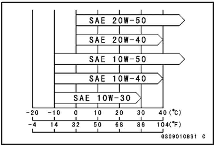

Some where in the late 1980's or early 1990's marketing got a big bug about advertising gasoline mileage in order to sell cars. (and still does) and found that if they pushed the fuel economy button people responded.
The fact is that if an engine has been run on a light weight oil, it does get fractionally better fuel economy if you are able to measure it in a very controlled environment.
The part IGNORED simply is, an engine run on a steady diet of a light weigh oil, also wears out faster.
Some times significantly so.
But and there always is a but, the factory warranties are generally 30,000 miles and also generally the car is traded off by that time and it is the second owner that gets to deal with it.
Not the factory, they sold cars.
Oil weight is determined by the two numbers in identification. The first number represents the lowest temperature nominally seen where it is driven. The second is the highest temperature the oil will perform satisfactorily at. Thus if you are a winter state, you might see temperatures below zero with summers in the odd high 90's. so a 5W30 might be appropriate.
But in a desert environment it might be lows of 35 and highs of 115 or so.
And the weight of the oil used is designed to protect the engine in those extremes. And historically it might even be changed by the owner for winter and summer usage.
But for marketing purposes, who cares, the engine will last long enough to get through warrenty and sold off to next owner.
And as it happens, when that marketing started, fast forward 10 years and 2nd and 3rd owners are complaining their used cars guzzle oil like a drunken sailor. Fast forward 30 years and it is a way of life and cars are lasting almost as long as they did in 1930 before oil filters became some what standard and you used 20 weight in the winter, 30 or 40 weight in the summer and owners actually checked their oil
And yes I am being sarcastic because reality is, that is what happened. Saturns have developed a reputation of guzzling oil and blowing up
The oil companies used to have an oil weight vs viscosity chart with recommended oil weight and you will find one too in your owners manual if your used car has one.
Saturns are not the only car that has developed that reputation, the internet is full of people concerned about it. Detroit and others are driven by marketing, The oil companies have finally responded by selling "High Mileage" labeled oils. Which are (surprise) higher viscosity. But if they has been used in the first place there would be no need for them.
I use 20W50 because I can with the temperature extremes that exist where I live. In every where except places like Montana or Wisconsin where there are only two seasons, winter and roads under construction something like a 10 w 30 or a 20 w 30 or even a 20 W 40 are a far better year around oil to use. And face it, gas stations used to maintain your cars , now they sell candy and cigarettes and maybe even lunch.
Claims of light weight oil improving fuel economy is true, but only marginally. Claims of light weight oil IS destroying engines but who cares, it is off warrenty.
My 1994 Saturn does not use a drop of oil. Nor does any of the other 5 cars I own. (Yes I have a weak spot on this). And the week after I bought my new 2007 Chrysler I started using 15W50 Mobile 1 synthetic and the dealer had a conniption. But that is the correct oil for my environment. And the dealer is after me to buy a new car before mine wears out.
Funny how things work that way isn't it.
The Chevy dealer wants me to buy a new car because they don't make Saturns any more.
The trouble is I lke my Coupe, it has 2 doors. And they don't make those any more either.
I think I'll keep both of them and paint the Saturn again. It is a 94, I screwed up the last paint job and it only has 110,000 miles on it.
