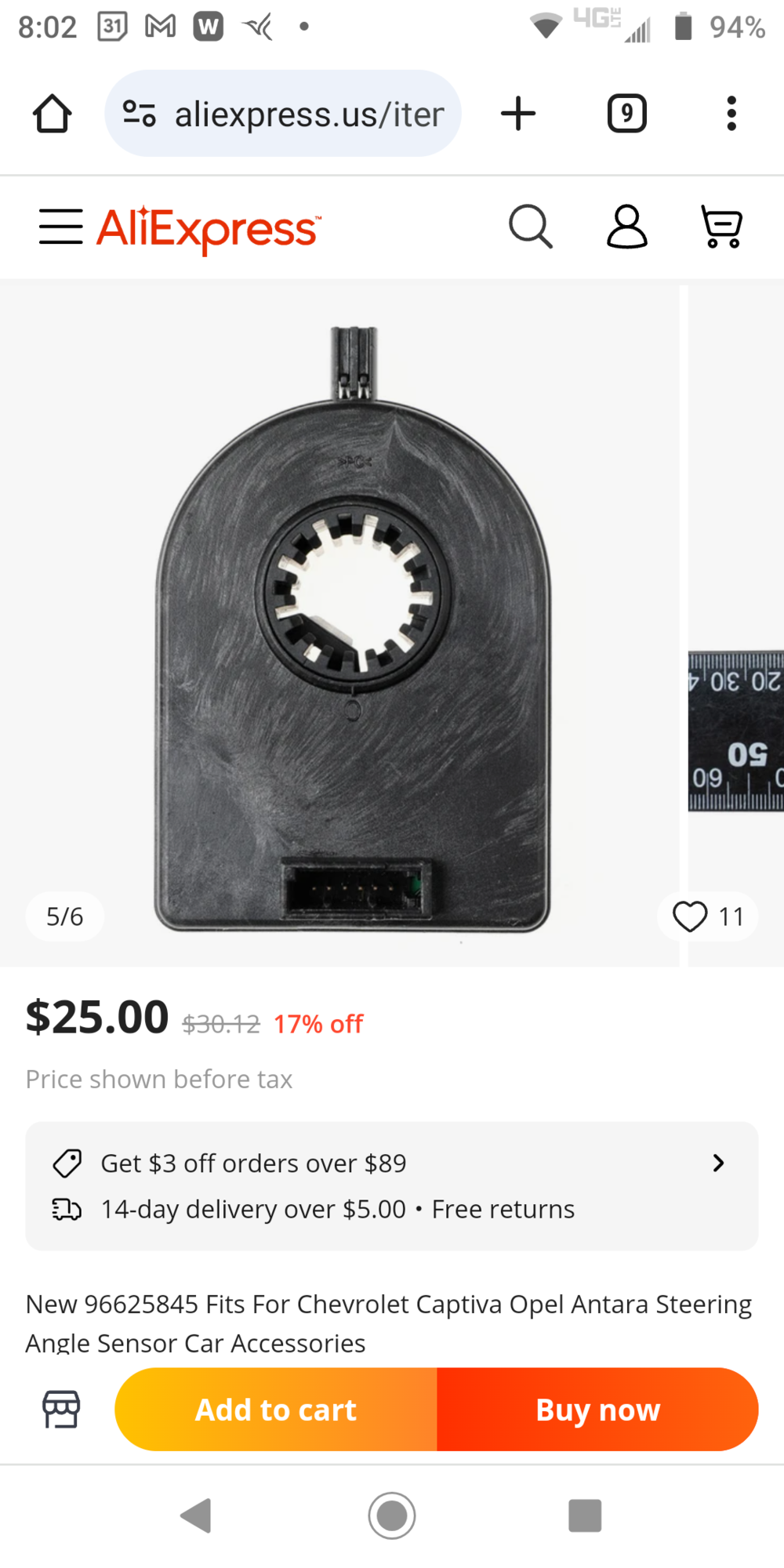

I did some searching on one of the older part numbers and found this.
Never purchased from them. Seriously, check out the Wikipedia page for The vue
Link
https://www.aliexpress.us/item/3256803425466127.html?gatewayAdapt=glo2usa4itemAda pt
There is a gap being added in the last part of the link it is not there when I upload it so you will have to fix that before searching

While you are at it, I think the Captiva was marketed to the public in Mexico. Might want to check Mexican eBay
Edit: it was marketed internationally. Please see the Saturn Vue Wikipedia page to see where and what it was marketed as.
Link
https://www.aliexpress.us/item/32568...2usa4itemAdapt
I got some really bad feedback from several people who have ordered car parts from Aliexpress so choose to steer clear of them. However, the local Chevy dealer was very helpful. The veteran parts guy (35 years) looked up the original part number and matched it with the replacement part number (used in the UK for the same part) and came up with one at a GM parts warehouse. Pricey, of course, but a new genuine GM part will instill confidence in its use. Should have it in a week or so.
