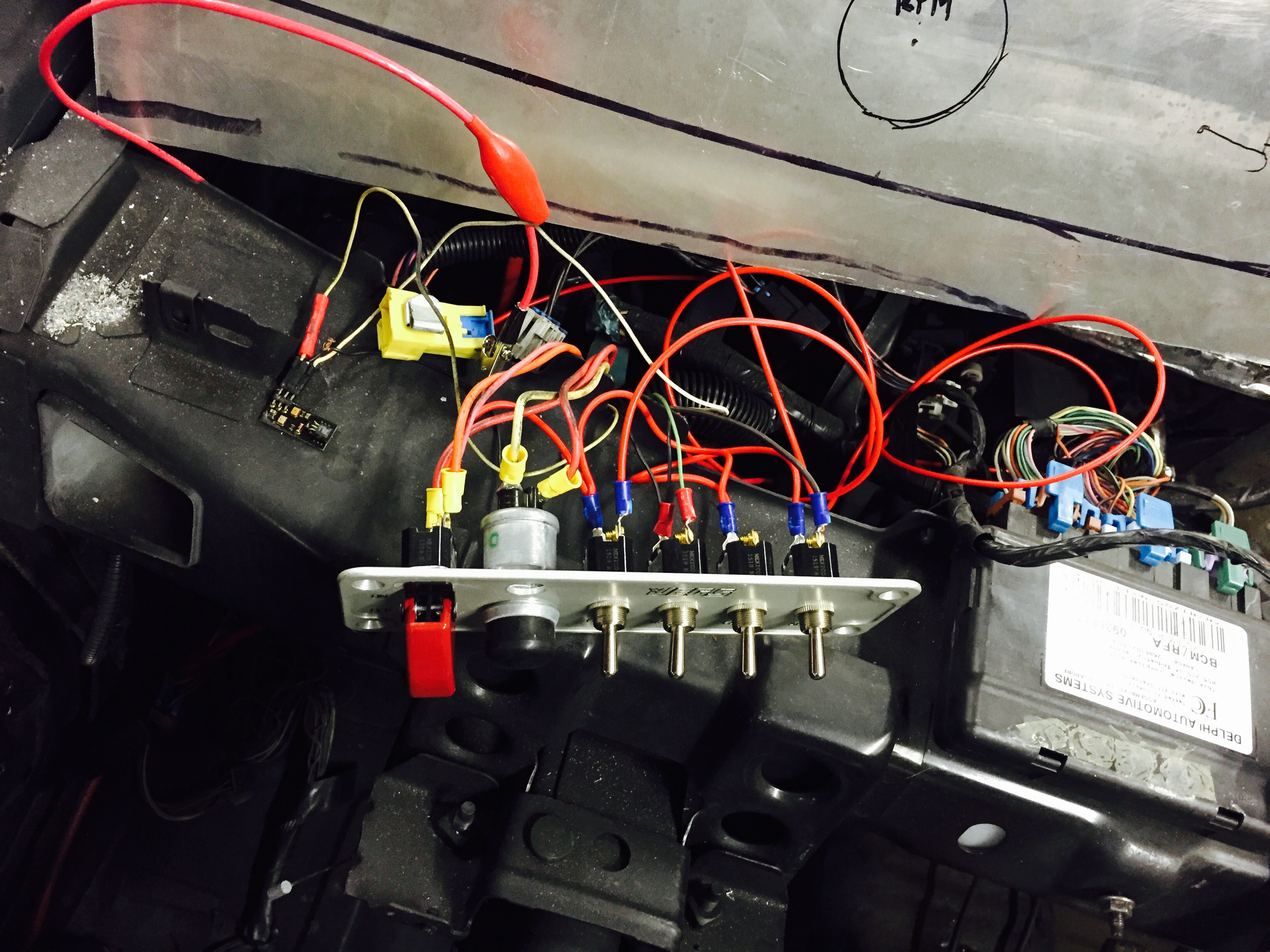

The green and black wires tell the car the key is in the ignition. From there I just used the ATS security bypass method. Fired right up

I posted the link earlier in the posts. It's similiar to what you recommended. Ignition on, ignition off, wait 30 minutes, repeat 3 times....
Old Feb 6, 2016 | 08:29 AM
Ok, now I understand.
Since you are not using a key, you just tied the green n black together to simulate the presence of the key in the ignition, then did the relearn procedure.
So you didn't install a security bypass system, you just simulated the key and reset the system.
As long as the cyl is not damaged and the passwords continue to fly back and forth between the pcm bcm and ign cyl, you're simply doing a key simulation.
My only guess as to how it started at all prior to the key workaround is that the system was fubarred enough to not have any real clue what the deal was.
