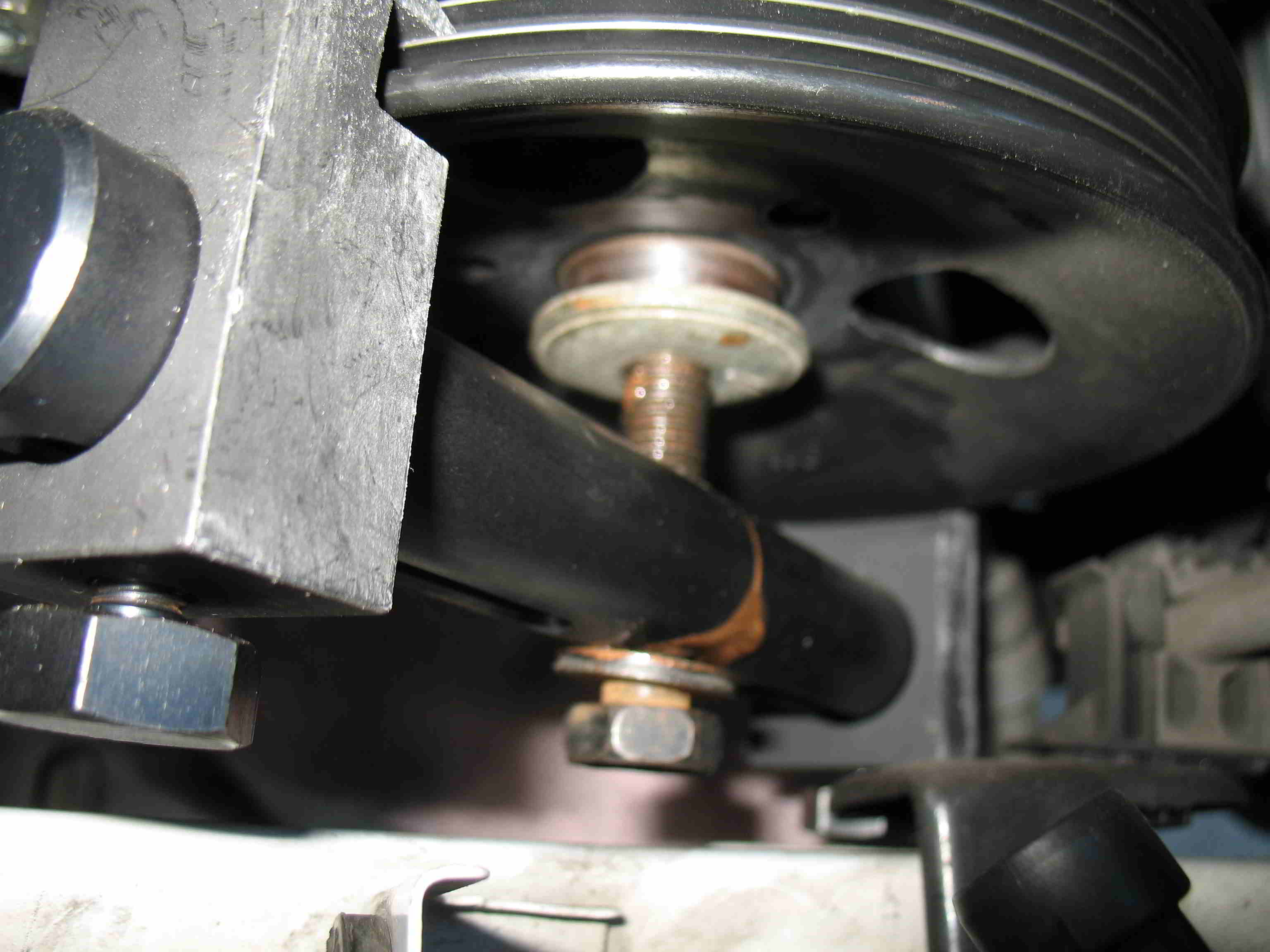

Awesome, heavy duty tool. Great construction. Exactly what you need if the power steering pulley is stuck on a V6 Saturn with less than three inches of clearance from the frame. Not quite out of the the box, though; however, all you need is a shorter bolt (M12-1.75 x 45 to 50mm), which you can find in any hardware store, and a thick, wide washer like the one at the top of shock absorbers so that the bolt is pushing against the pulley flange and not the pump shaft.
If you ever find yourself with a stuck on pulley and little room, try this tool first. It is well worth the money.
Here's the puller in action on the L300.

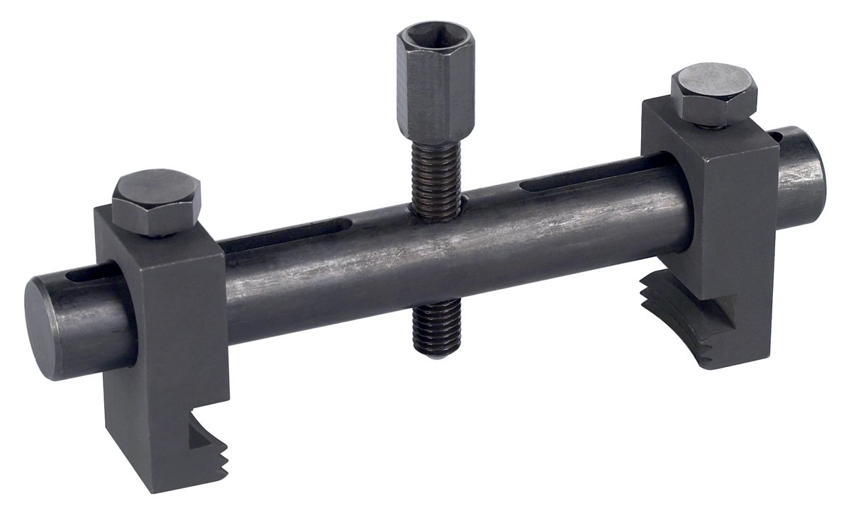

If you look the puller up on Amazon, you can see what the puller looks like out of the box. (http://smile.amazon.com/gp/product/B...ilpage_o06_s00)
