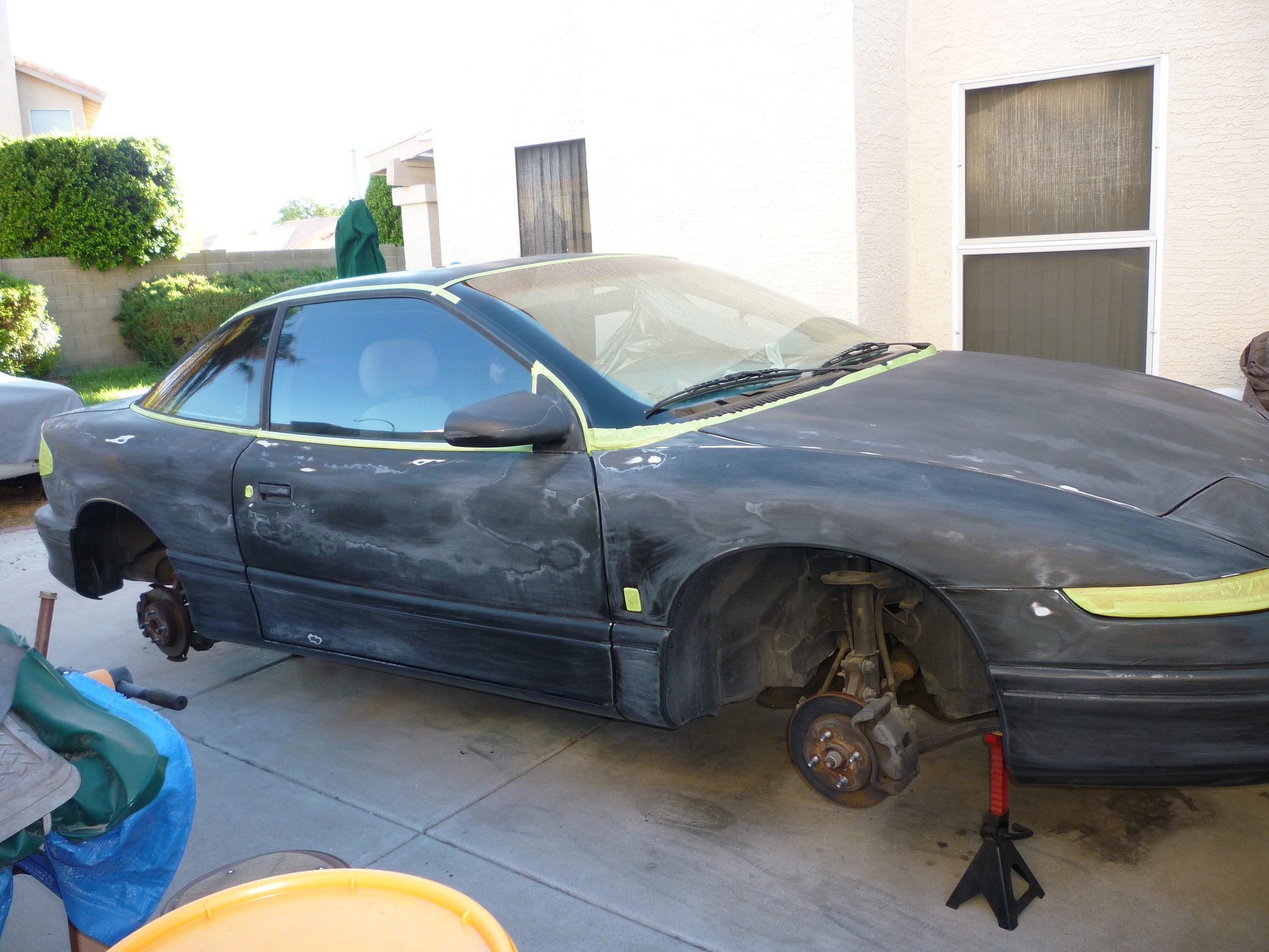

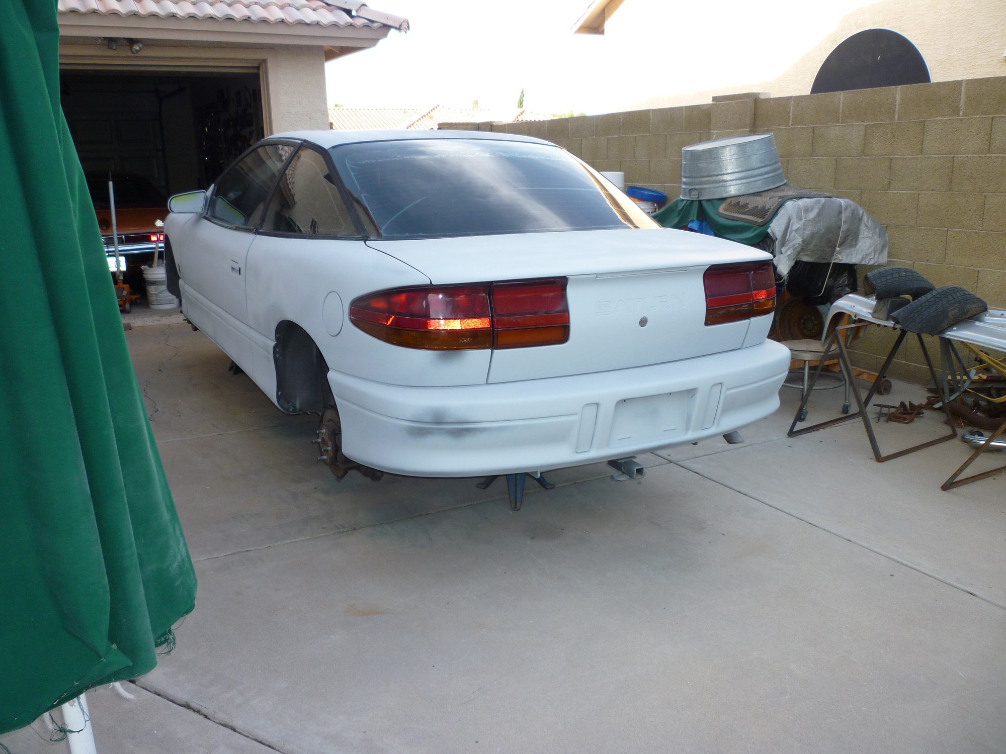

Today the temperature had dropped to below 100 degrees and the wind was light so I prepped the body of the Saturn by sanding with 220 weight sand paper and a couple of choices of soft and/or flexible rubber sanding blocks along with hand and fingers for small tight places. I started using a light weigh D/A compressed air sander with a thick soft pad but there are so many body characteristics that required hand sanding to deal with them with out burning painted areas I ended up using a hand sanding method, dry!. I was able to see surface problems if caused by the damage the clear coat of the previous paint job deteriorated caused and I found that the method I used along with the 2K primer pretty much dealt with that sort of problem.
I had a few areas I had to spot putty and re-prime but I think on the hole everything will come out good. It would have been nice to totally remove major body panels and deal with them individually but it is not something that is dealable at this point in time.
I have too many unfinished projects and too little time to do it that way.
The next nice day (soon) I will mask or bag the doors, trunk and hood and will "jam" the openings and when dry I will then try to get a coat of paint on the body.

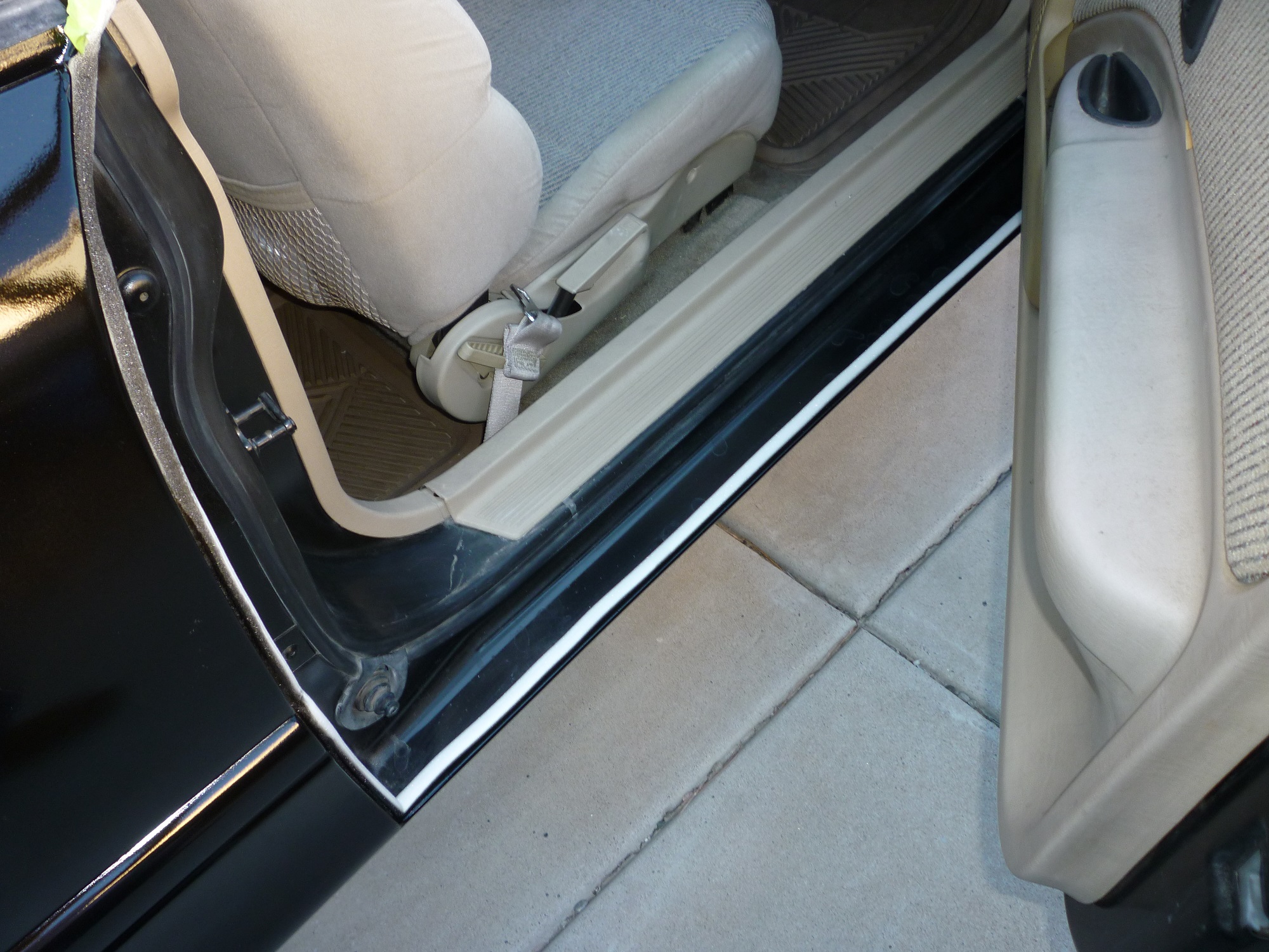

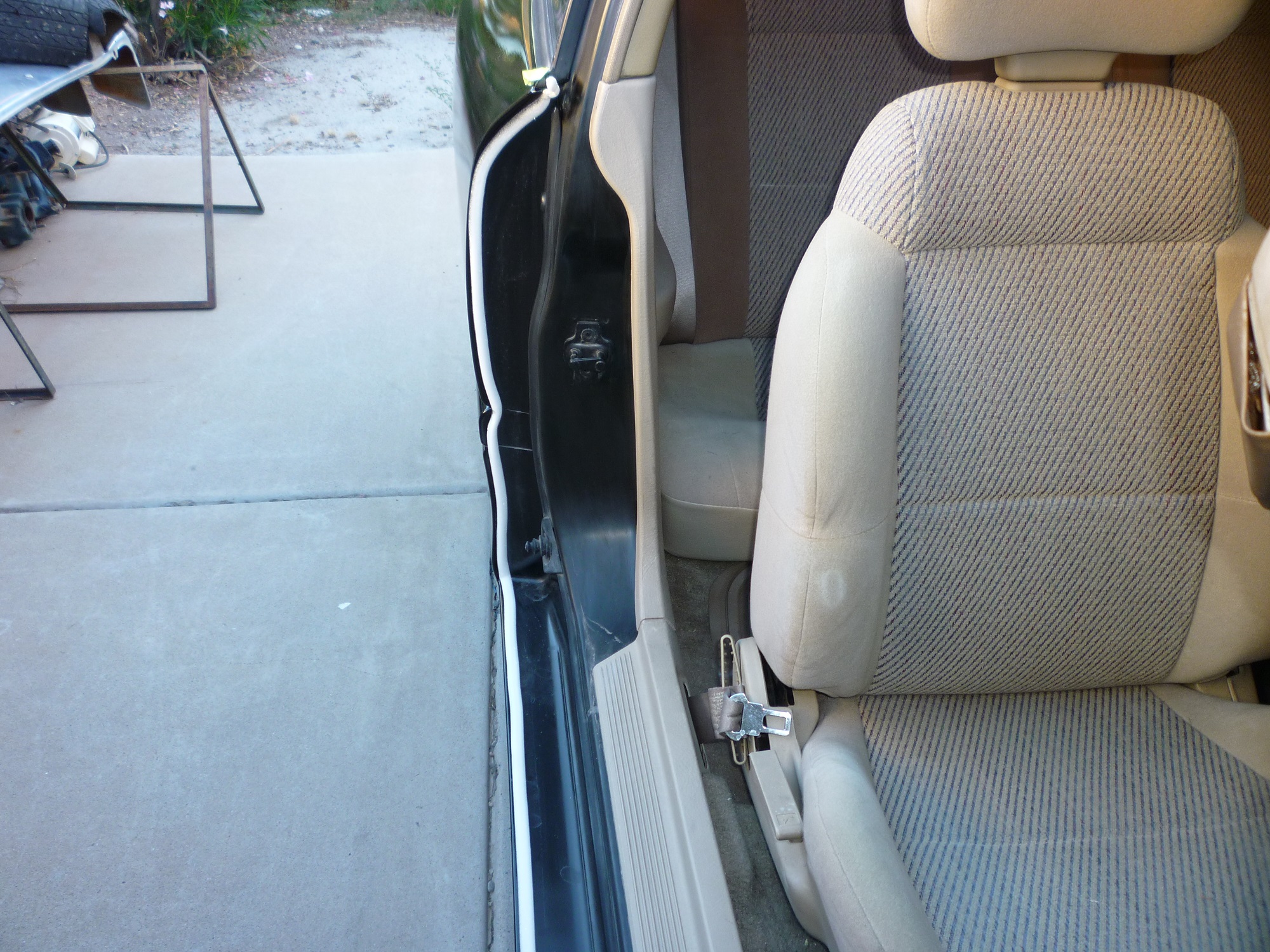

Painting actually is a lot of basic work, taking time to mask off that which you do not want painted is tedious and time consuming. The body has been primed and block sanded fairly well so the next step is actually to start painting and I have done so by painting the roof first as once it is done the rest of the car can be addressed for masking. I painted the roof the other day and I am quite satisfied how it came out. It so refreshing to see body color where it belonged with out seeing it damaged. It will now be easier to mask off the car from the window line up in preparation of doing the rest of the painting.
The car has a moon roof in it that opens, but as time has passed not only have the gaskets gone bad but the plastic material that housed the switches and the switches them selves have failed and there are nor replacement parts for those in this area. The sun destroys plastic pieces and Saturn's are known for being plastic. I will be satisfied to be able to look through the clear roof to see the sky, but opening it I think is a function I will no longer be able to do. I know I can no longer locate the switches and I am not sure I find the gaskets to re-fit everything with and they need replacing.
Once masked I will make a quick pass of the body with a Green Scrubby like material and wipe it down with a clean cloth and some acetone and then go after it with the paint gun.

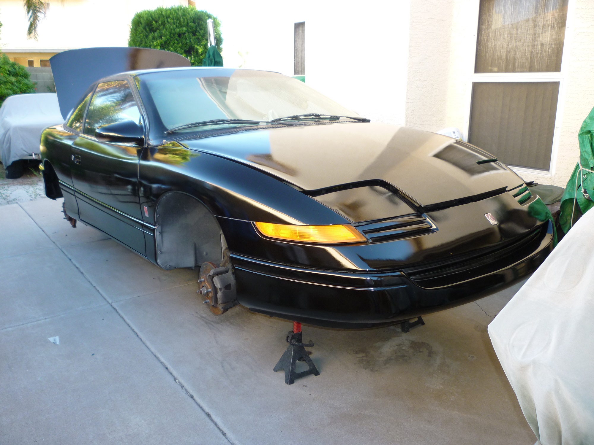

I have to install the wheels yet
and do an oil change, but this is where things are at.
The car was repainted in 2008 and 2 years later the clear coat started strip off when that happened I found that I had not followed the rules correctly on using base coat/clear coat. That took a bit of time to discover. This is single stage acrylic enamel in the original color, a 1995 Black Gold. The clear coat cause a lot of damage when it removed itself and I have it repair fair. But it looks nice. I found a product that can be seen on the doors, that when the door jams are done this foam tube with adhesive is applied to the door opening and the door is closed on it, keeping over spray from screwing up the door opening. It can be used on the trunk and hood too. However I will let things dry for a month or so and the buff it out. Now to clean up the wheels and tires, change the oil. I will use Mobil 1 15W50 and make sure the tune is o.k. and the A/C works. The moon roof I will leave alone for a while. It needs new gaskets and such and I need to find the parts and the switch's are iffy as is the housing. The plastic bits and pieces have deteriorated. I don't need to cause my self more repairs at the moment.
Anyway here are some pictures.
