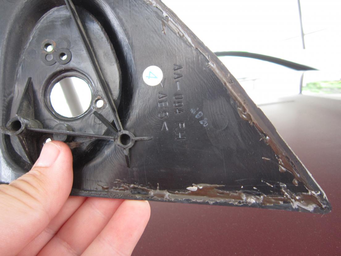

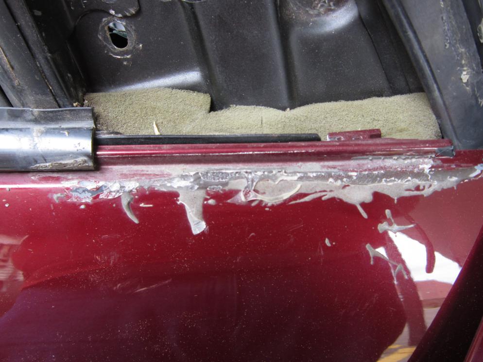

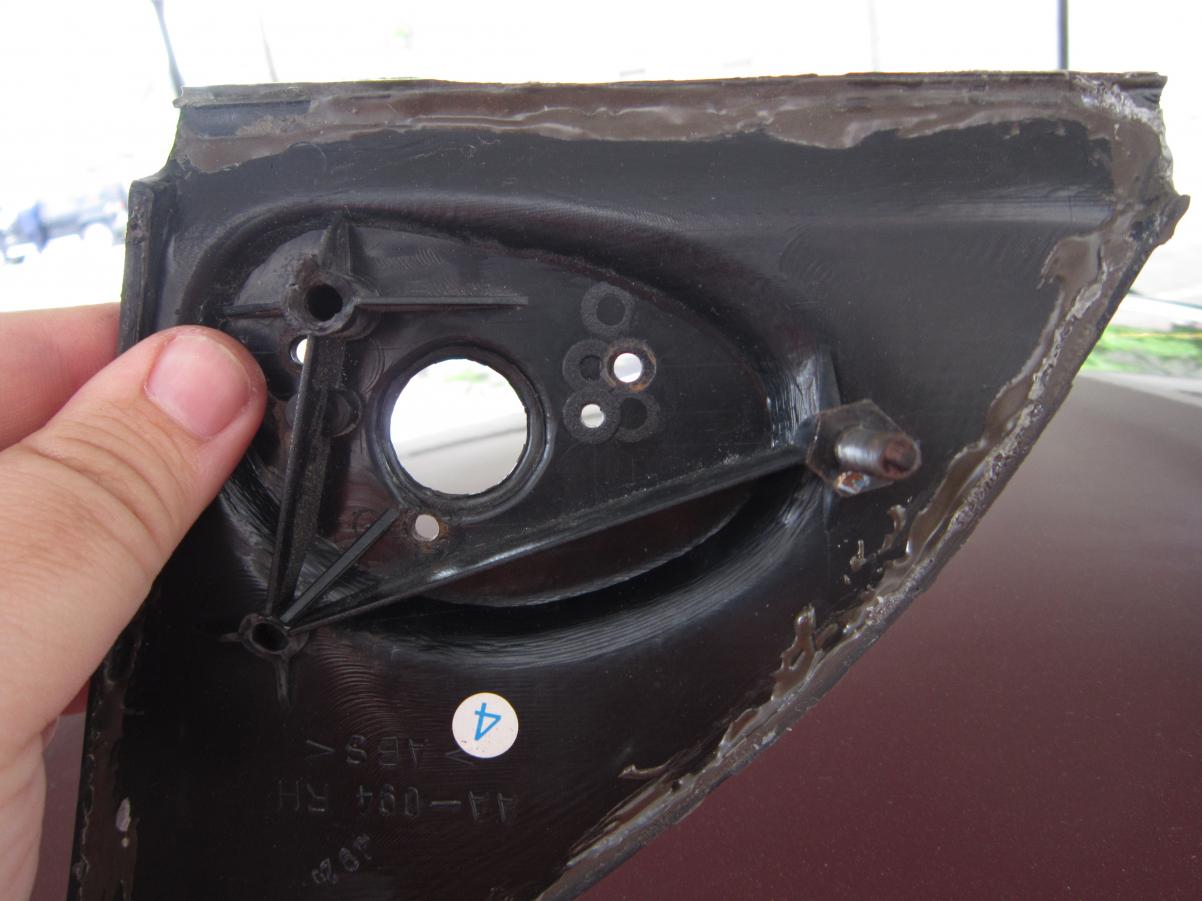

You're welcome Dave! You said it's hard, and looks gray from the pics, I can also see drips, it is a two part epoxy of some type, no matter what type, when heated it will soften. Get a heat gun with different tips, the smaller the tip, the more concentrated the application will be. Yes, plastic will also melt, that's why you do a small area at a time, not the entire area all at once. It's trial and error, the smaller the area, the easier it is to work. Heat for 5 sec. and scrape, if nothing...5 more and try again. Start with heat gun on lowest setting first. If nothing, try the next setting. If you were doing the whole door, yes I would worry about warpage, but not the top of the door. Tops and corners are less apt to warp than the center areas. Most molded plastic will realign when heated, "Memory Retention" unless it's heated to the melting point. With 5 sec. intervals, you won't get it that hot. After you scrape off a small area, douse or spray with water to cool down the surrounding area. Just don't rush it, and you'll be fine. Trust, live and learn Grasshopper...LOL! Best of luck on your new Apartment too.

My mirror came in the mail and I put it right on. Here's some more pictures of the stuff.
