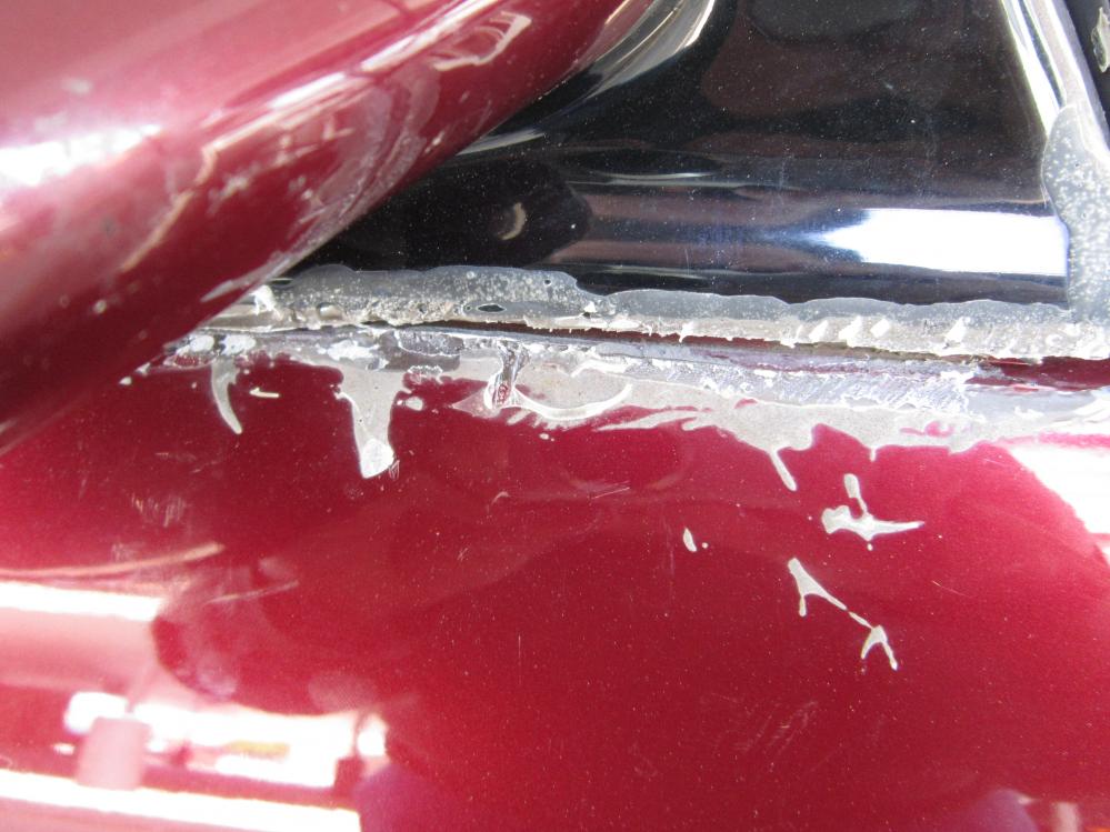

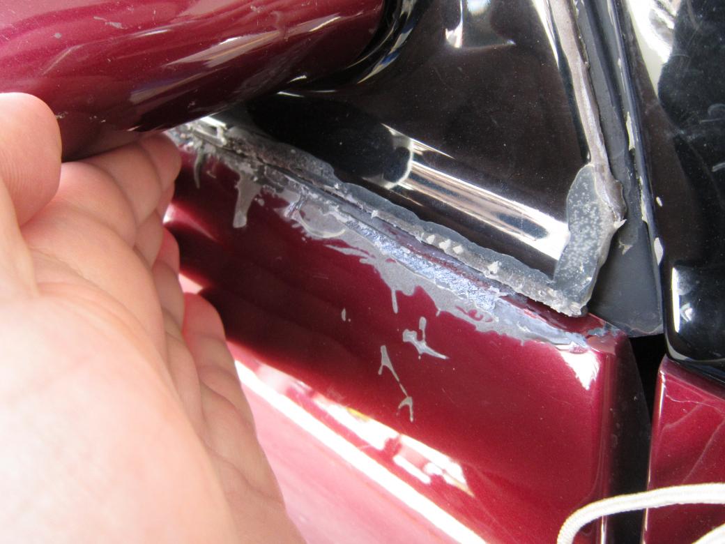

The previous owner of my SC2 used some kind of cement to attach a broken mirror back onto the car. I'm in the process of repairing it correctly and I was wondering if someone had any ideas about cleaning up the area.
I'd like to save the paint if I can, Cranberry is a very rare color. I can try scraping it off, but if there was a solvent I could use, I would be grateful!

If it is some type of thin clear glue, it may be cyano-acrylate based (like KrazyGlue) in which case in can be dissolved CAREFULLy with acetone (found in Nail polish remover or found CONCENTRATED at HD, Lowes, etc. Try some nail polish rem first w a q tip on an out of sight spot to see it it works.
I don't doubt that concentrated acetone will wreck the clear coat and paint--it's used as a solvent for many things, so don't go there.

Ok, photos can be found here.
