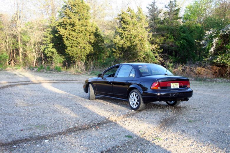

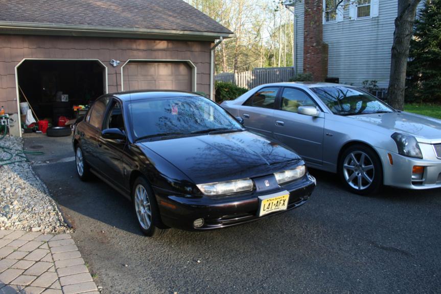

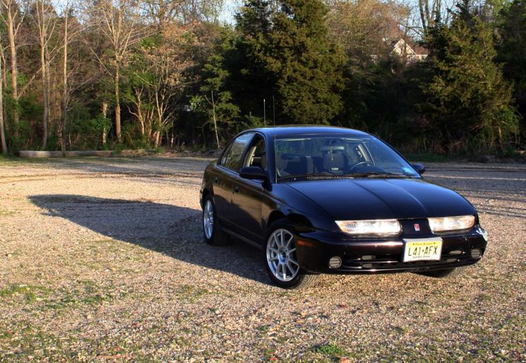

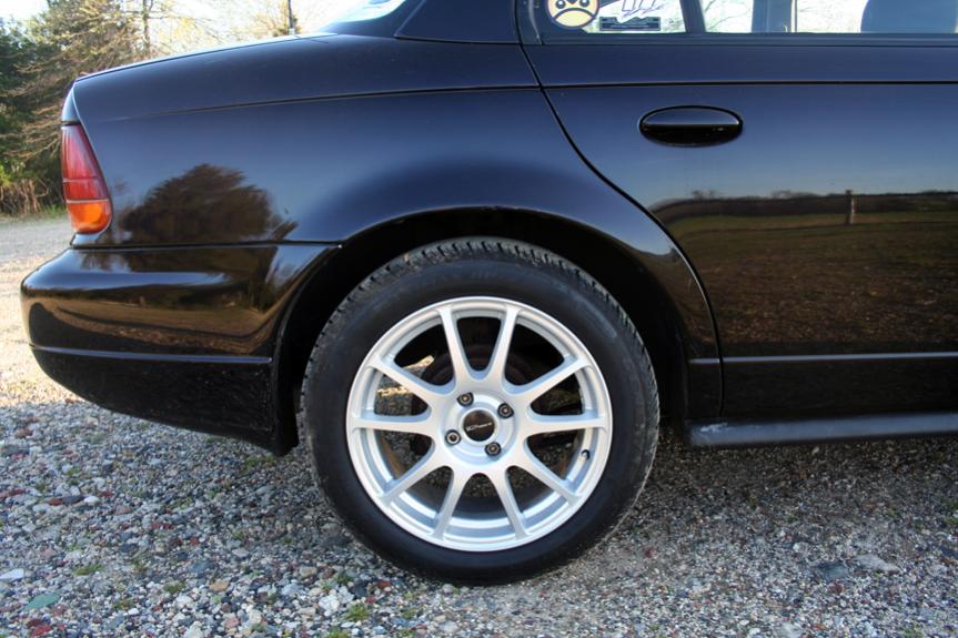

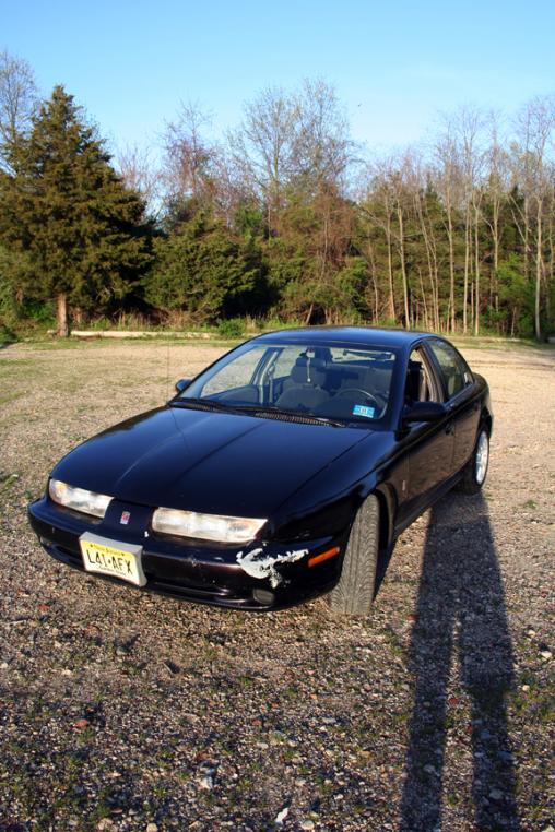

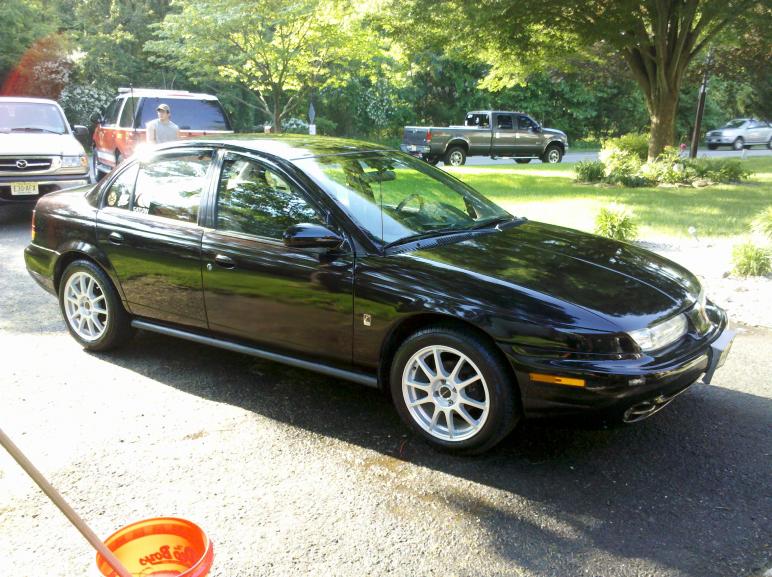

Well, Im sure we've all done it once. Just take photo upon photo of our car. Since my brother finally gave me back my camera, I took the car out and took some pics.

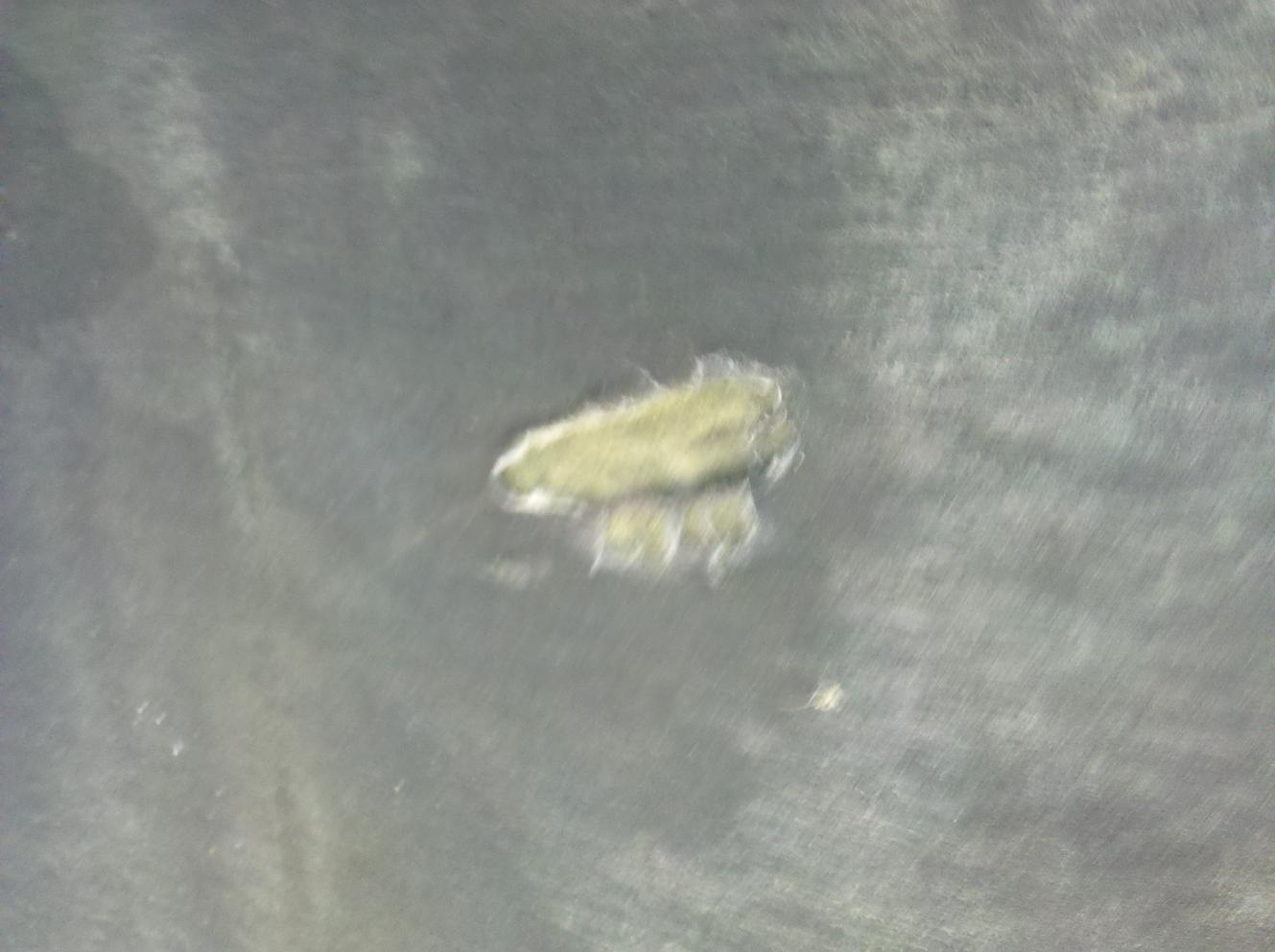

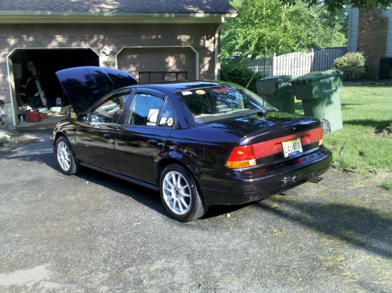

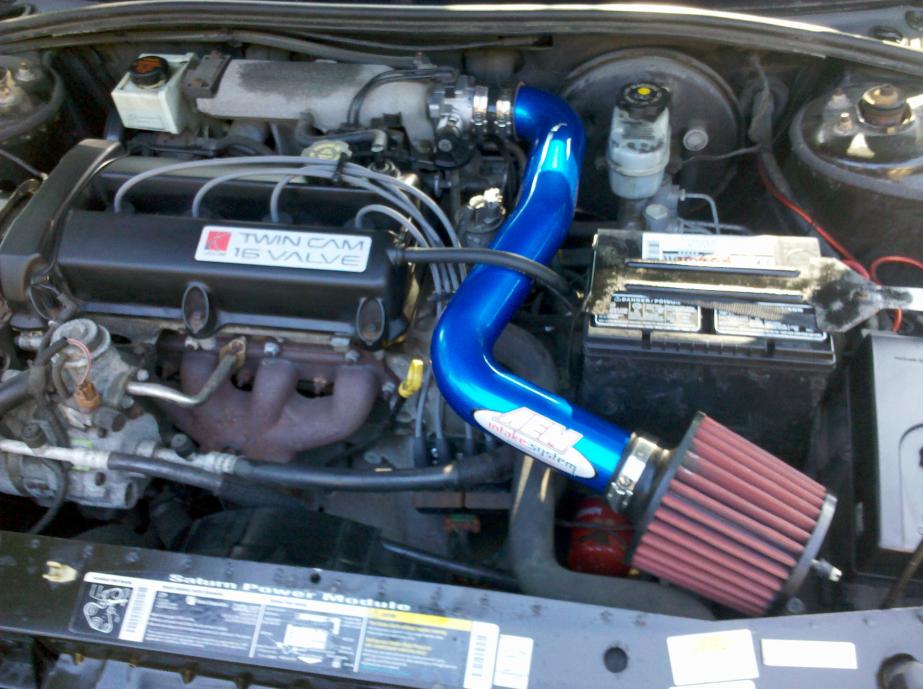

Well a few months back I mentioned (on another section of the forum) that I was looking into short ram / cold air intakes. Well I got one (nearly 2 weeks ago), I got the Short Ram from AEM. Even though the websites say its for an SC2, it fits fairly well. Theres a slight bit of rub on the hood but its all good (theres a picture down there to show that).
All would be good if I can figure out that acceleration problem (but thats another thread)

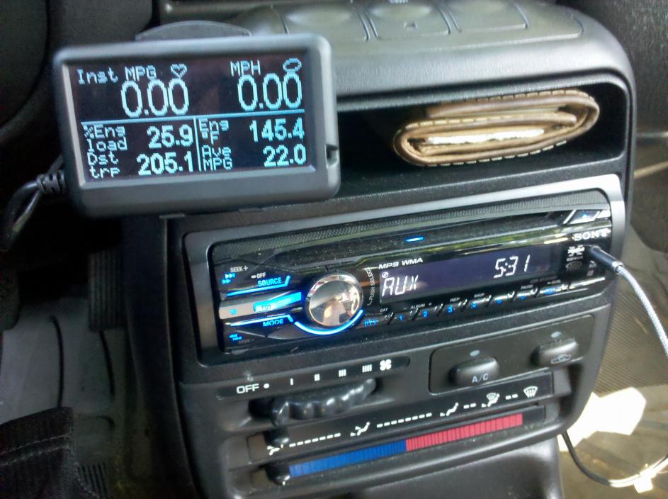

Uhh. what else... Oh, I added an Ultra Gauge.
Picture time now.

I'd like to raise a question, not that I have a problem with spending money on personalised auto modifications, you ought to see some of the stuff I spend on but! On these air intakes, I fail to see a benifit. Despite advertising to the contrary. They all expose the air inlet (the filter) to under hood heated air trapped from where ever it can be attained. It is a given that cool inlet air is a benifit to developing power. Pre heated air is a disadvantage. Each of these items replace an air air inlet system while possibly more restrictive, not proven, but possibly however they also supply cool air obtained from out side the engine compartment to the inlet side of the engine. A commonly preferred and proven method of increasing performance.
So? Where is the benefit derived from?
Short ram intake I found is good for on average of .168 in the 1/4 mile on TwimCam S-Cars. The cold air intake with BBTB is good for about .213 in the 1/4. With no other mods I found doing exhaust work is worthless.
@sw2cam, while the comments on the intake surprise me I'll take your word for it, you apparently have actually proved it. Good enough for me. As to the exhaust, that pretty much has been my experiance too. If you have not done some serious engine modifications and are reaching for some really high rpm most modern factory exhaust systems are more than adequate in getting jobs done. Mostly by the time exhaust systems start adding anything measurable, the car is also no longer streetable. For the most part.
