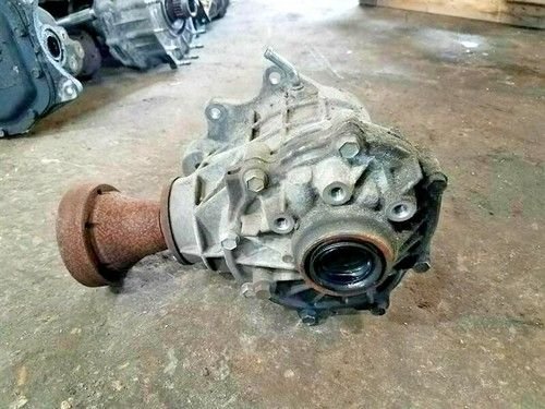

This clunk sound normal? Just usual driveline slop?
I rocked car forward/reverse and could hear sound from t-case
so, I pulled driveshaft. And this seems louder then normal
i get good “clunk” sound when I turn into driveway,

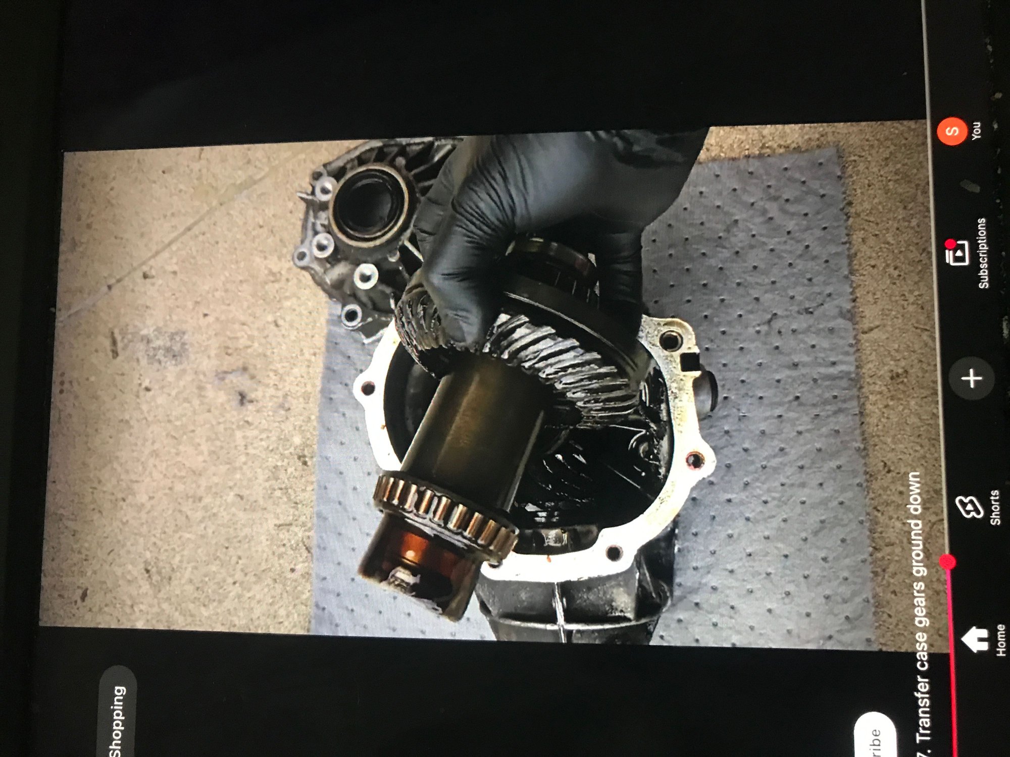

The transfer case on awd 2002-2003 era vues has a ring/pinion. It has no chain. I do not know what they did in 2004 on. This is pic found online that shows bad ring/pinion.
with vue in park. I push it rearward slightly and hear clunk from t-case. I than pull it forward and hear clunk. This is with driveshaft removed.

Posts: 3,296
Ring and pinion = hypoid gear set. Transverse engine and transmission needs a ring and pinion to send power to a rear differential. No chains needed.
I suspect you will find something similar in your transfer case.

IF it has no gear oil and makes noise, adding oil will not fix it. I have a used one but I really don’t want to replace it as a test. Due to work involved. I suppose I have no choice. IF I want to try and resolve issue.

Had to remove output flange to install t-case and i could feel 1/8” slop in/out on old one .
The new one had no slop.
Also with pinion nut removed.
Book say’s to torque pinion nut to 82 lbs.
16oz is spec i had 14oz oil
been a long time since I used 1-1/16” socket, 27mm socket?
and 17mm female hex on drain plug
1-7/16” axle nut.
