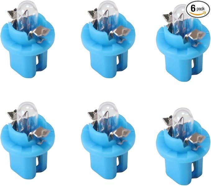

I would lean toward your cluster using these type bulbs. They are twist lock style, vs insert style.
Old Jun 14, 2025 | 08:45 AM
The ones with the plastic base and contacts are usually preceded by the letters PC in their name. PC194.
Most of them you can actually push out the old bulb from the original connector through a little hole at the base of the connector and then put in just the replacement bulb. You can do this, but it is a pain in the **** and you risk crushing the new bulbs when putting them into these holders / basis. I recommend wearing gloves to keep your finger oil off the glass of the bulbs. No, they are not halogen, but considering how long the bulbs from the factory tend to last, I have to believe they took every precaution to ensure a long lasting life.
