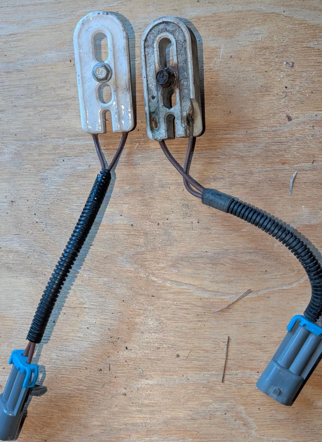

I ordered a new radiator fan resistor -- GM GENUINE 25820977 -- available at Rockauto.com and amazon.com for about $38 buck.
The resistance on the old unit was infinite, and the new unit was about 0.7 ohms. The voltage at the radiator fan connection with the new resistor was 14v on both high fan (fan 1) and low fan (fan 2) settings, so the resistor must significantly reduce the amperage going through it.
I would say that a very low voltage reading at the fan connector (I was getting 3.3V on the low fan setting) is a very good indication of a failing or failed radiator fan resistor.
Bottom line, the radiator fan now comes on when the AC is engaged. The result of this fix is cold air blows through the vent at idle.
I can't say how many resistors go bad, and it is only on the 2.2L FWD Vue, not the 6-cyl (I did not check other models, but the fan resistor is likely only used on single fan cooling systems), but mine was totally shot. Access to the resistor is easiest by removing the driver headlight, per the video posted earlier..
I will update if any new info comes to light, but for now the radiator fan is operating properly.
Tom Werner
New Resistor on the Left. Old resistor on the right.
