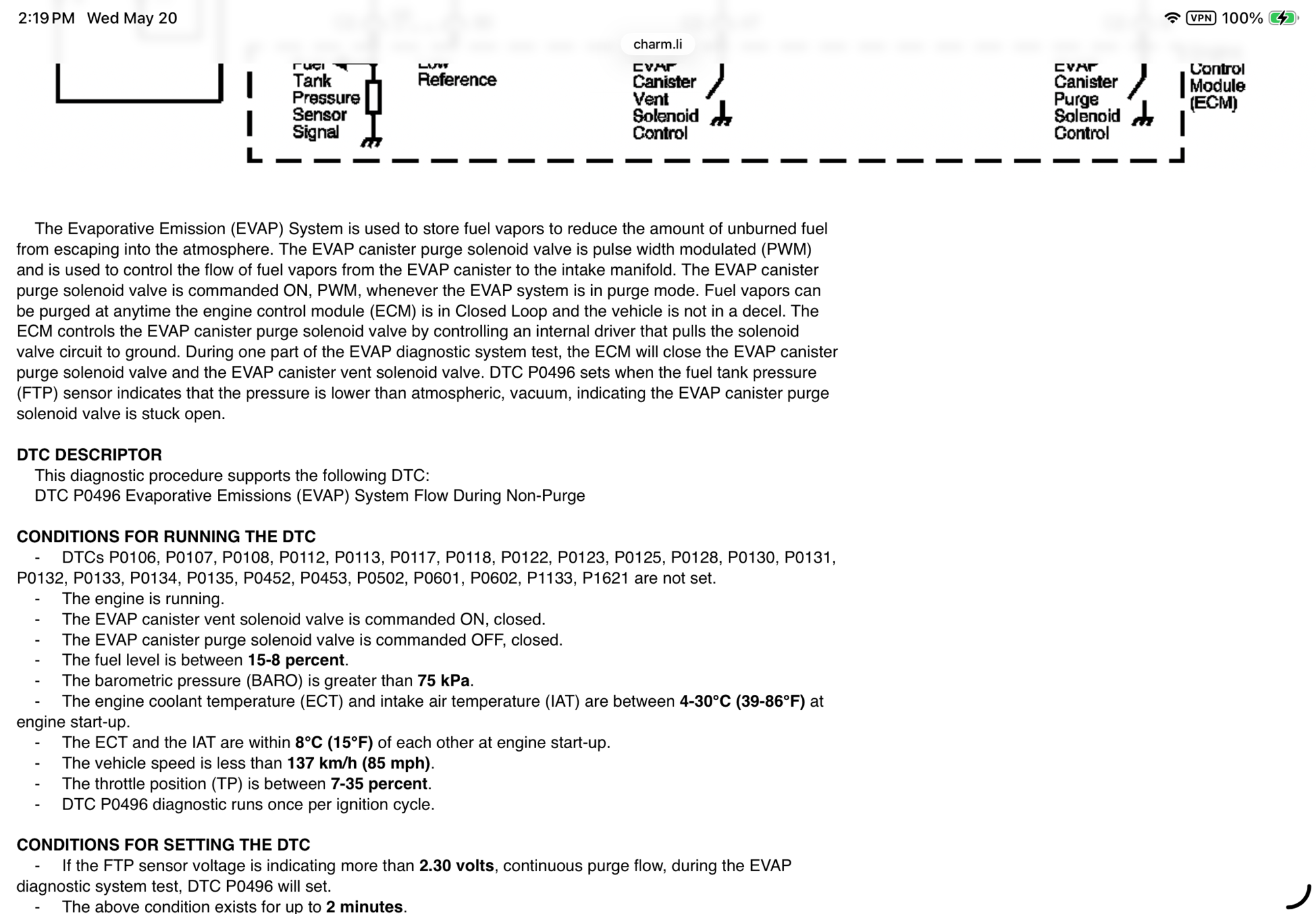

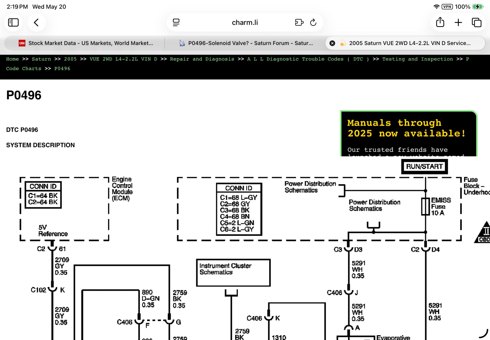

The only thing I can think is that maybe it is an issue with the vent/solenoid valve (not the purge valve, the one that connects to the charcoal canister) ? Or possibly the fuel pressure sensor? Anyone have any thoughts? I would love to get this fixed before my inspection runs out soon.
