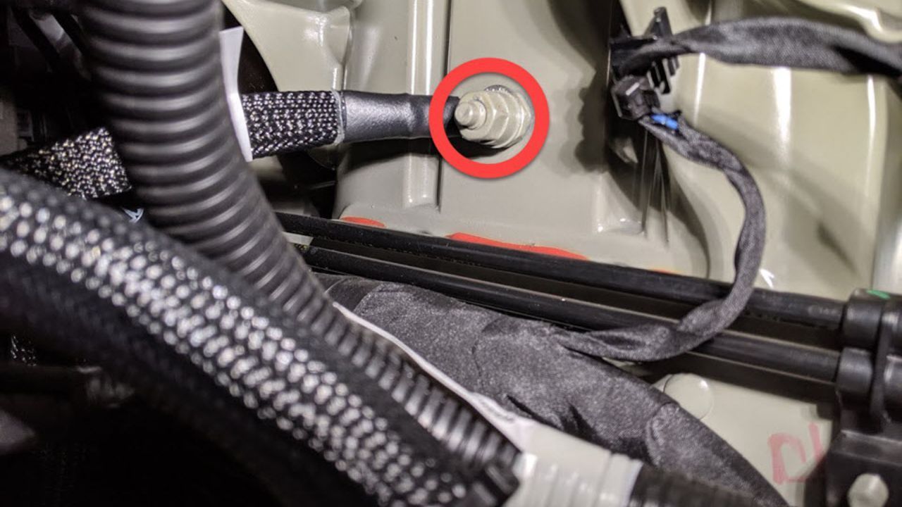

A 'ground' is just a wire connecting your battery circuit to a point on the car body or on the engine, and good grounding points means electricity can flow properly. Check G105, G107, G101, and G103. Your engine (and starter!) draws all it's battery energy through those four points, so if they are rusty and crusty you literally won't be able to send enough power to the starter to crank over the engine, because all the energy will be lost through those rusty crusty or non existent grounding points. This can be true even if your radio and lights still work!!! Bad grounds might still be able to power the radio, but not the starter. If they are rusty or broken you need to clean them up and maybe replace the wire.
A ground will look something like this, just a wire bolted onto the body or the engine block:
Anyway, just my GUESS, but the smoke you're seeing could be a grounding point is getting super hot because of a crappy connection. I would check those and the battery first. Once you can reliably start the engine, worry about the cam sensor code then (and save your receipt and your old sensor! It might actually be perfectly fine).
