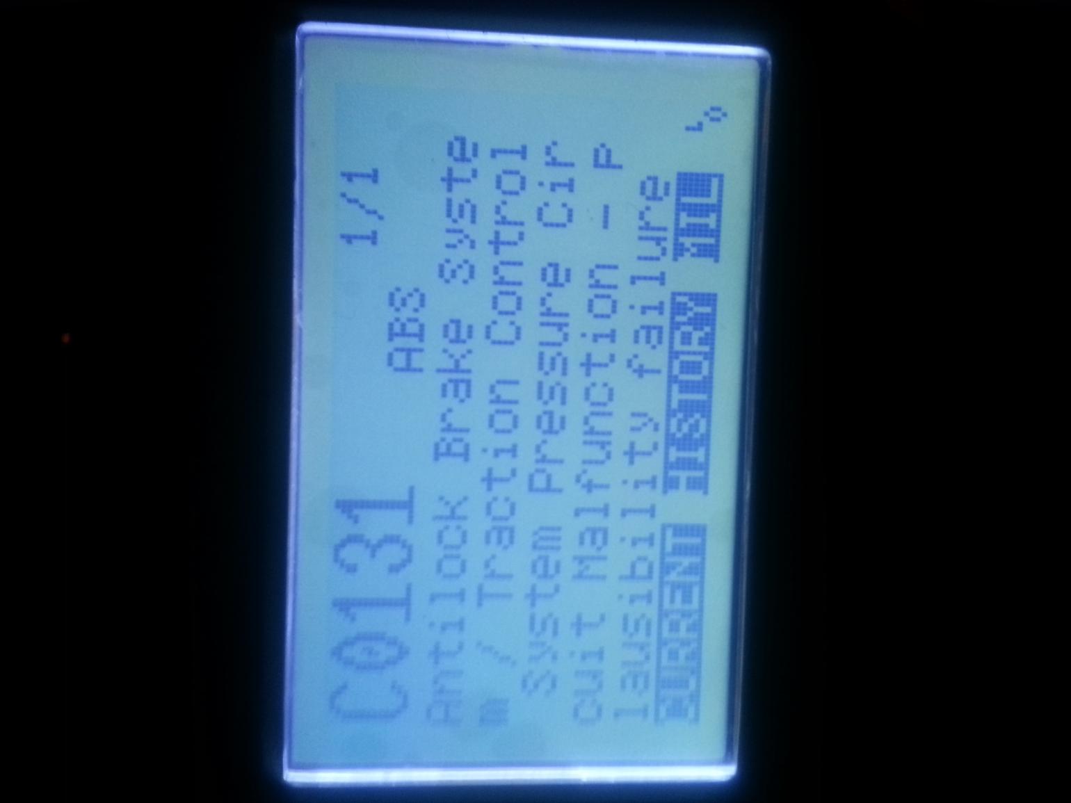

I want to drove it over a hill Rube! But here's a new update. I put in the new MC today. It works rather well. I didn't even have to bleed it to death. A simple bleed in 5 minutes made it rock hard and does not sink. So the rebuild was bad out the box. But unfortunately. .. The brake drag is there and get a hold of this.! I get the tracking and anti skid lights on and drew a code C0131. Heres the pic on the scanner. But one thing is for sure. I think the Master works so well that the drag has been amplified! On the test drive in about 10 minutes of driving the drag came back and it almost completely locked the brakes! I opened up the rear passenger bleeder (squirted out with pressure) and the car rolled home again. It did the drag right before home and I opened up the rear driver bleeder and it also squirted out fluid. So its pointing away from being a sole caliper. What does that mean on the scanner? Abs unit or something outside the unit? Halp! Ive had it.lolololol

Does the ABS system have a fuse? If so, pull that sum beech and see if the problem goes away. You don't need the ABS in order to have brakes.

Posts: 38
rube.. The car drove me nuts. traded it in. it did have a faulty abs module due to my local mechanics diagnosis. cost to repair it was 1400 $. I can't spend more on it. The brand is gone and putting more into it is a bad investment. stealer only have me 4000 for it. lol. Thxs rube for the help. Take care and Maui the force be with you. lol
