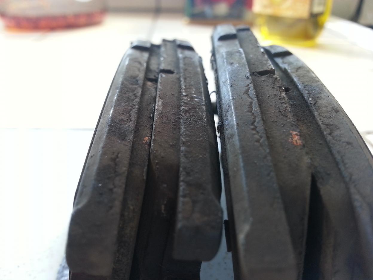

Ok. Problem solved. After removing like I said 2 days ago, the Brake hose for inspection, it seemed to have done the trick. So yeah rube, original hose and never been touched. Must have formed some crispy film just enough to cause a leak. But I did the rear brakes yesterday. I did the fronts like 3 months ago. But anyways, here are the pads. Notice the thinner one? That's the culprit. P.s. rear. The caliper pin grease btw, was some what dry. Definitely dry enough to be concerned. So I think my diagnosis of a slight booster hose vacuum leak and some what dry caliper pins was the problem. Wouldyou guys agree? I'll be hanging around here.

I can't wrap my head around that vacuum leak, but who knows? As far as the caliper pins go, yes, they do need to be properly lubricated in order to work the way they're supposed to. And sticking around here is a good idea. A lot of these guys know the Saturns very well and can help you out when you have a problem. I'm just a 56 year old novice. I keep my own cars going and have for over 40 years, but I don't claim to be a mechanic or know that much.
