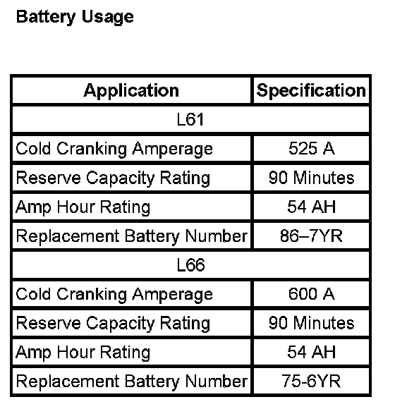

Are you sure your battery is not on it's way out? 12.4 volts is low.
ctavers Apr 19, 2024 09:43 AM
No I'm not sure if battery is on way out, Battery is a 48 month battery that has been in service for 2yrs. After your question I removed battery, charged battery and using a carbon pile load tested to 300amps. Voltage under load is 10.5v.
grcauto8453 Apr 19, 2024 10:01 AM
You should hold that at above 500 amps if fully charged.
Home >> Saturn Truck >> 2004 >> VUE AWD V6-3.5L VIN 4 >> Repair and Diagnosis >> Starting and Charging >> Battery >> Specifications
Battery: Specifications
https://charm.li/images/DM13Q313/gm50/1118487026/

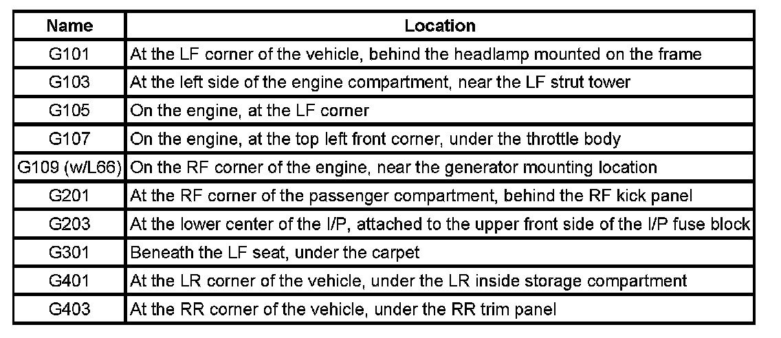

Does anyone know where the cab ground straps are located? beside the 2 going to fender and starter. when key on no dash lights come on. if i actuate the drivers electric seat adjustment all comes to life. is there a hidden main cab power relay or grounds hidden under dash or seats?
grcauto8453 Apr 25, 2024 09:55 AM
You can c lick in the breadcrumbs and get the entire manual for that vehicle.
Here's the grounds list.
Home >> Saturn Truck >> 2004 >> VUE AWD V6-3.5L VIN 4 >> Repair and Diagnosis >> Diagrams >> Grounds >> Master Ground List
Master Ground List
G101 - G403:
https://charm.li/images/DM13Q313/gm50/1597045438/
