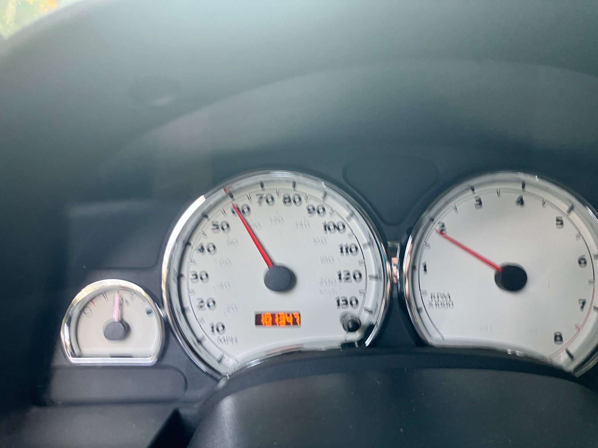

Just for the heck of it
4th gear XFE trans

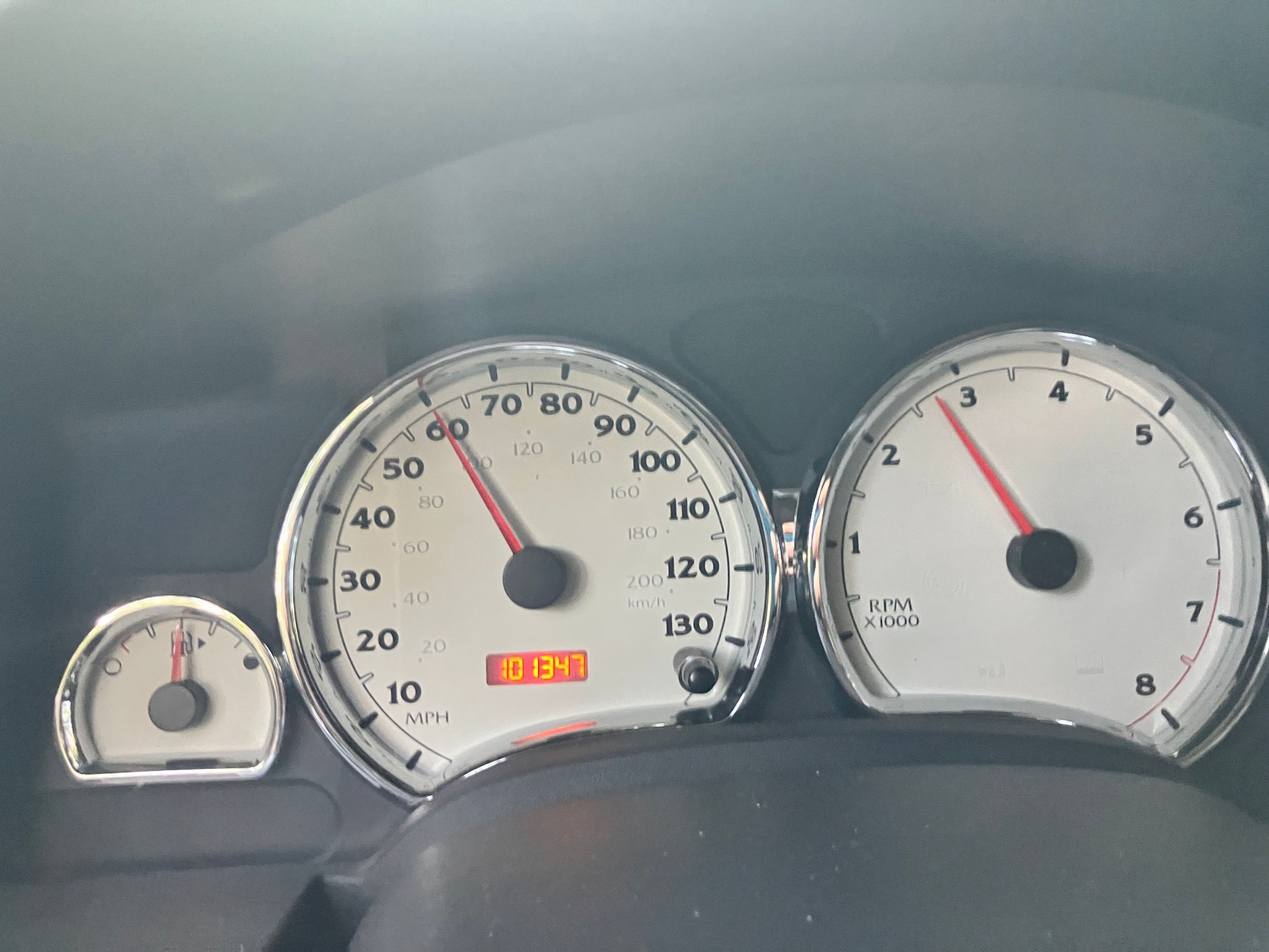

5th gear
5th gear XFE trans
