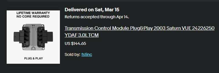

I am now in the middle of replacing grounds and have replaced the ground from the splice pack at the right end of the dash chassis and ran an 8G wire directly to the battery. It's only 8G as it's what I have lying around to use. I will reach out to the company who gave me the "PCM" to replace it - Before I do, I have found a module bolted to the rear of the engine (driver's side of the engine bay above the bellhousing). What is this module? It is physically bolted to the block/bell and has a few grounds attached to it.
I replaced the module that was just behind the battery/fuse box on top of the engine bay in clear open view in a plastic "brackoot". (sorry, I've lost all sanity) I was under the impression that this was the PCM? Engine Control Module? This is where the injector enable message goes to.

I will grab a picture later on - There are 2 modules in the engine bay - I have a photo of the one I replaced, thinking this was the actual PCM that's controlling the injector enable functions.
At the time, my research called this the PCM as well and not just the TCM. this is mounted on the top of the engine bay just behind the fuse box facing the sky. I never noticed the module at the back of the motor.
If the module bolted to the valve cover is the actual PCM, that's my next attack point for grounds and such.

Oh my goodness, I feel like an absolute idiot....
Though, I must say... It does shift better now....
Thats totally just the TCM. The PCM is bolted to the valve cover.
Im ready to concede...

Alright, update, I have now replaced the actual PCM. Programmed the OE BCM back as well without issue! Back to 61K miles... I went a few miles and have not had the stall issue happen yet. I am really hoping this gets it and I will report after about 3-4 days if this was successful.
