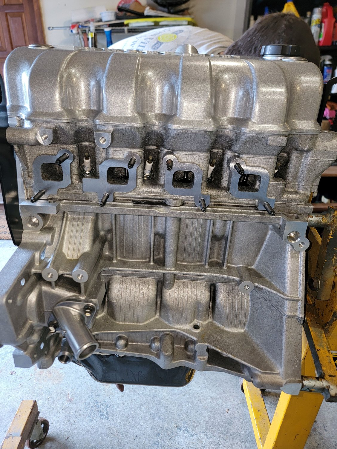

First, a picture of the crate engine would be helpful in identifying what you got and what it could be used in.

1999 crate engine that i have. Notice rounded square exhaust ports
2002 engine. Exhaust ports are "D" shaped and have a hole below each port for the air injector reactor pump.
Based on the factory sticker and labels on the crate, the part number for the crate engine was verified as being for 1999 year models. Based on Saturn parts website, that engine was only offered in 1999 models. I gave a dealership the number for the crate engine and they said yes that is the correct engine for your car. After the purchase, and noticing that the heads were different I did more searching and found that the part differed by one number in the last position between the 1999 engine and the 2000 and up version. I don't know why the dealer gave me incorrect information, but I made the purchase Based on the info I found and what they told me.

Both photos i attached are of the SOHC varietys which i am sure you are aware of. Just wanted to make that clear for others.
