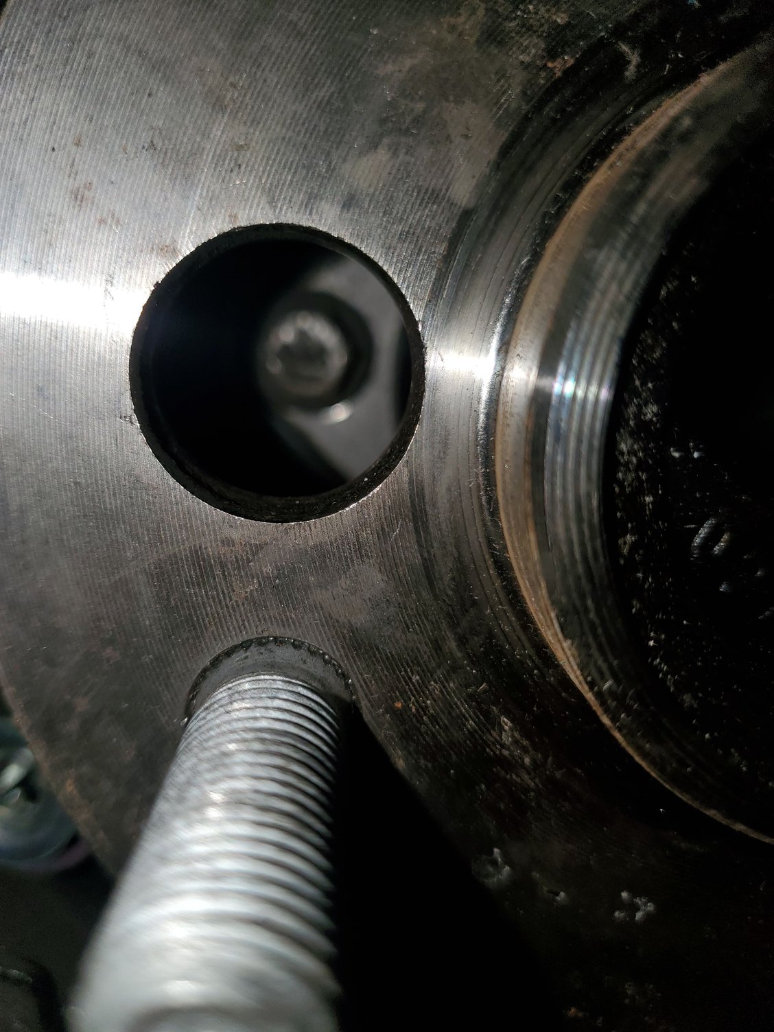

Sw-2 1995 - what is this bolt called and what do I torque it to (rear hub assembly)
Old Aug 29, 2024 | 02:44 PM
Gunnar's Avatar
Joined: Jul 2024
Posts: 60
Default Sw-2 1995 - what is this bolt called and what do I torque it to (rear hub assembly)
Old Aug 29, 2024 | 02:47 PM
Gunnar's Avatar
Joined: Jul 2024
Posts: 60
It seems to be 10mm , had noise after replacing hubs so was going to clean things up and put this to proper torque , but not sure where to find this information without knowing the nomenclature for these parts
Also do i need to loosen loosen and tighten them in criss cross order?
Old Aug 29, 2024 | 11:09 PM
Greg97SW2's Avatar
Joined: May 2024
Posts: 73
The Haynes manual lists the hub to knuckle bolt torque as 63 ft-lbs. I would tighten them easily in a couple of stages.
