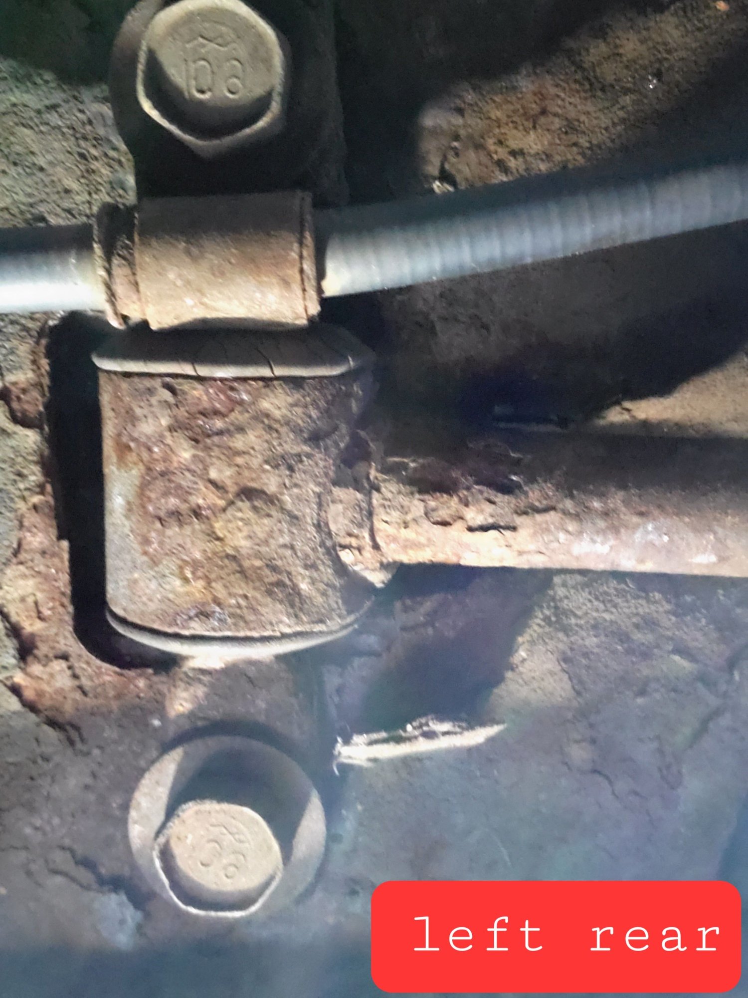

Old Aug 6, 2024 | 08:46 PM
Gunnar's Avatar
Joined: Jul 2024
Posts: 60
I am having trouble seeing where it is broken though in these pictures, can you see the issue?
Old Aug 6, 2024 | 09:00 PM
onlinebiker's Avatar
Posts: 58
From: SW Michigan
It looks like you may have a rotted out trailing arm mount on the passenger' s side. It appears there is a crack on the left of the inboard mounting bolt.... If those are rotted out - you have a parts car......
