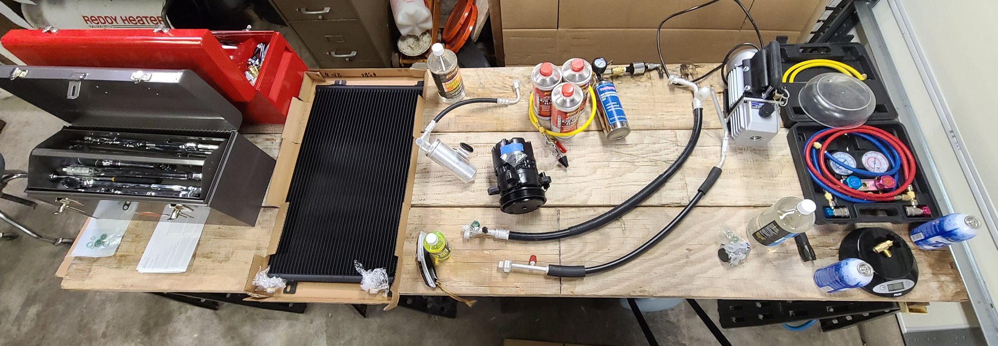

I have been planning this project for more than half a year. It begins tomorrow. The stage is set:
I have laid forth my action plan here. I shall no longer be a victim of the Kentucky summer heat.

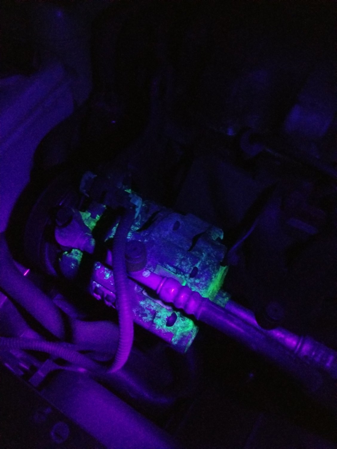

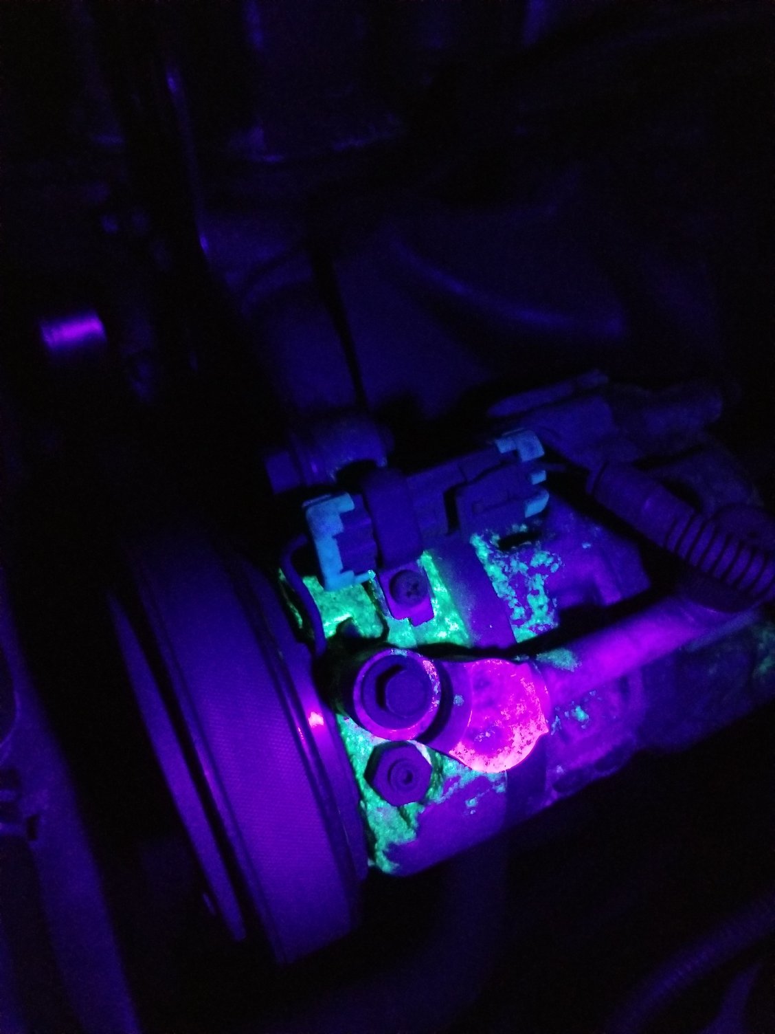

That's good advice, and the initial Leak check isn't mentioned because it has already been completed. the system was fully charged and functioned well for about 1 day.
The UV dye was found only at the compressor, and as I understand the gm compressors were also known to fail.
Of course, there is always a chance that the evaporator core leaks in a manner that I couldn't detect.

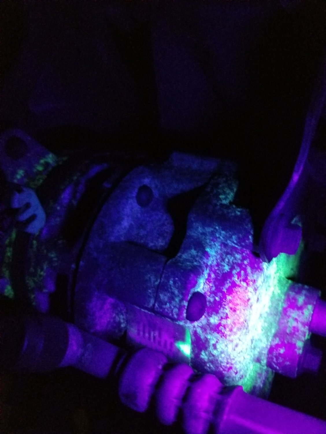

Those look like o ring failures (?)
What I don't understand is that If one line is the high side and the other line is the low suction side, how would they both be expelling refrigerant with dye to that extent? If the low side of the compressor is pulling a suction, should there be any positive pressure at that connection allowing or pushing refrigerant out past the o-ring? Or do I have my pressure differential physically backwards in my mind. (As in the pressure is zero at the compressor where the suction line attaches but is negative in the line, so the pressure differential from line to compressor is say -10 to 0 which is positive.....?? But then how does the low side Port read positive if this is the case? Or is that a vacuum pressure and I didn't look at the gauge carefully enough?

There are definitely some O-ring failures and additionally some internal compressor gasket failures (indicated by the leaks on the compressor itself located away from the hose connections). There actually are gasket rebuild kits for this model compressor, but they are quite complex and require special tools to disassemble... its just easier and less risk to replace it.
I suppose (assuming there are bad o-rings) that the reason the compressor would leak out of the suction side is that when the compressor clutch is not engaged, or is not active or when the car is not running, then the negative pressure on the low side returns to a positive pressure? Not exactly sure...

Seems like a reasonable explanation. The pressures do equalize between the high and low side when it is not actually compressing, so indeed there is nothing forcing it out. At the same time, If there is a leak at the o-ring, it will eventually seep.
