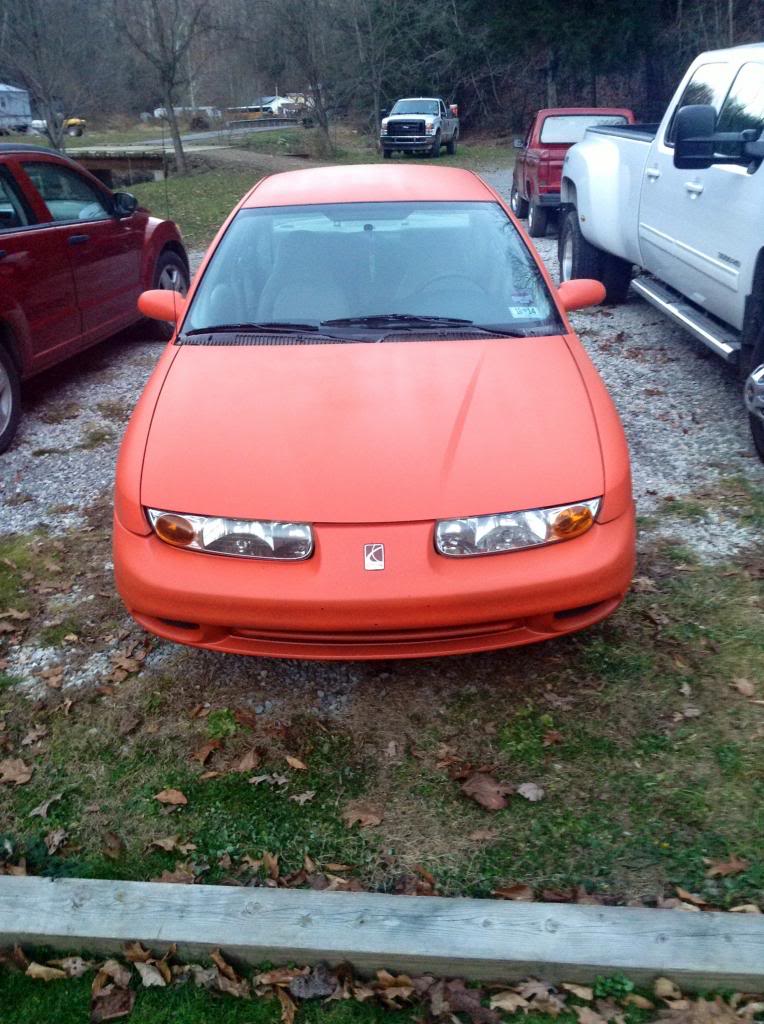

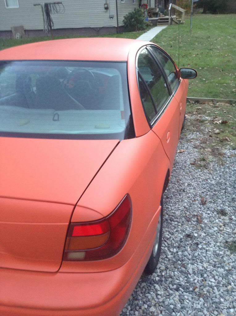

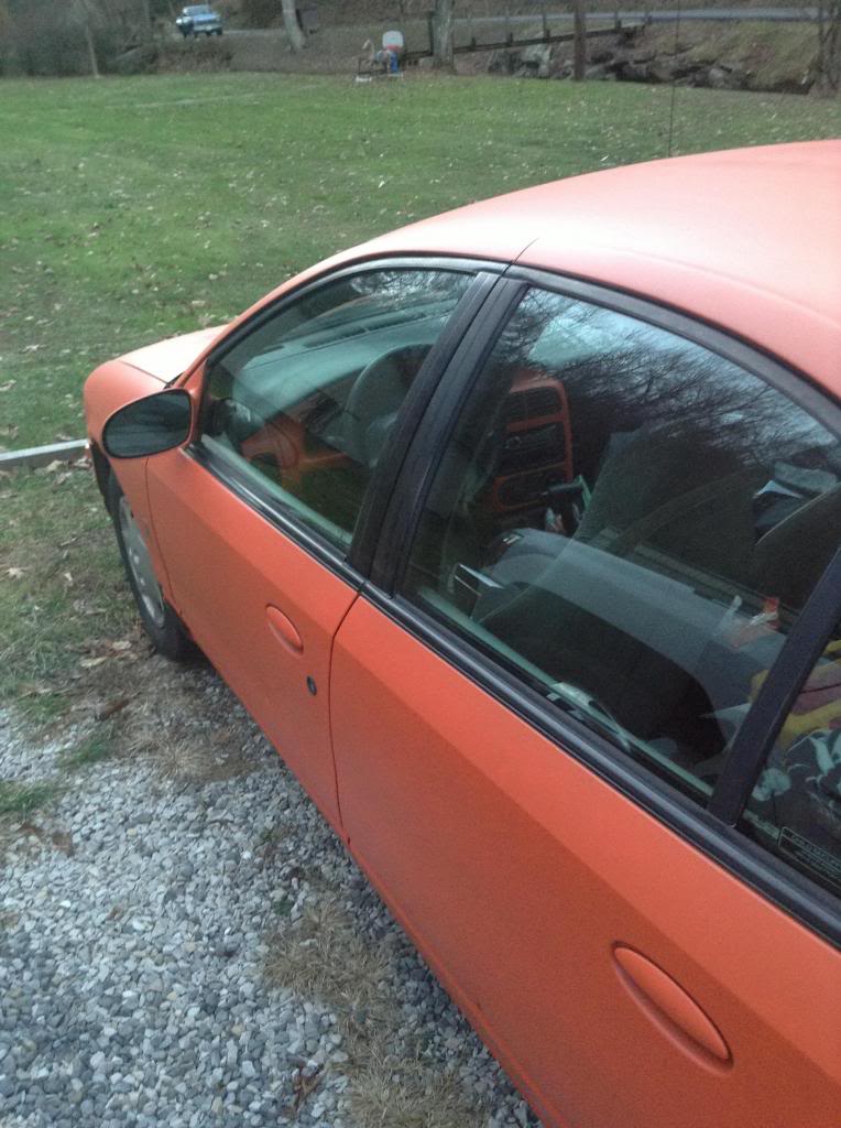

Actually the finish in those pics is from rattle cans... It wasnt as smooth as i wanted, nor was the coverage adequate IMO, so i dipped over what was there... Same color, even from cans, but i emptied into an HVLP gun and sprayed another coat on... Great, smooth finish and better coloring... I will post pics as soon as i get them uploaded...
Pics of the car, post touch-up... Done with a HVLP gun, 1.4mm tip... RDS(ready to spray dip) thinned down 15% with xylene... Same color as before...
As can be seen, with full coverage, the koi orange takes on an almost peach hue in certain lighting...

The pictures do not do this dip job any justice when it is clean, it looks awesome for my first ever full vehicle dip... If I were a total perfectionist, I could go over some areas with water and a piece of 2000 grit to eliminate the slight texture I have in places...You can see it in the hood pic if you look close enough... It's not 100% finished, as I plan on adding a red tinted gloss topcoat to the dip in an effort to swing the color more toward the red end of the spectrum, probably would get its perfect finish then... And you are totally correct, prep work is 99.9% of the work when painting/ dipping a car, with slightly less prep required for dip... Before the initial dip, I just went over the entire car with windex, and dipped away... My texture issue was from spray technique/ error...
