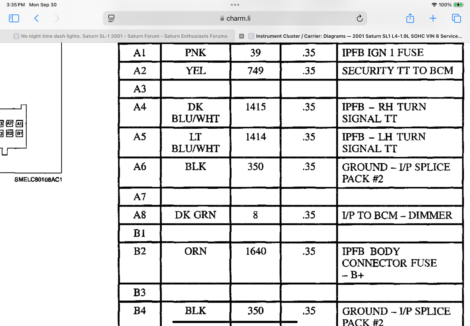

Your Body Control Module controls the instrument panel lights. The dash dimmer switch tells the BCM what you desire. The dash dimmer is a weak point on the L series cars. I suspect that the gen 3 S car uses a similar switch.
Old Sep 30, 2024 | 05:43 PM
Here is the narrative about how the BCM controls display dimming.
Charm.il is the free online diagnostic manuals, I have them book marked for easy access.
