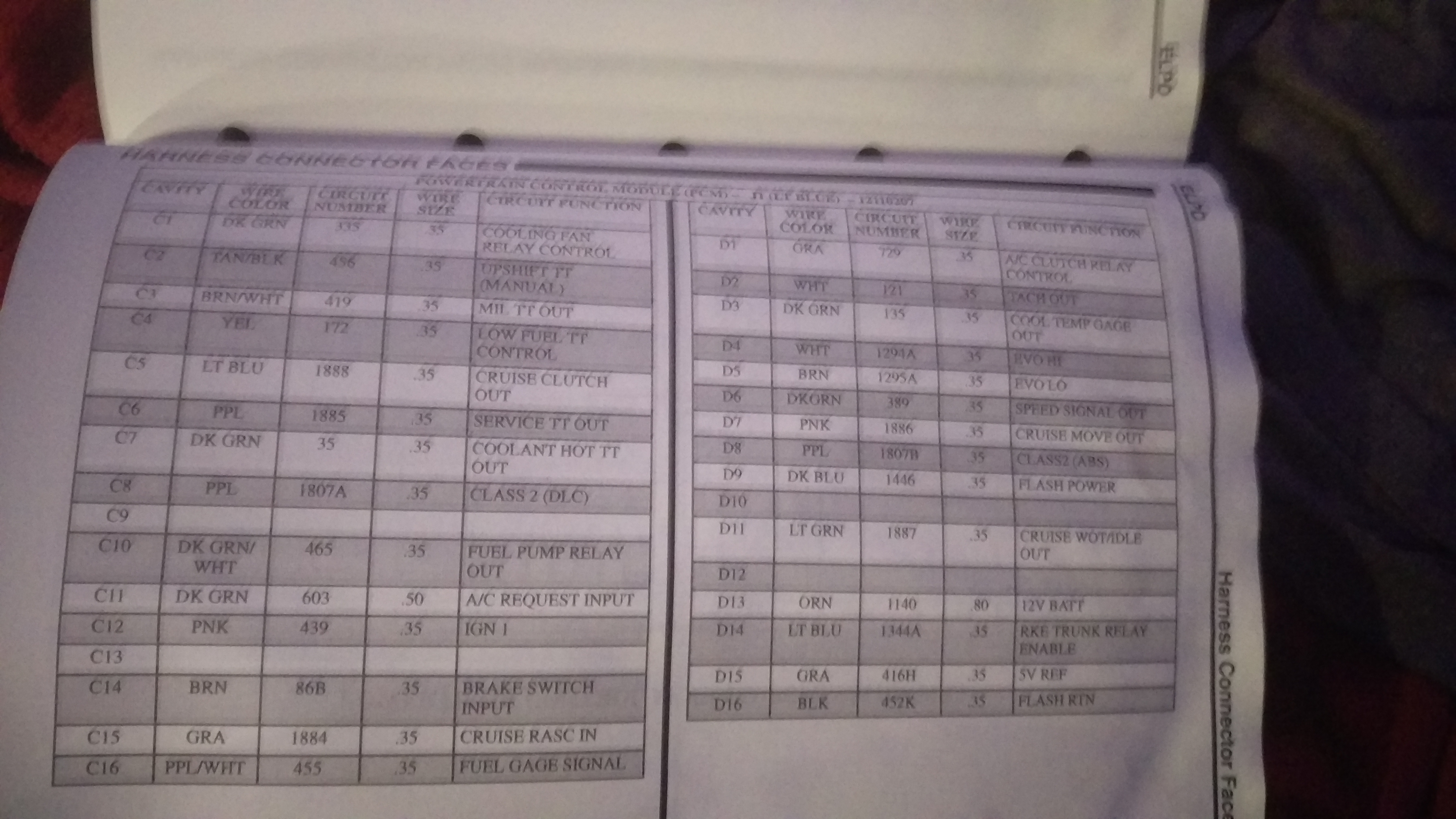

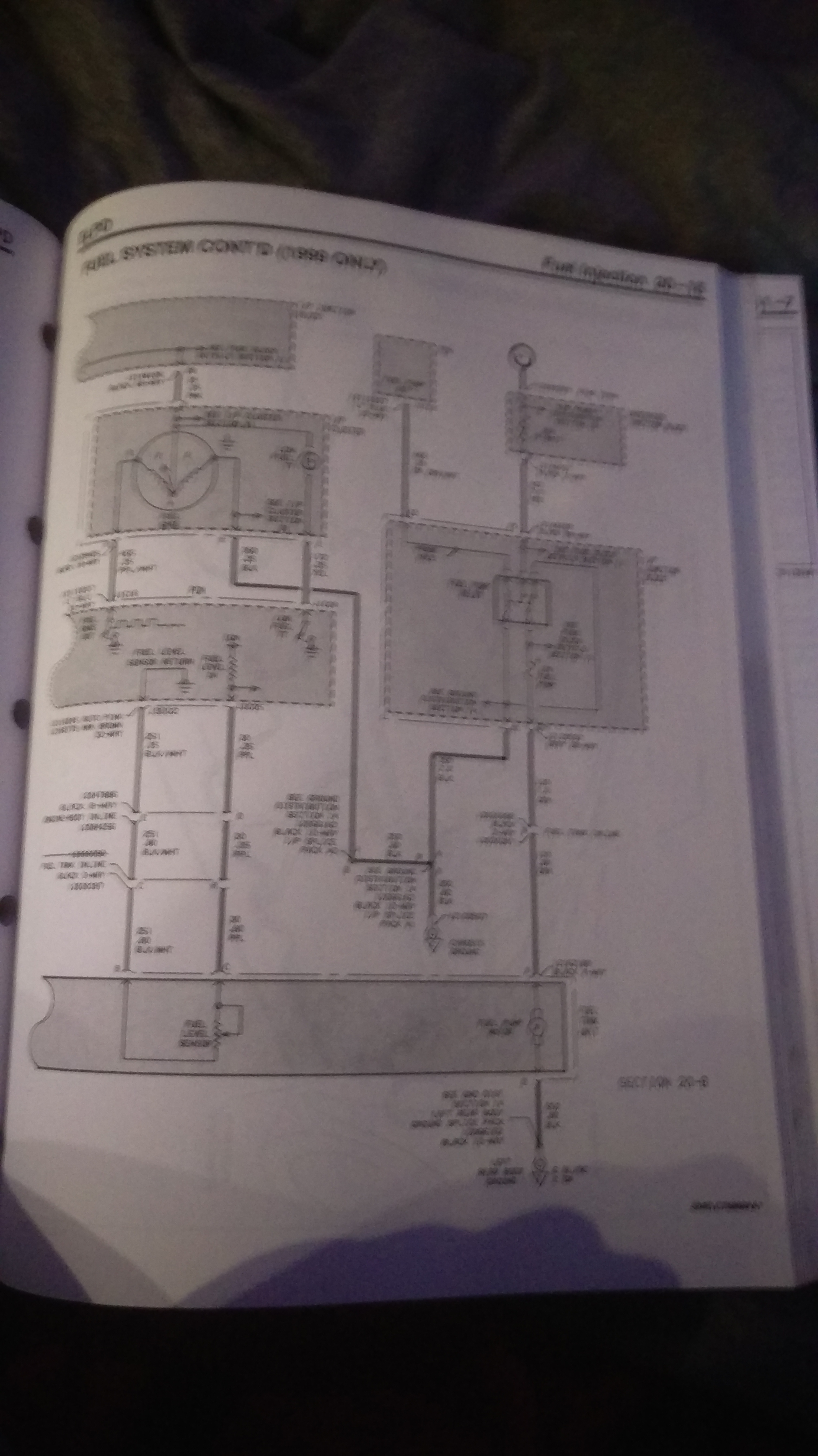

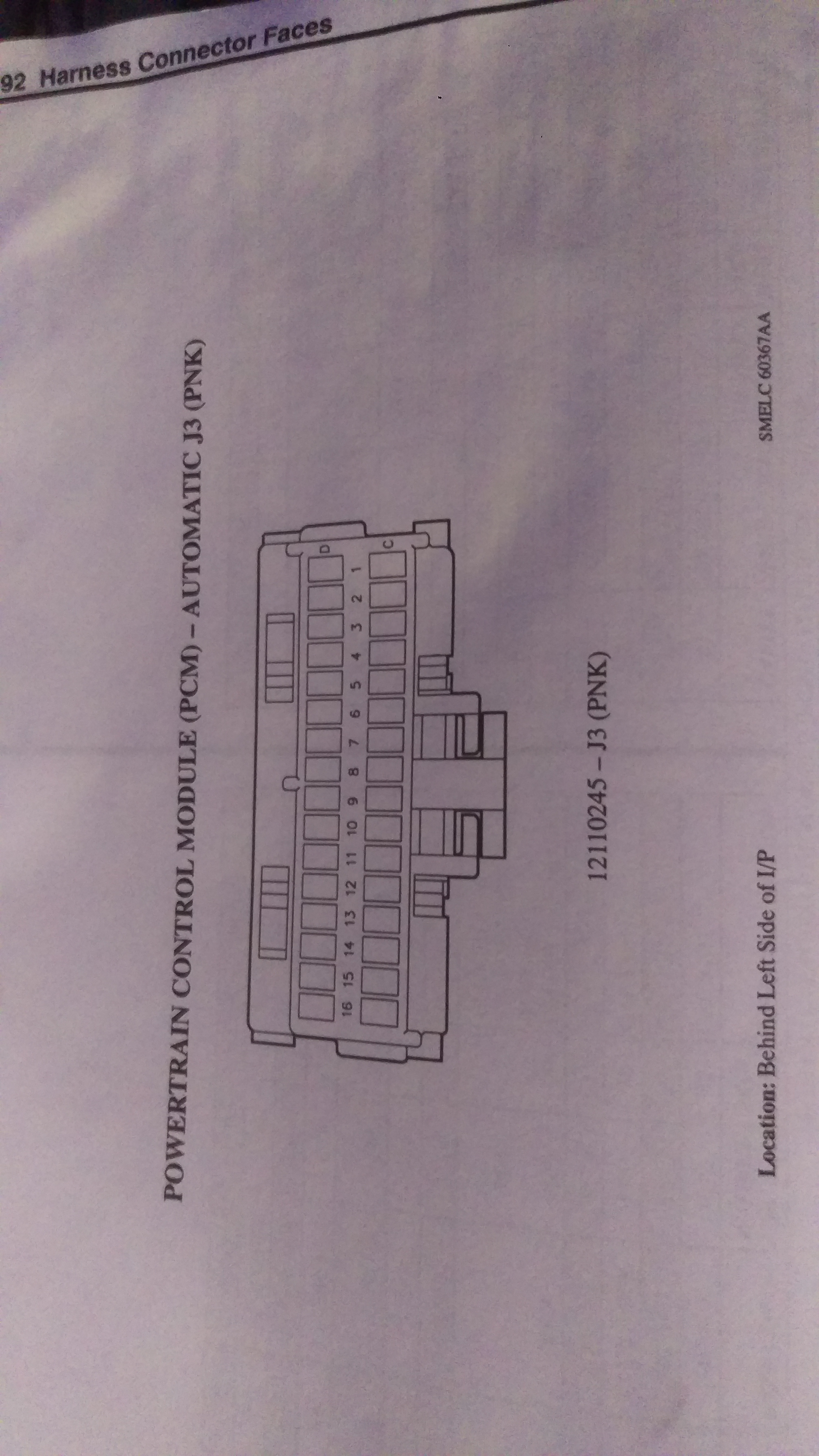

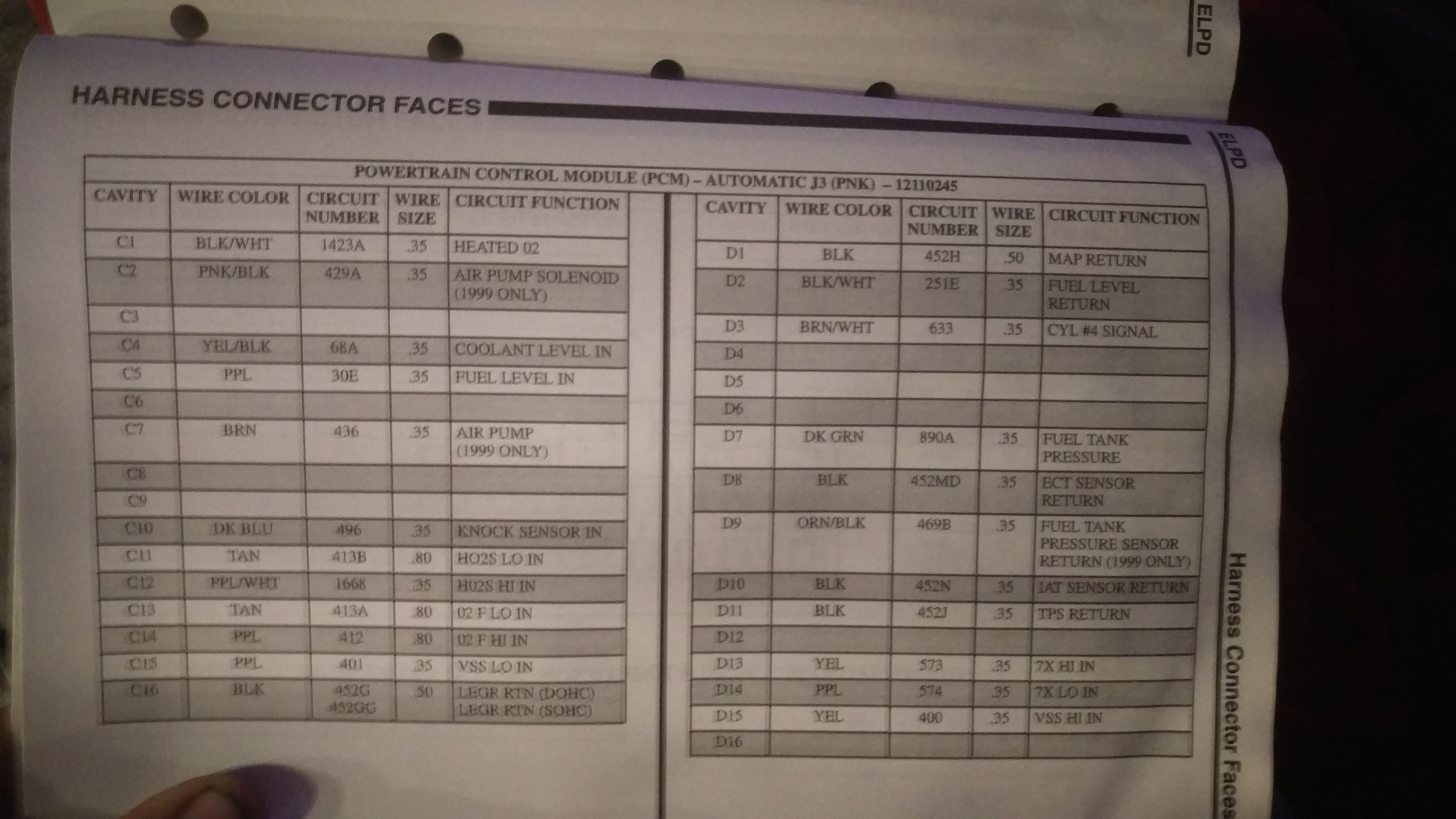

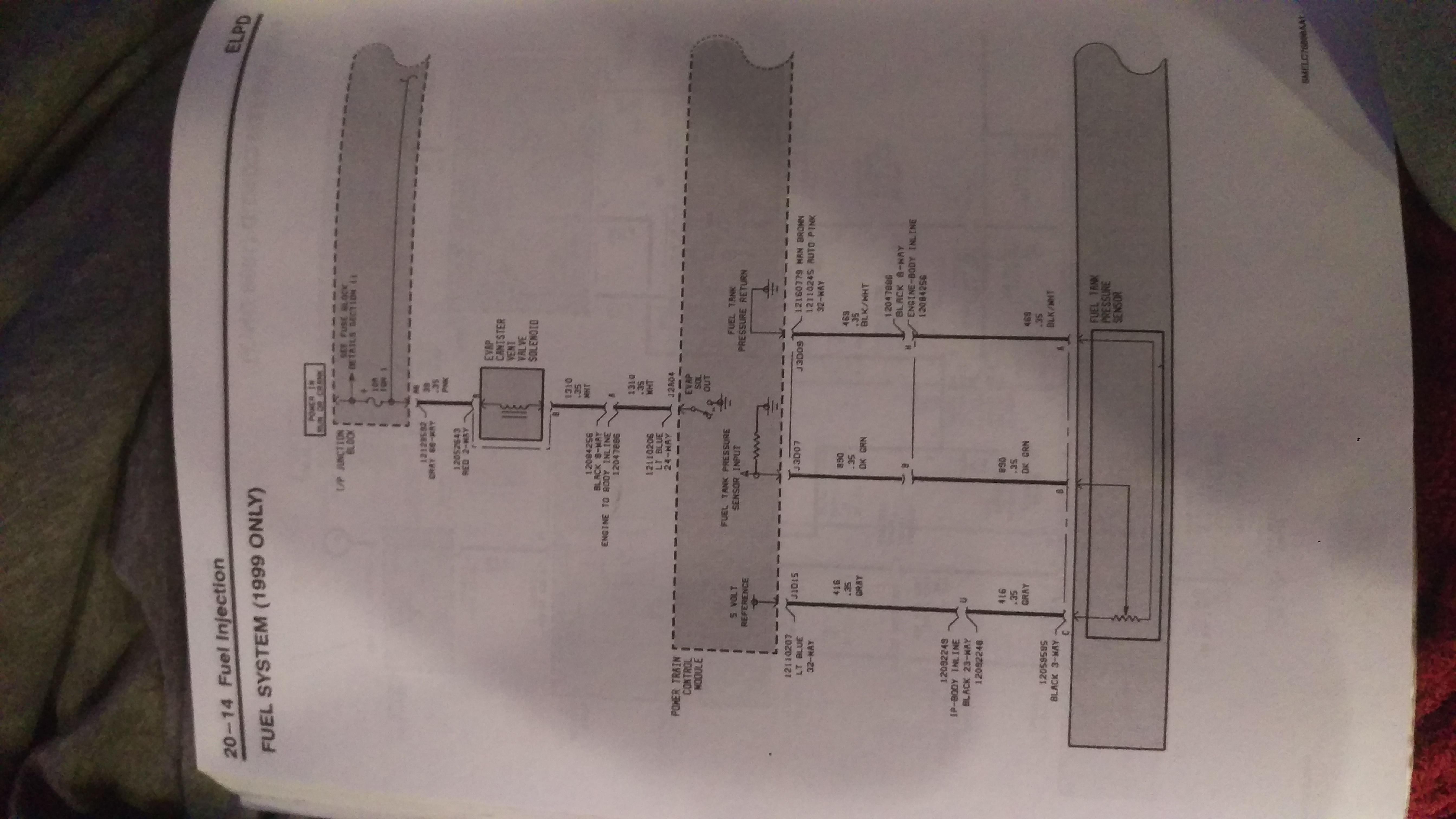

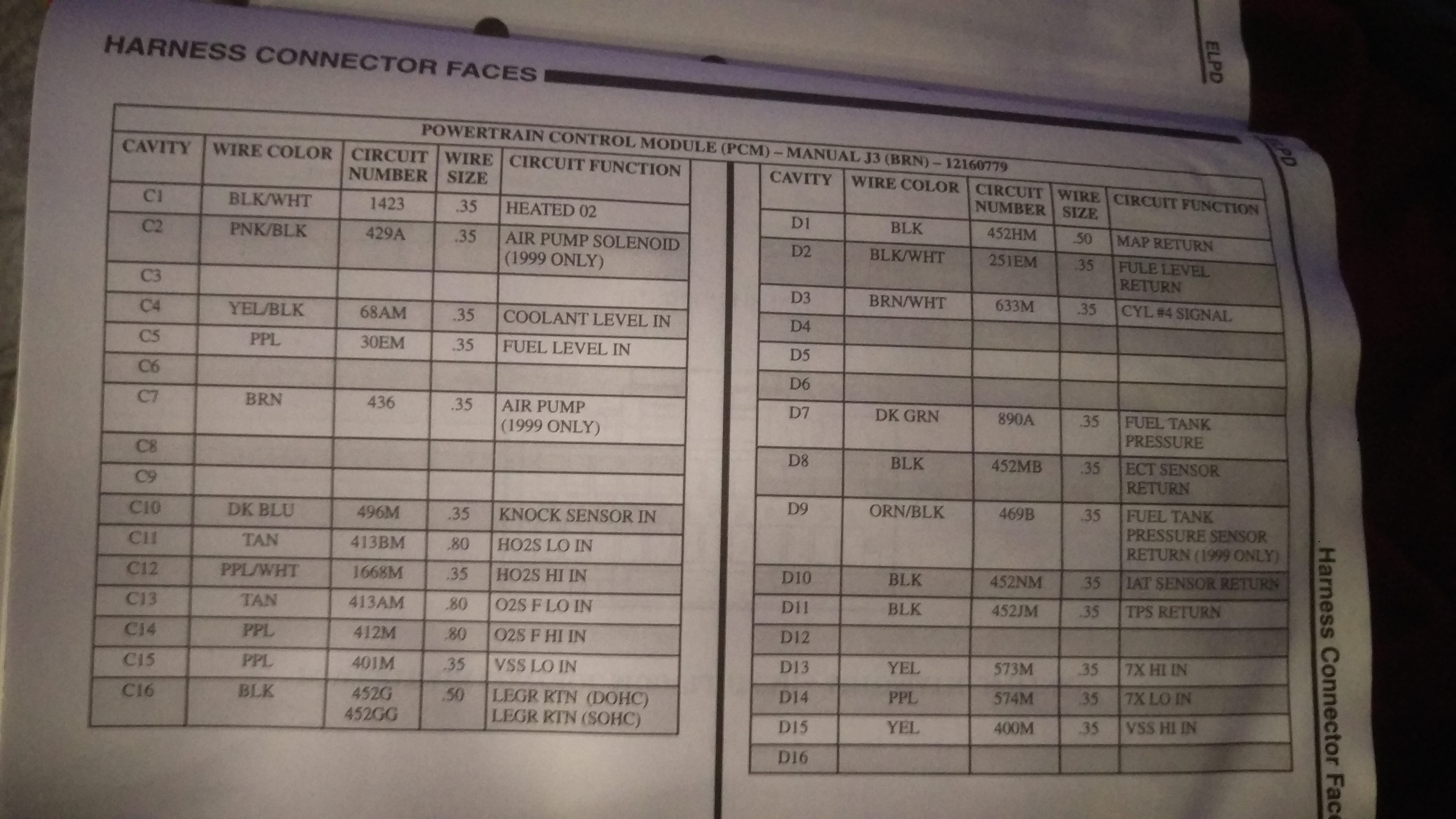

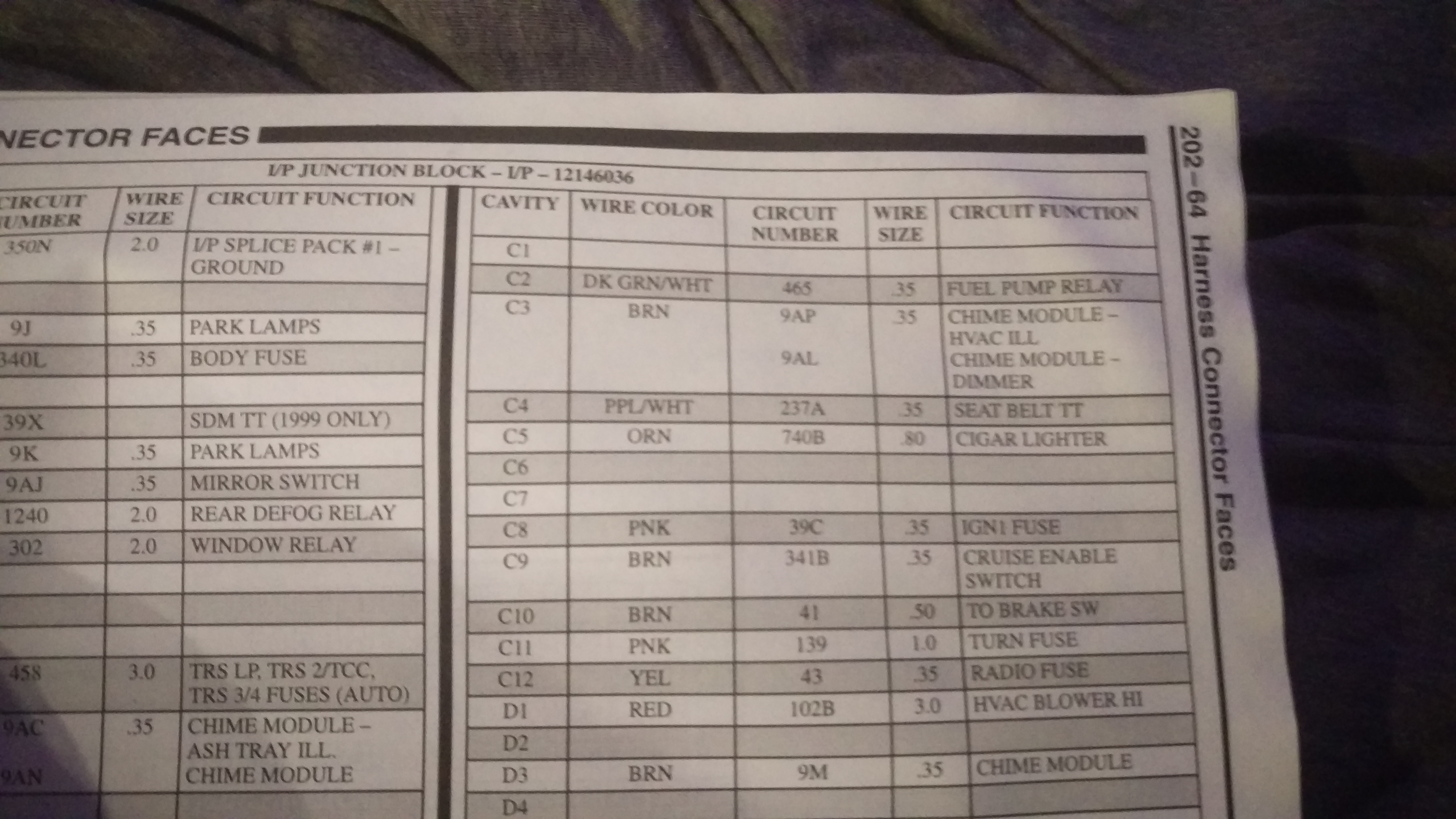

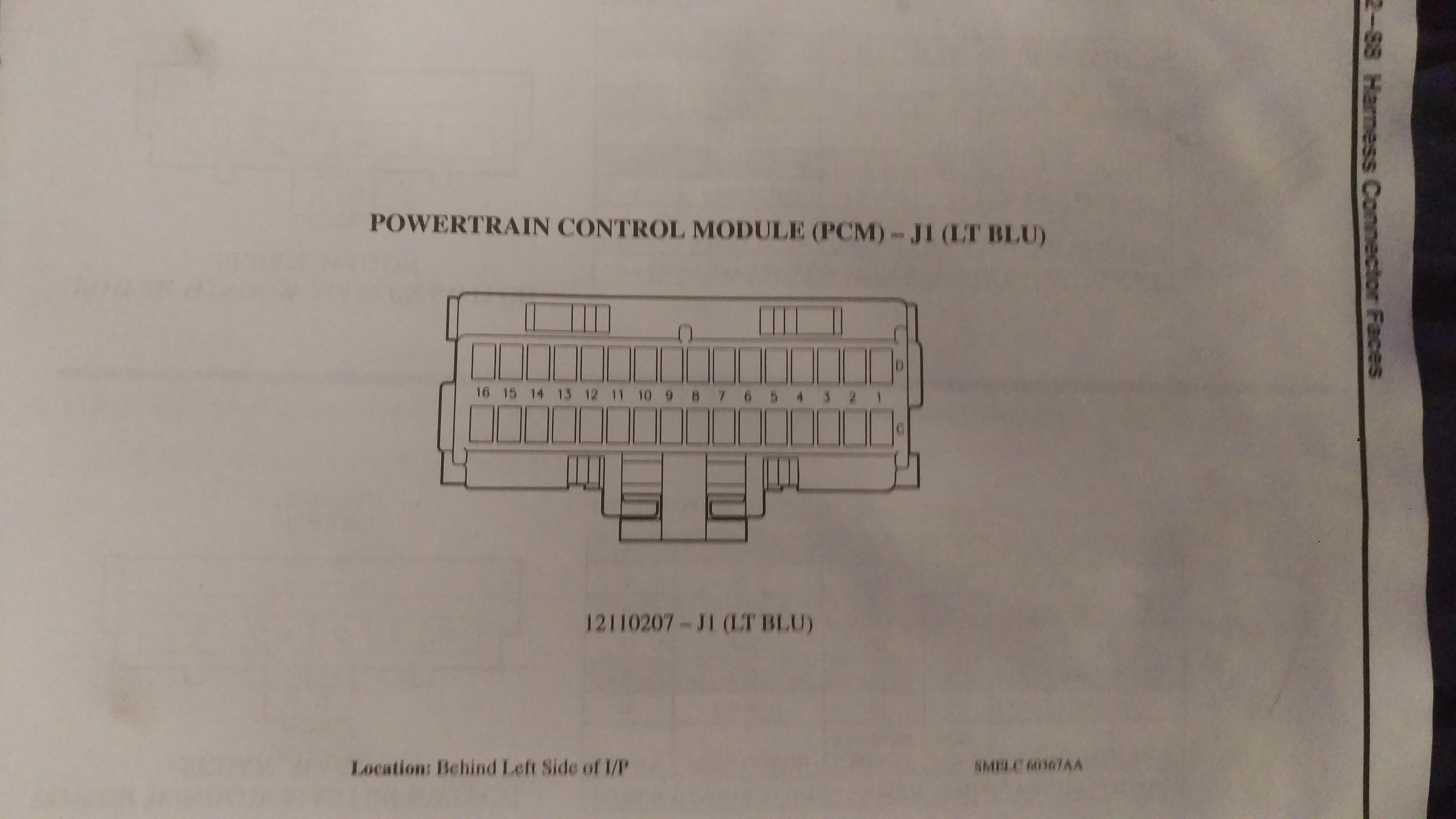

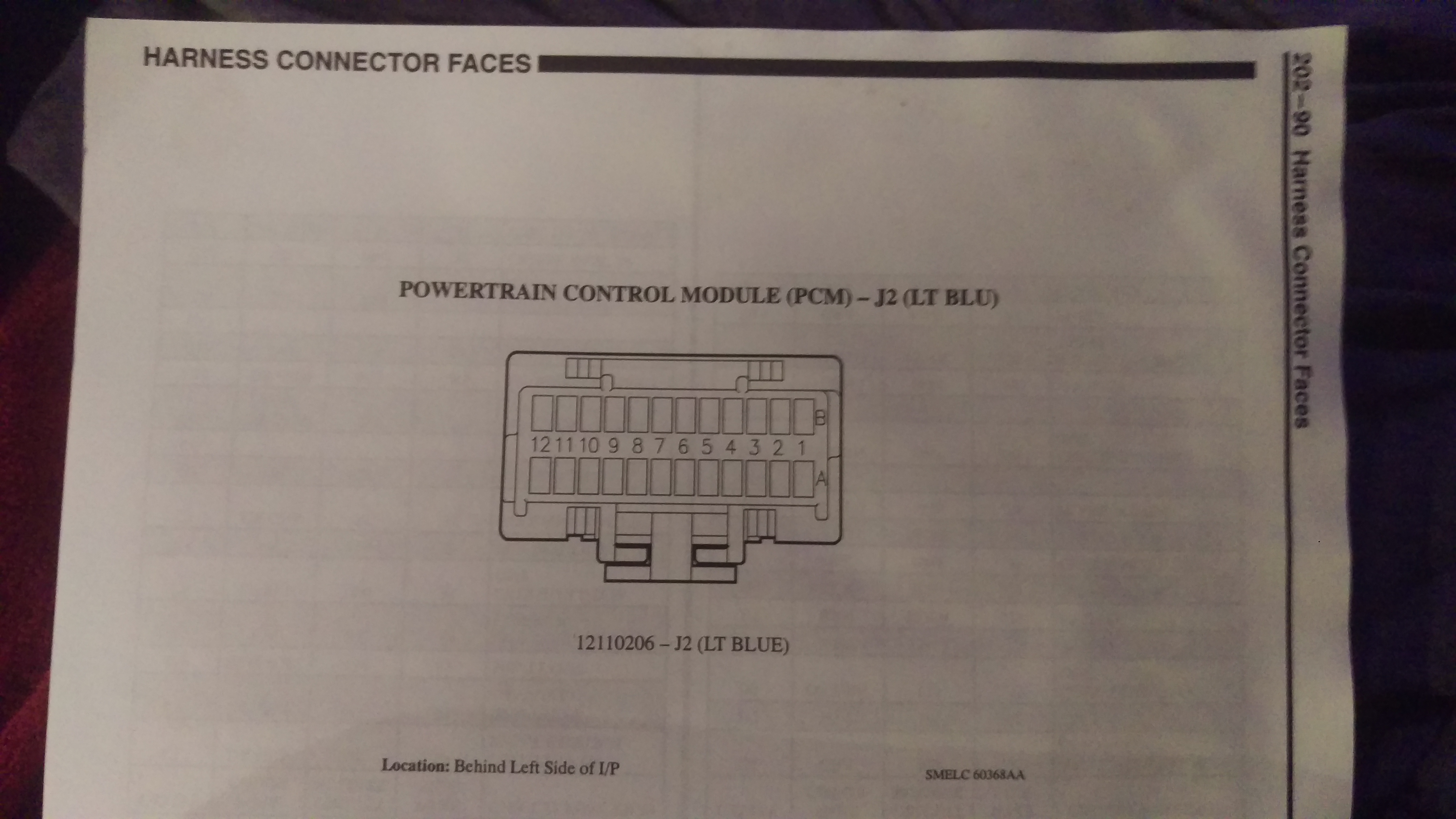

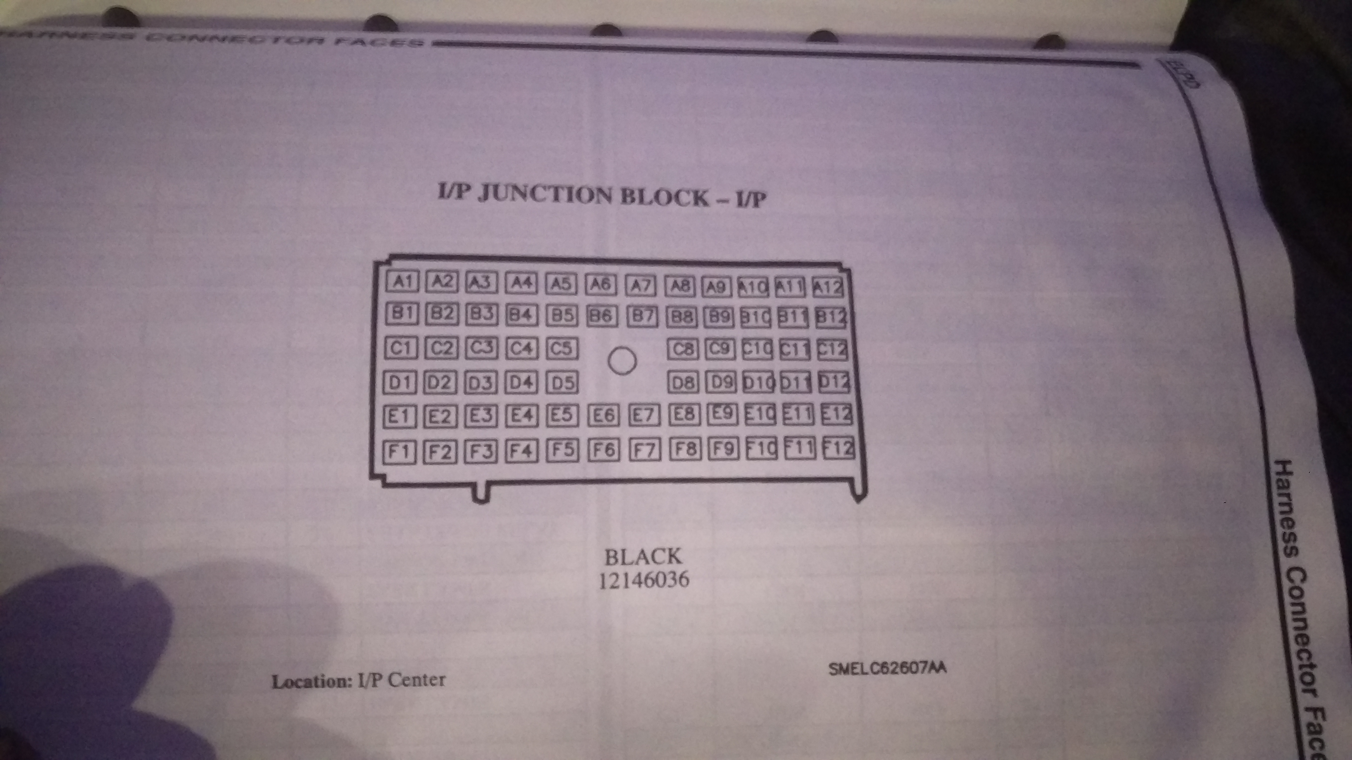

Going thru the book of knowledge. Hopefully (because scanner won't connect to anything) my phone camera will make these readable. If not I'm sorry about potato cam
Attached Thumbnails Intermittent no power to fuel pump and gauge reads empty-imag0573.jpg   Intermittent no power to fuel pump and gauge reads empty-imag0574.jpg   Intermittent no power to fuel pump and gauge reads empty-imag0575.jpg   Intermittent no power to fuel pump and gauge reads empty-imag0576.jpg   Intermittent no power to fuel pump and gauge reads empty-imag0577.jpg

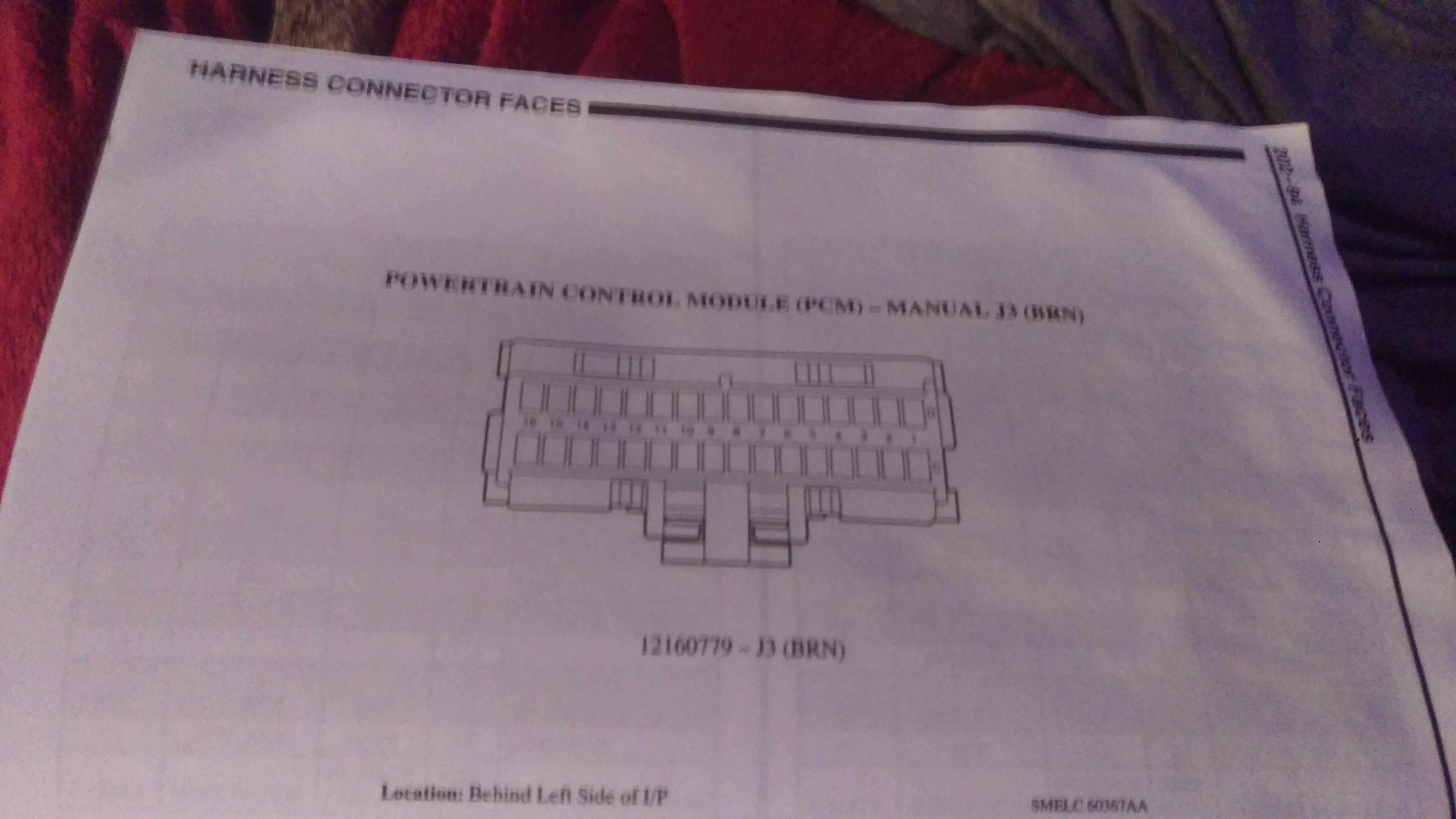

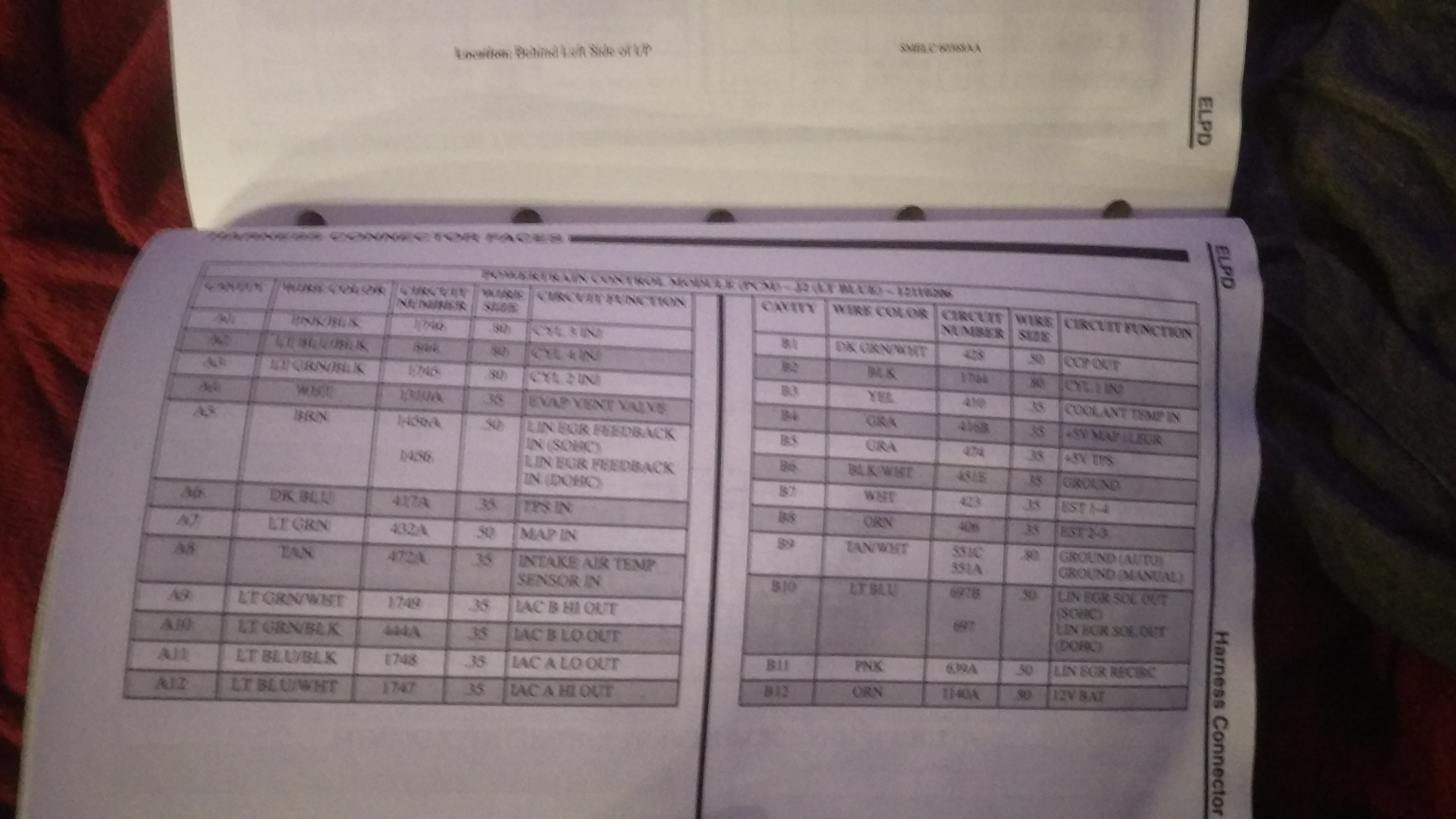

Please tell me if you need more information as I have most of the rest of the set, especially for the 99 cars. Now if the puppy will stop trying to absorb the book.
Attached Thumbnails Intermittent no power to fuel pump and gauge reads empty-imag0580.jpg   Intermittent no power to fuel pump and gauge reads empty-imag0581.jpg   Intermittent no power to fuel pump and gauge reads empty-imag0582.jpg   Intermittent no power to fuel pump and gauge reads empty-imag0583.jpg   Intermittent no power to fuel pump and gauge reads empty-imag0586.jpg
Intermittent no power to fuel pump and gauge reads empty-imag0588.jpg   Intermittent no power to fuel pump and gauge reads empty-imag0590.jpg

I did however manage to test the correct wire from PCM during normal operation and when its acting up. During normal operation I get 12v power for the 2 seconds before startup, and 14v running. When its acting up I get no power at the PCM connection. That was at 4am this morning before work in 25 degrees and ice.
Now I get to figure out why its not signaling as it should.

It's starting to sound more and more like something wrong inside the pcm. Maybe a solder point gone bad or something. If it's not showing up at the pcm that's gotta be it. I don't remember if pcms going bad was common. But the sucky thing here is you will need a 99 m/y pcm because of the secondary air injection unless it's a very early 99. Otherwise it will throw the service wrench. Single cam right? Hopefully someone will tell me I'm wrong , but when I needed to swap out the auto pcm for a manual one I found one I needed on eBay for under $100. Quick way to tell if yours has air injection is you'll find a little pump behind the pass headlamp, with a tube running to a check valve ontop of the a/c comp, and from there a tube to the header. You'll have the coffee can pee-cat too

I think we may be complicating this a bit too much.
If he fuel pump relay "trigger" coil INTERMITTENTLY grounds itself (shorts), it will lead to no voltage at the PCM when measured relative to ground because there is no resistance across which to develop a potential (V) irrespective of what the PCM wants that output voltage to be at that pin of the PCM.
If he fuel pump relay "trigger" coil INTERMITTENTLY goes open circuit, you would still see 12V at the PCM relative to ground, as the PCM is ready to supply current at this voltage, but when the coil opens up, that current path disappears, but that does not affect the potential V at the PCM.
So, after reading and re reading the posts in this thread, if you re 110% positive there is NO issue with the IP BATT feed on either end, then I will propose the theory that the coil inside the fuel pump relay is intermittently grounding out, thus opening the relay and killing the fuel pump.
