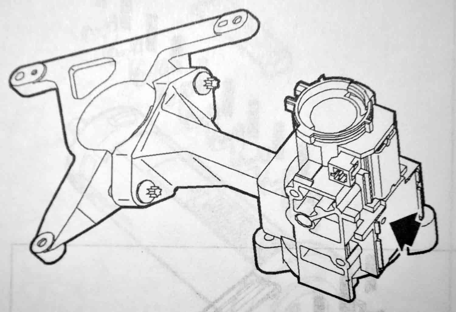

Best I can describe it is with the clamshell off the steering column, it is the side opposite the steering column, the side that is facing the passenger side door. The 2" square plate would be at the floor/dashboard corner with the tiny slot in the top back corner of that square.
Now I'm not sure this will work for you. I was looking in the 00-02 FSM. When I looked in the Haynes manual that is supposed to cover all Saturn S series, it looks different. Try pressing that thing on the top that you pressed to get the cylinder out and see if that makes a difference. It looks like it should just go to the ACC position without any trouble so I hope nothing broke on you.
Edit: from looking at the picture again, it appears that I have the orientation wrong in my description, hope this helps.

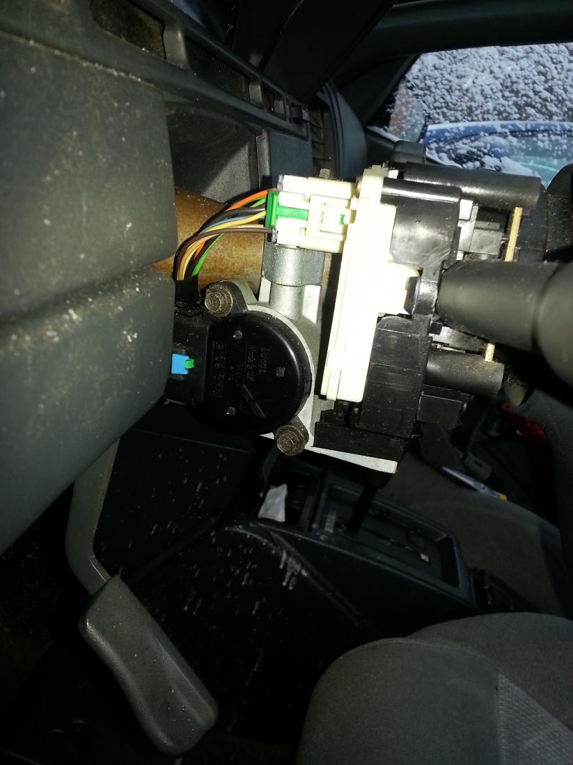

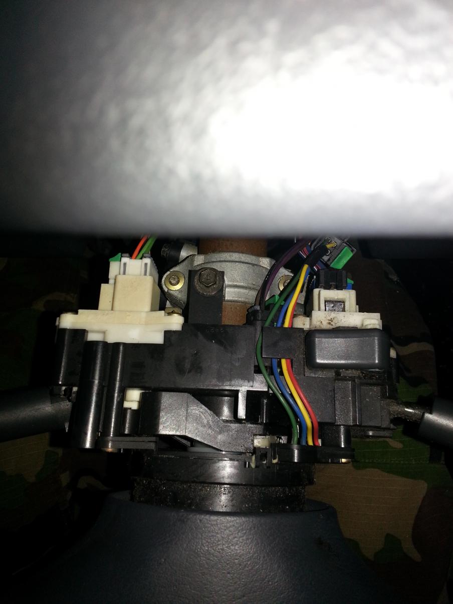

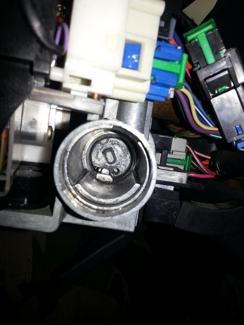

Hello,
I've included pictures of my Saturn's set up. I can turn the piece clockwise but I still haven't been able to turn the piece counterclockwise. Every time I've tried, the piece won't budge. This is what the piece looks like.
my ignition switch is on the left side of my steering column.
This is a top view of the housing.
I fear I may have to take apart the housing to solve the problem.
Maybe someone else that has done this will pipe in, sorry but I'm at my end on this one. It should turn back with no problem so something has gone wrong I'm afraid. BTW is the battery disconnected? It looks like you have not disconnected the connector.
Try putting the transmission in neutral or just jiggle the switch, or if 5 speed, step on clutch. It should not affect anything, but what's the harm in trying?
Does your car have a tilt adjustment? If so, let the wheel down as far as it will go, and unplug all of the wiring connectors on the damn thing. Get in the passenger seat and then get on top of the steering column and look for a slot that you can place a small, flat blade screwdriver into. It's a bitch to locate, but it's there. Push your screwdriver in there and hold it with one hand and using another flat blade screwdriver, insert it into the hole where the switch goes and see if you can GENTLY turn the position on that. If not, then I don't know what to suggest either. Mine was a royal pain in the *** to swap out too.
I wanted to thank everyone that has given me feedback on this thread. Thanks alot to Keith and rubehayseed!
The original actuator problem was fixed once I was able to remove the housing and push in on the piece I needed to in order to turn the actuator back.
