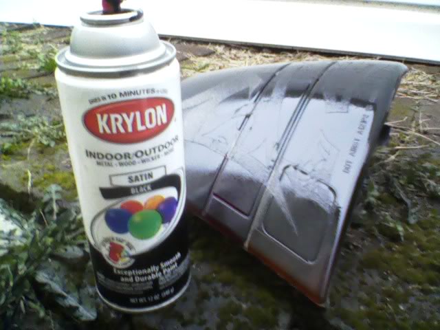

PAINT
I heard of this paint called Nightshade thats meant for the purpose, but I just used regular Krylon spray paint and clearcoat.

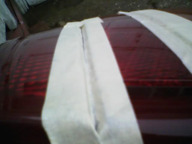

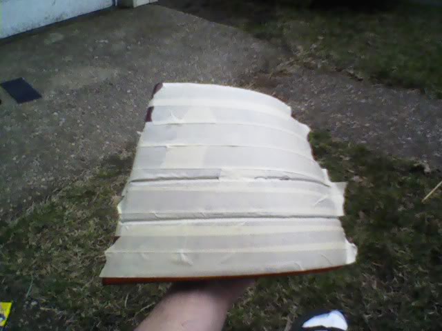

4. Put a strip of masking tape IN the grooves. This is so that paint doesn't flow into them and ruin the design. Do this by pressing the tape on one side of the groove, pushing it down with a pen, and then pressing in to the other side.
Attachment 1983

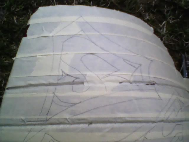

5. Mask off the surfacee of the light, overlapping by about 5mm.
Attachment 1984
6. Draw the design so that a part of each light (brake, reverse, turning, etc.) is a part of it and will not be painted. I'm going with a superman theme for my ride.
Attachment 1985

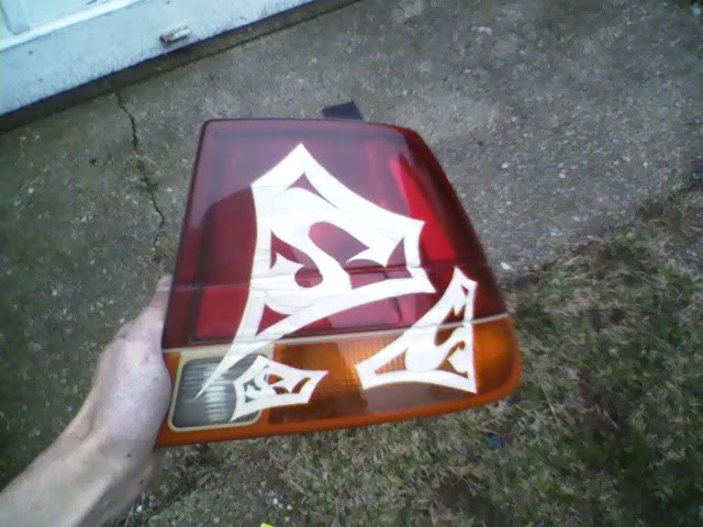

7. Cut out the design with a razorblade and take off the rest of the masking tape.
Attachment 1986

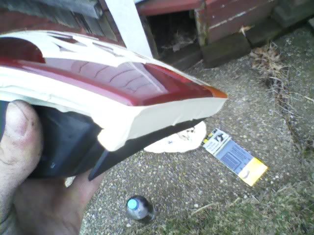

8. Mask off the edges of the assembly. This way you will have a neat line around the edge and will look professional.
Attachment 1987

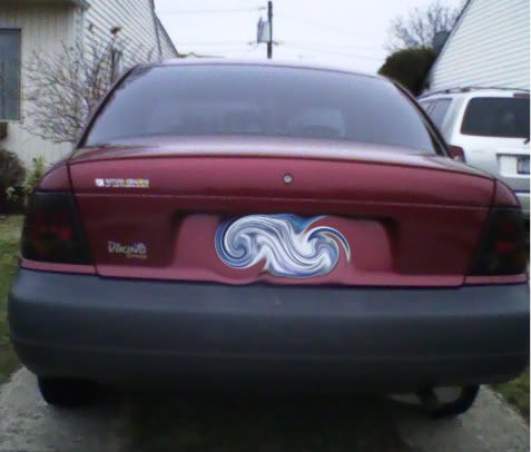

Some more pics:
Attachment 1989
Attachment 1990
