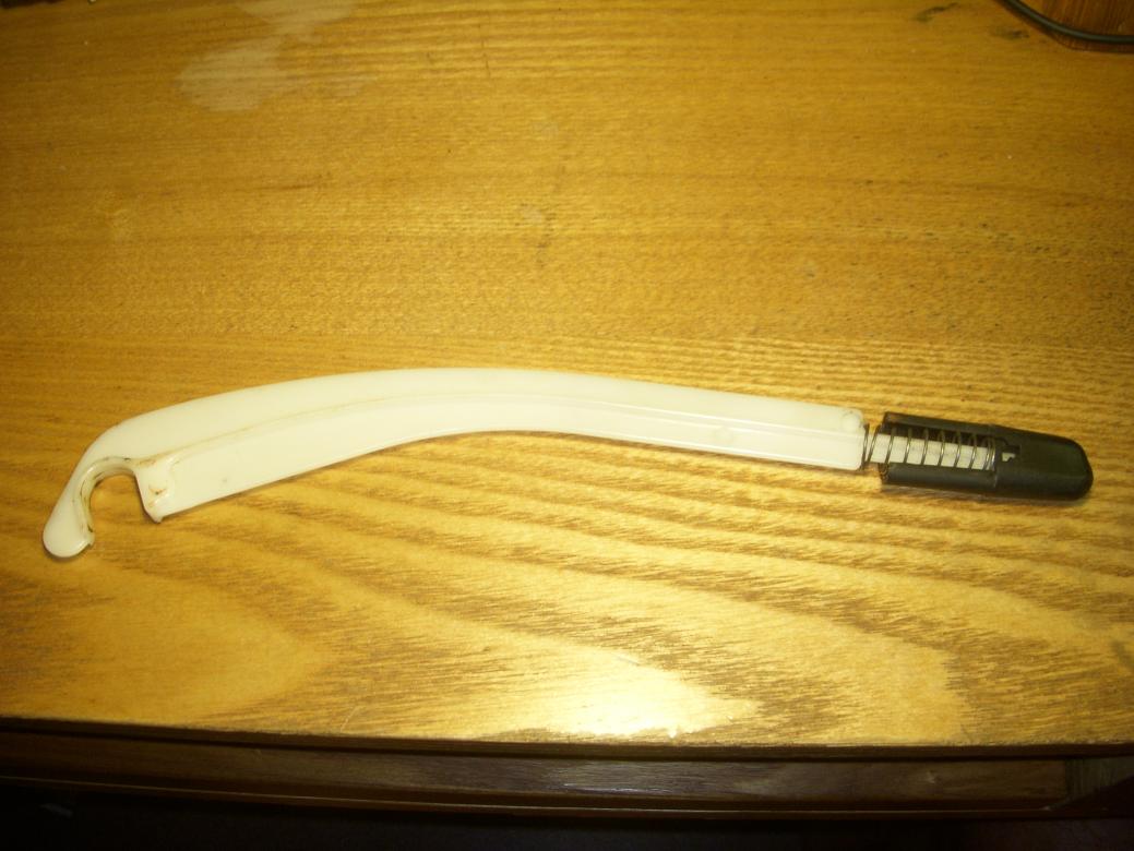

Here is the part you are looking for. It is is easy to replace-takes about 5min.

how much will you sell it to him for, Hos?
(Nice table)

Ichythus, were you able to find that part? I have a few spares if you need one. I'm wondering what causes them to fail? I assume, like other plastics, heat and time are the culprits. I've only replaced 4 or 5. I think the newer models have metal linkage. Derf, what are those quotes from?
