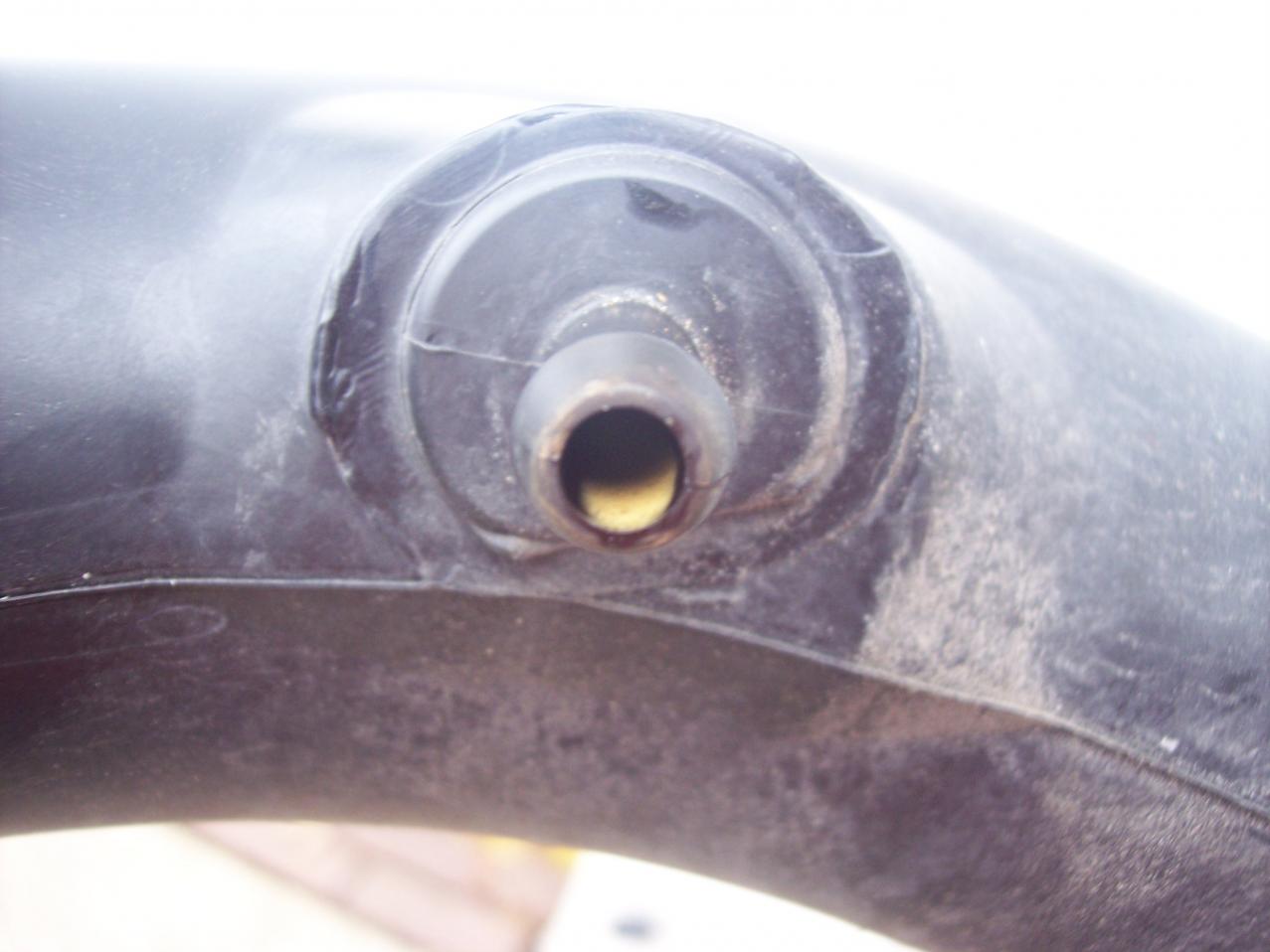

After Cleaning the Throttle body I found a few things.
1. The IAC is Chipped on the plastic.
2. The IAC does not move when the key is turned to run position.
(read in another post that it is supposed to.)
3. Rust colored material in intake tube and small tube running to engine.
4. Throttle body gasket "wet" with the same material as in the tubes(not sure).
Attached Thumbnails Engine Problems with 2000 sl1-100_4611.jpg   Engine Problems with 2000 sl1-100_4600.jpg   Engine Problems with 2000 sl1-100_4605.jpg   Engine Problems with 2000 sl1-100_4606.jpg   Engine Problems with 2000 sl1-100_4607bv.jpg
