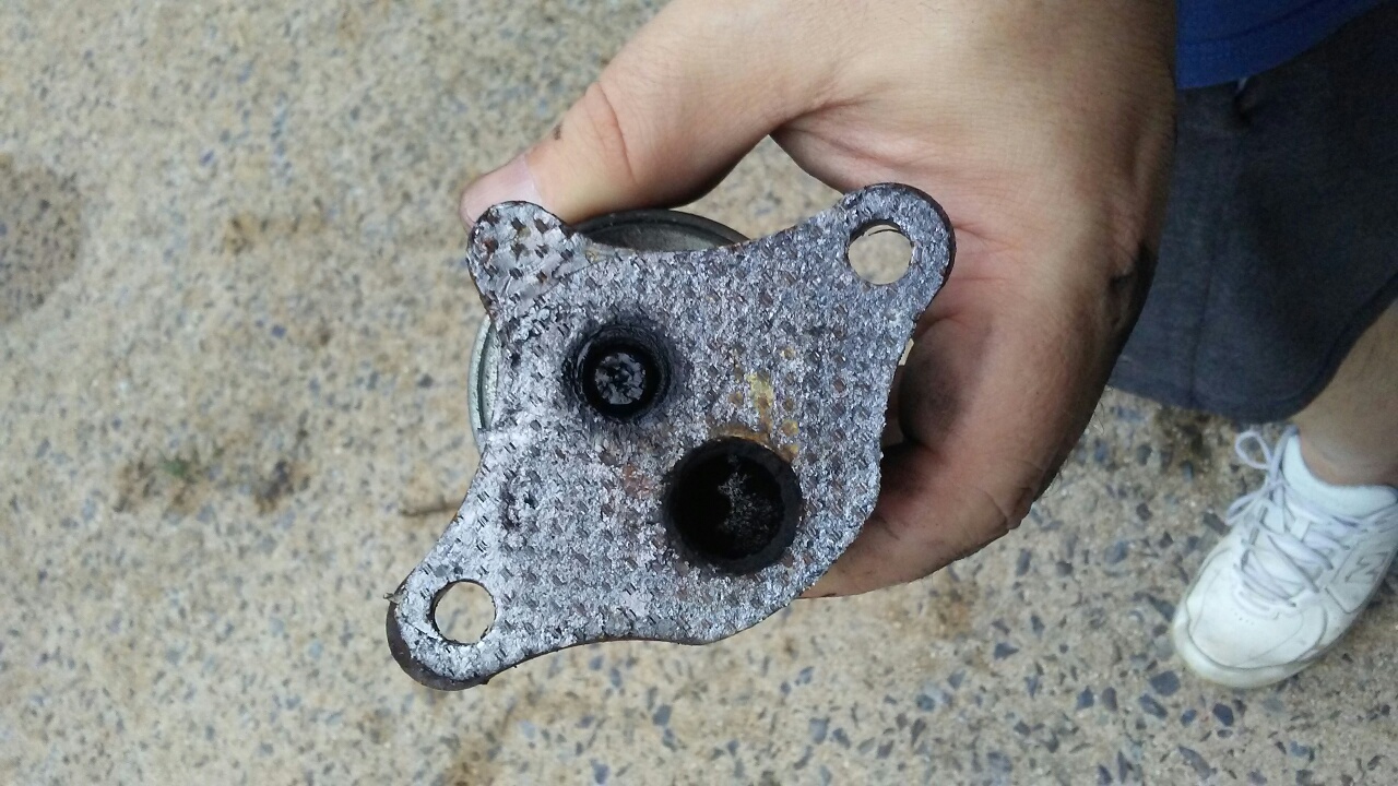

3 codes. wonder why he didn't mention the other 2
p0404 p0327 p1599
I never did any knock sensor work and she said she just stalled it recently so that's probably the 1599

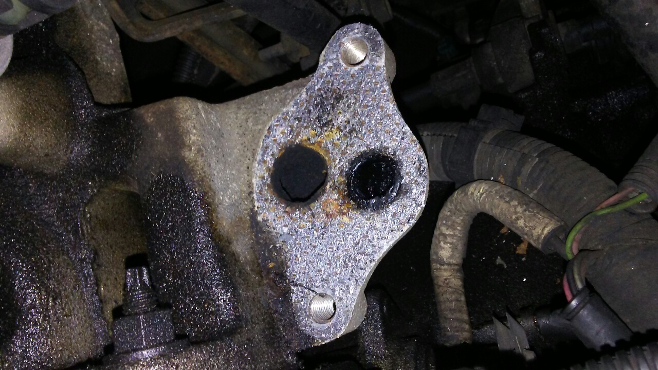

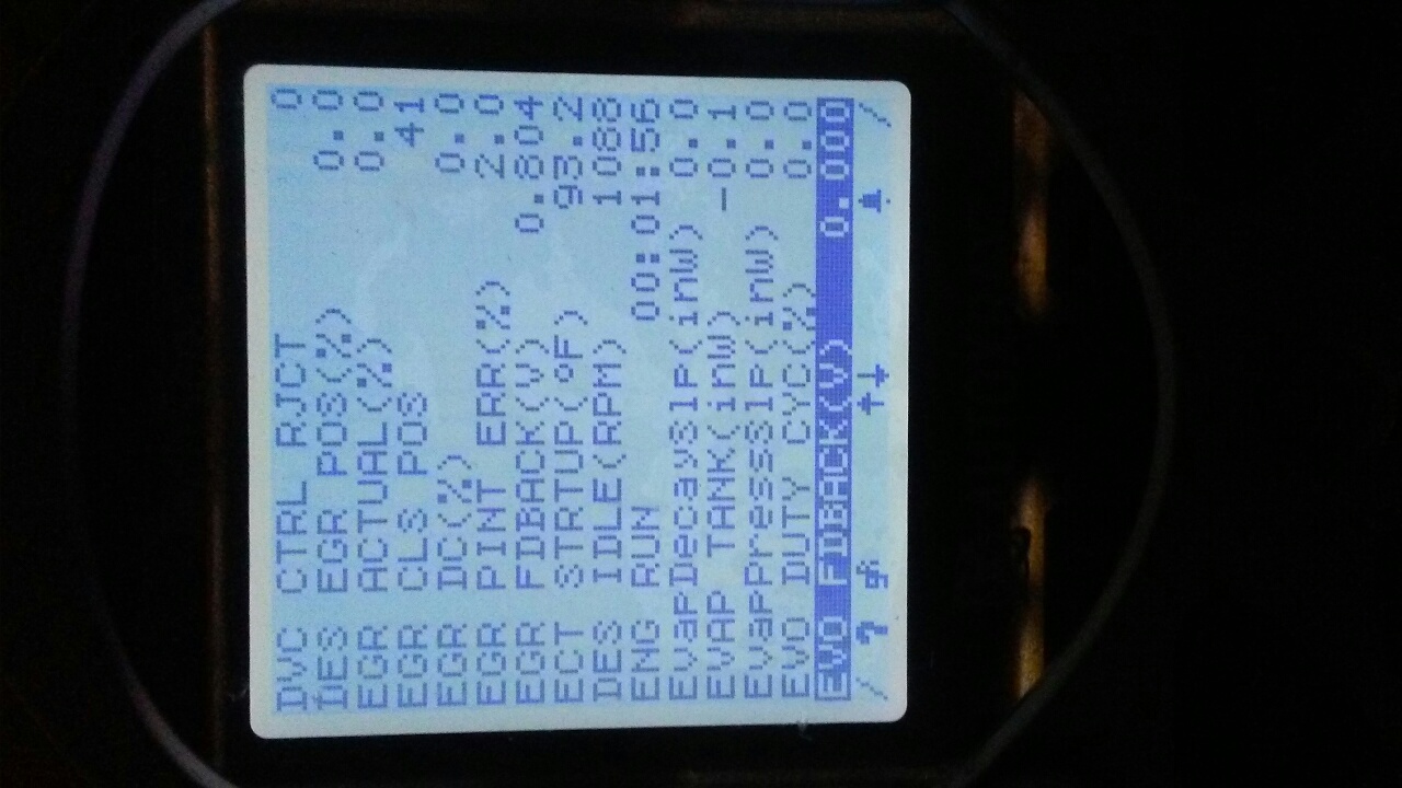

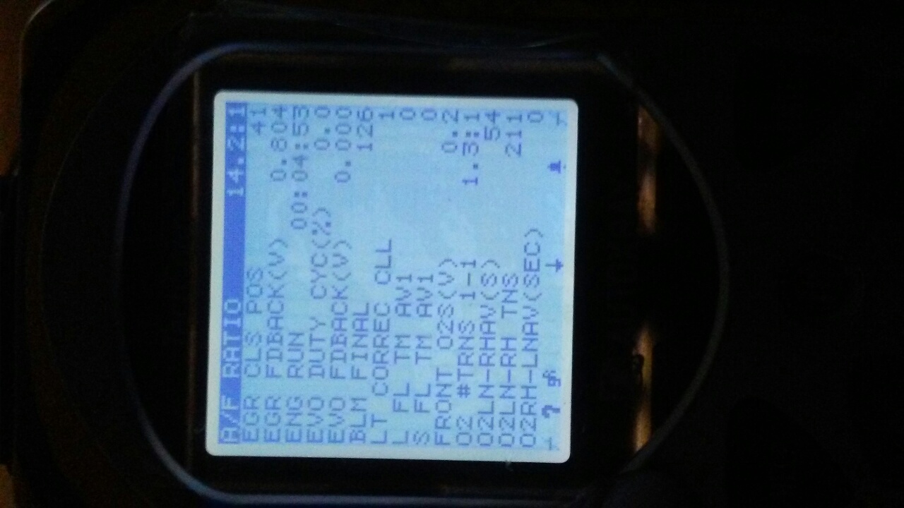

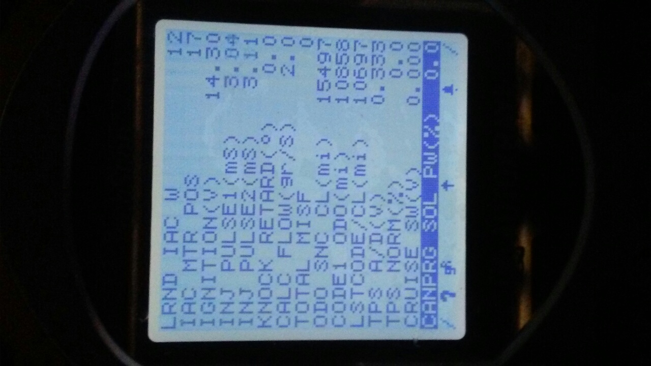

I cleaned EGR up a bit. this is how it looked before cleanup. also started it to blow out stuff. then took some pics of other stuff I have no clue what it all means
I can get you more stuff if you need off the computer
so do I drive it with the cleaned up EGR and let it reset or clear codes with my machine?

P0404 EGR Circuit Range/Performance
That is one filthy EGR. as are the ports that lead to and from it.
Clean as directed but be sure NOT to bend the pintle
Cleaning the ports it at attaches to seems to have already been done.
Please post pics of the cleaned EGR and ports where it attaches.
P0327 Knock Sensor Bank 1 Low Input
Sounds like knock sensor is not sending an acceptably high signal to the PCM.
This often means either
1)the sensor is not getting its 5V (I think) feed from the PCM
2)there is a wiring problem somewhere between the knock sensor and he PCM (wiring harness, wiring, etc...a break in the continuity of the circuit.
3)knock sensor is defective.

EGR -- you've cleaned. Pintle must move up and down freely without sticking

Clearing Codes
Most of your other I/M inspection readiness tests have already been run and probably passed. Use your scanner to read the status of your I/M monitors.
Unless you have previously cleared codes recently, they should all be "ready" except EGR and possibly "comprehensive" for the knock sensor.
You don't want to clear codes this close to the inspection deadline if the majority of thee monitors already indicate "ready".
The EGR will take at least 50 mi to decide if it is working properly. Check to see if you can get the EGR to "ready" state

well the pintle was indeed frozen. glad I watched the video. I soaked it and sprayed,. worked until dark cause put new brakes on too. fun times all around. we are taking it on at least 30 mile drive tomorrow doing stuff so hopefully the code clears for the EGR
i'm assuming stuck pintle would throw the code? maybe we got lucky!
