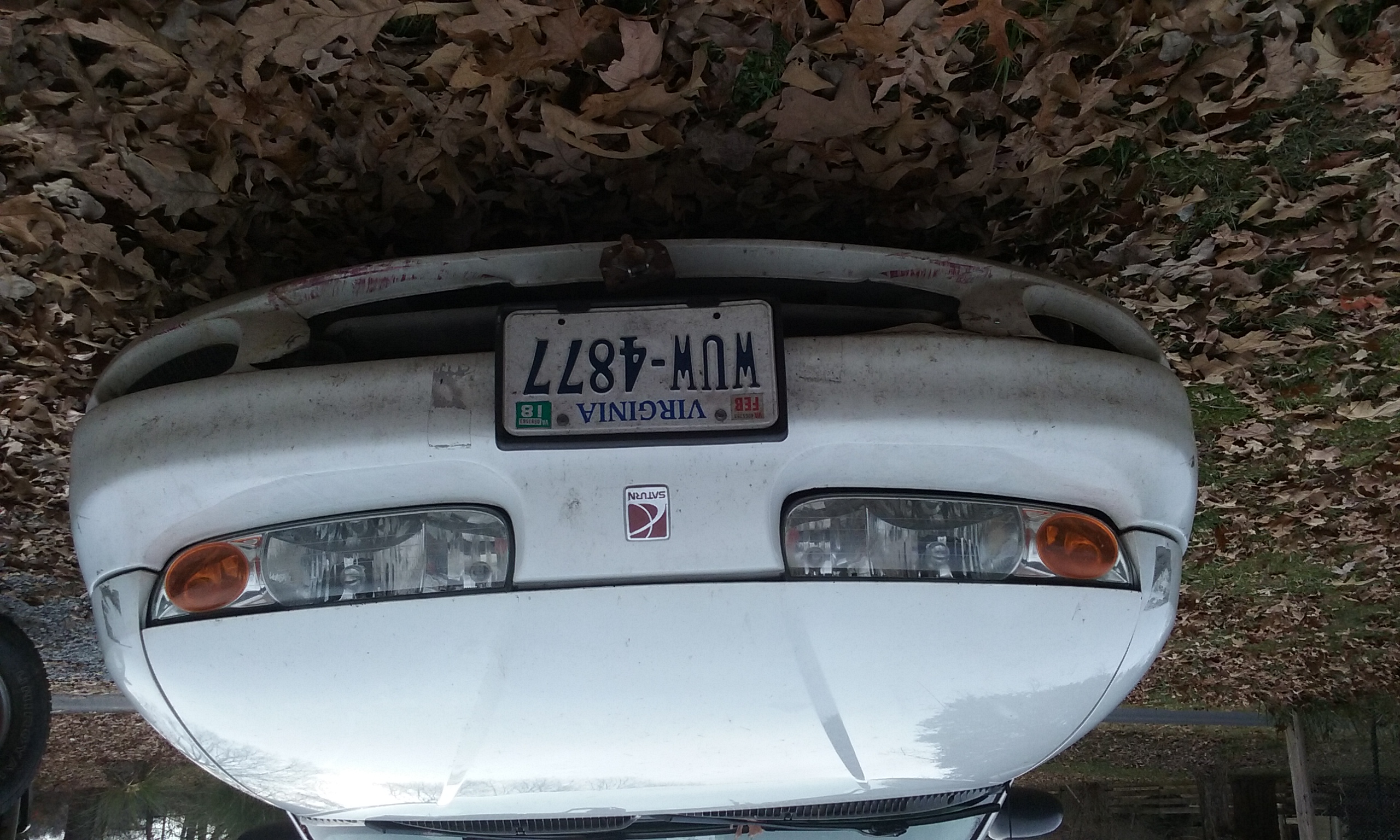

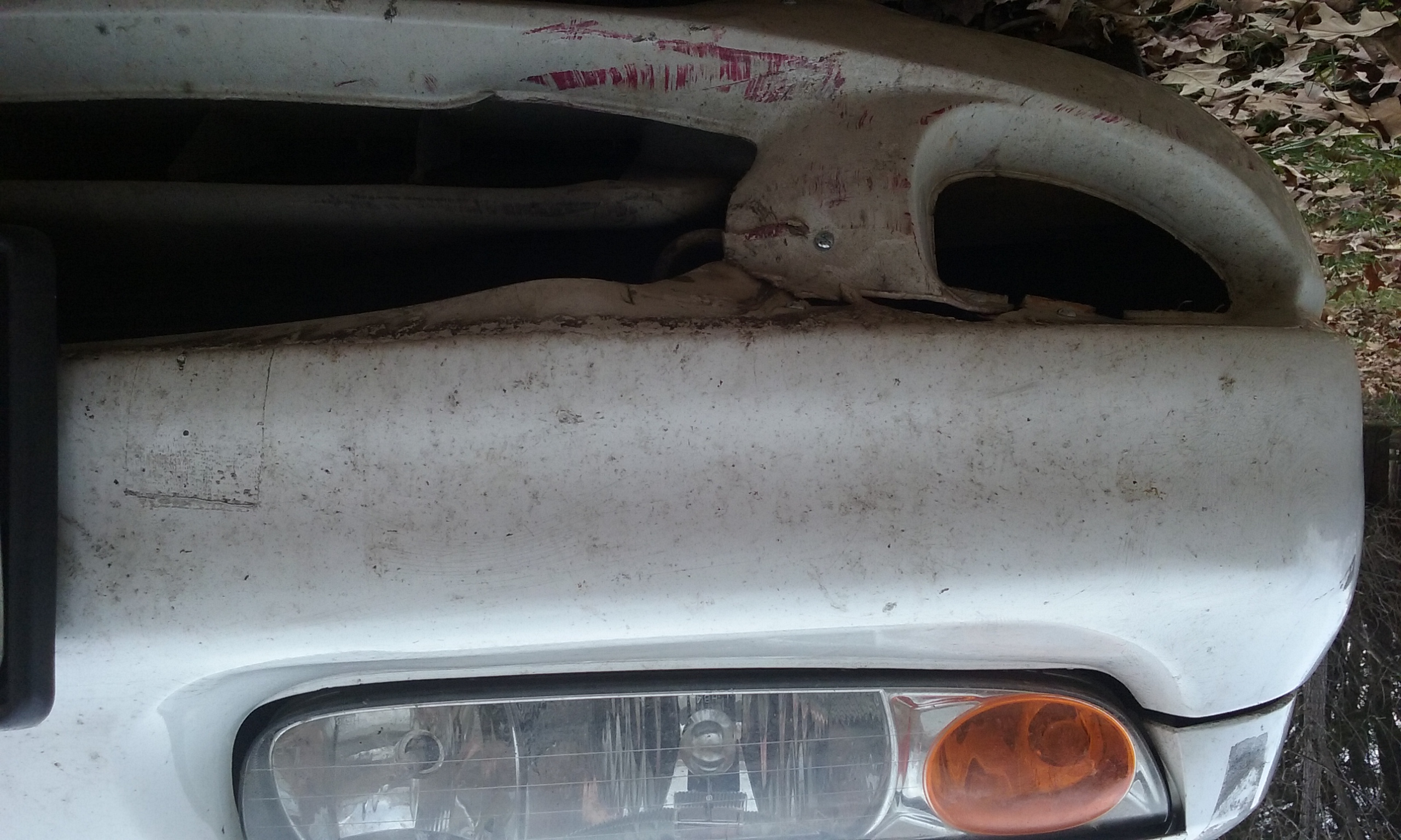

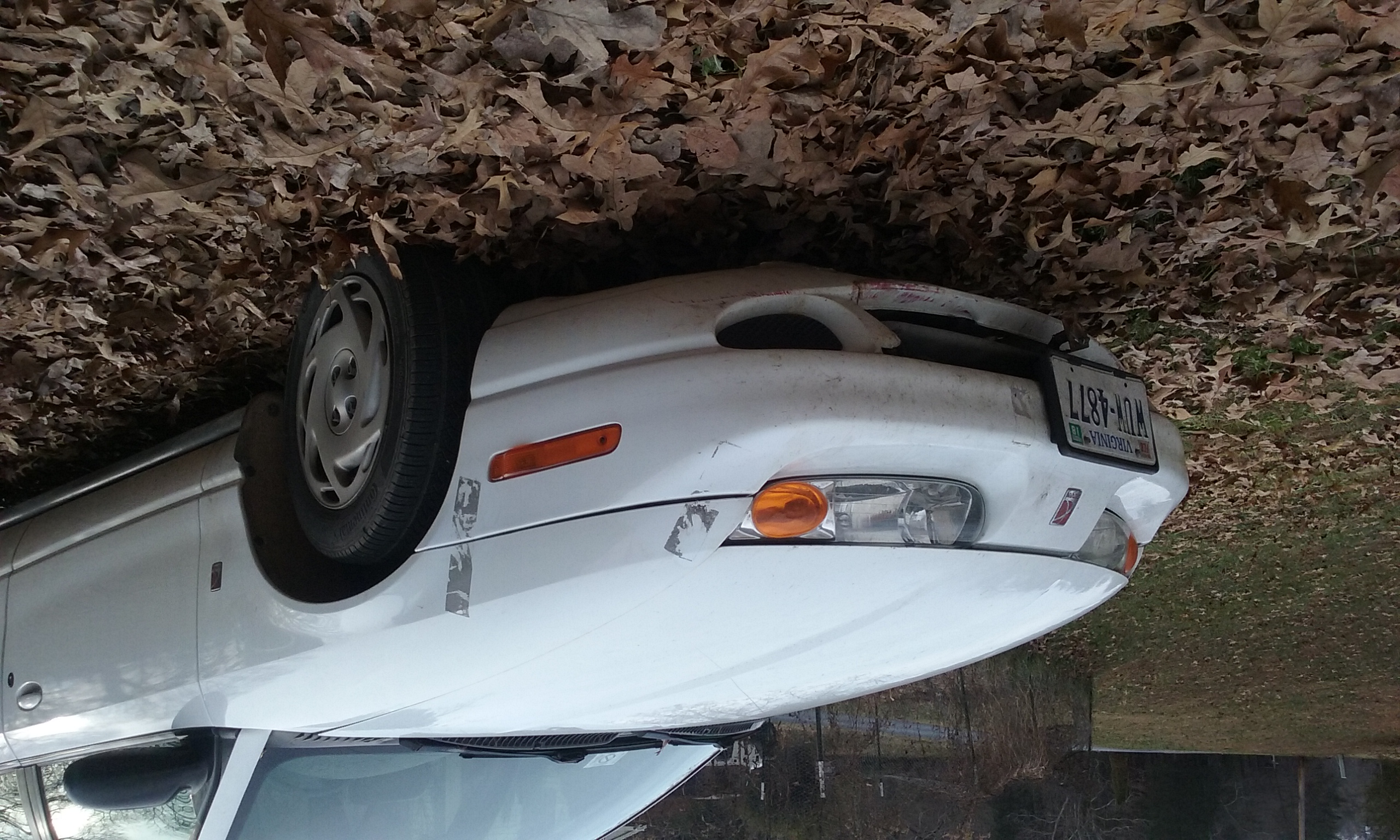

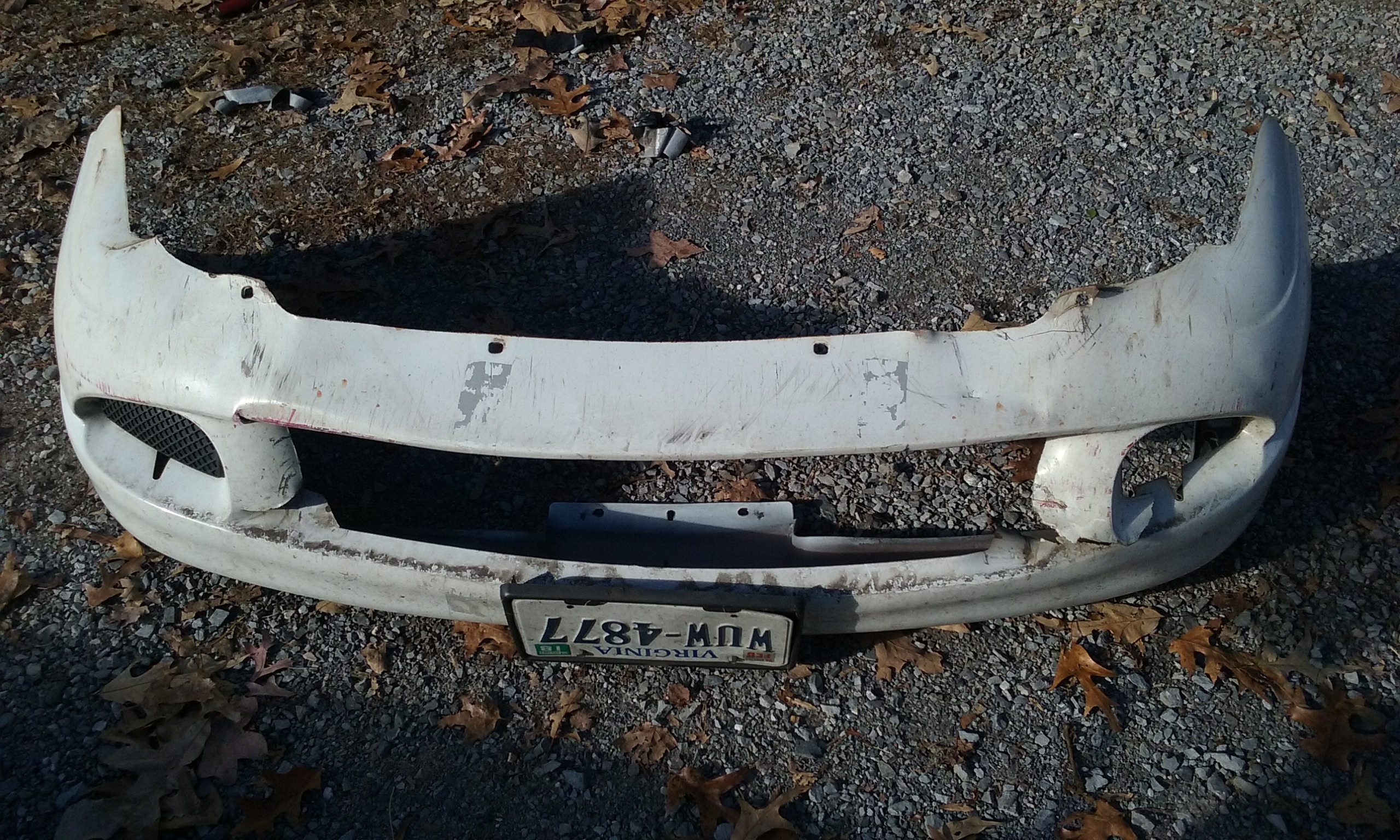

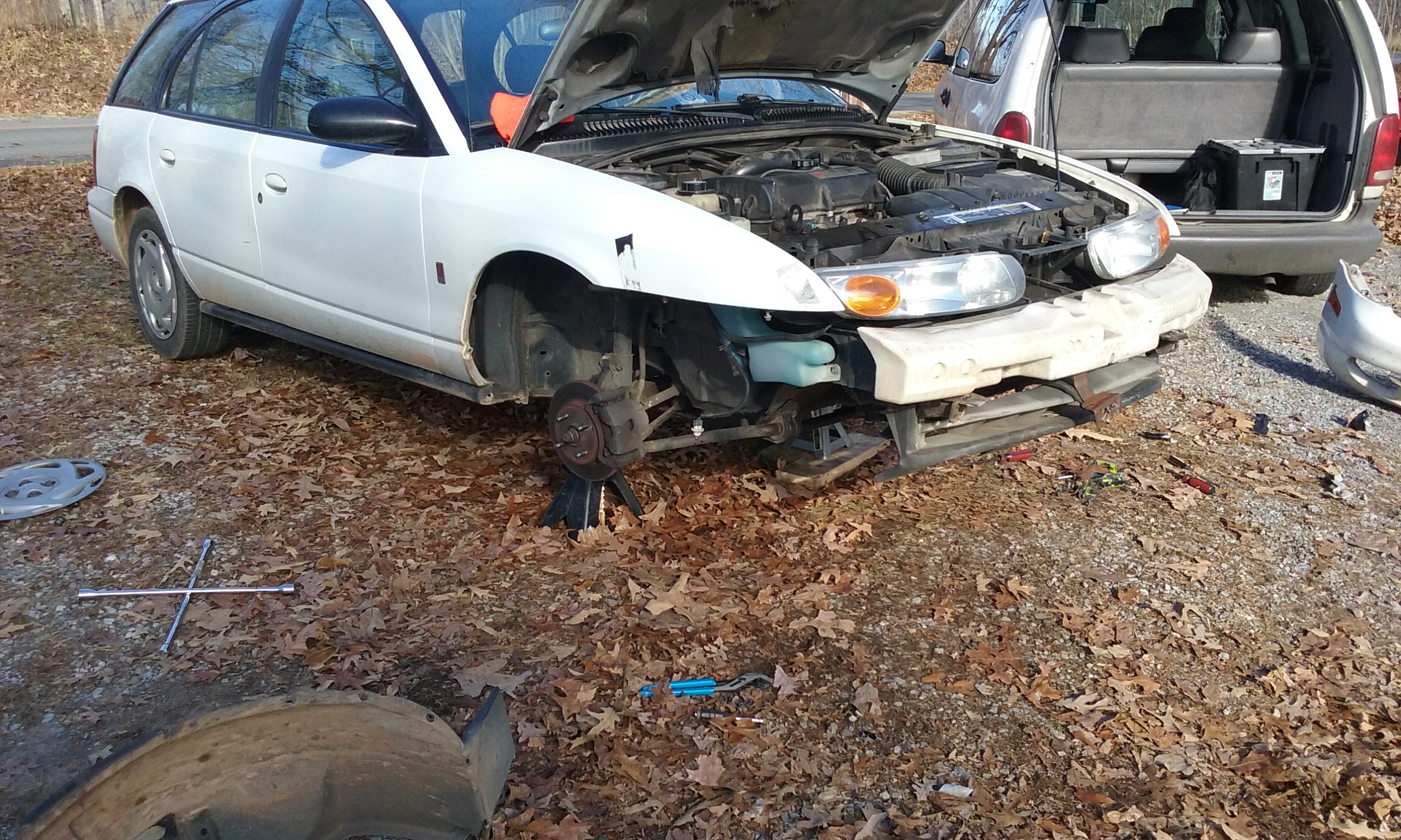

I finally had a chance to work on the Saturn and try to fix the bodywork yesterday but I had no money for parts so things got interesting.
First, removing the Gorilla tape was a chore in itself. Whoever came up with that inspection rule must have never worked with Gorilla tape. That stuff is NOT just another duct tape. Once that was off I was able to pull all the damaged body parts off. I had a damaged front bumper cover, shattered inner fender liner, broken lower support, twisted metal backing plate, side markers that had retaining tabs broken off and many of the plastic rivets were shredded or missing.
A propane torch carefully fanned across an area of that plastic fascia will soften it enough to mold things back in shape (several areas were twisted and stretched severly from the wreck). A couple of the tears I was even able to "weld" back together with the torch. I used a 16oz claw hammer to beat the metal backing plate back into shape and got it re-inserted into the bumper. Some scrap metal and screws patched up the bottom where it had been ripped completely loose. The shattered inner fender liner got a layer of Gorilla tape on the inside (where the inspector won't be able to see) to hold it together. The two marker lights are now screwed in from behind in addition to the one on the outside. Bulb replacement will be a pain but that doesn't matter right now. Fortunately I had purchased a couple of boxes of plastic rivets a few months back (so I could reattach the lower air dam when it got ripped off by a rock in the creek I was crossing. I never got around to putting it back on.) so I was able to use those rivets to replace the ones that got damaged in the wreck.
What surprised me was how easy it was to put the front back on and that it's only held in place by plastic rivets and the six little screws connecting it to the thin plastic fender liners.
Should pass inspection Monday and didn't cost me anything but my time in the freezing cold.
