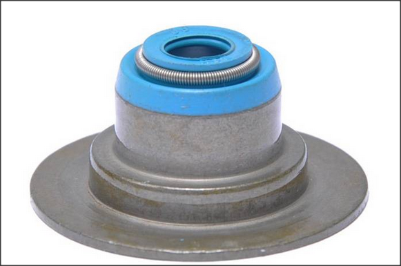

I would just replace the lifters as a set. Did you have the "new" head inspected for a cracked or burnt valve or seat? Are there umbrella type seals on these engines (IDK), but if so you should replace them too. I'd suspect that by now they're old and brittle.

This is how Valve Stem Seals and Valve Lifter look on my Saturn SL1
