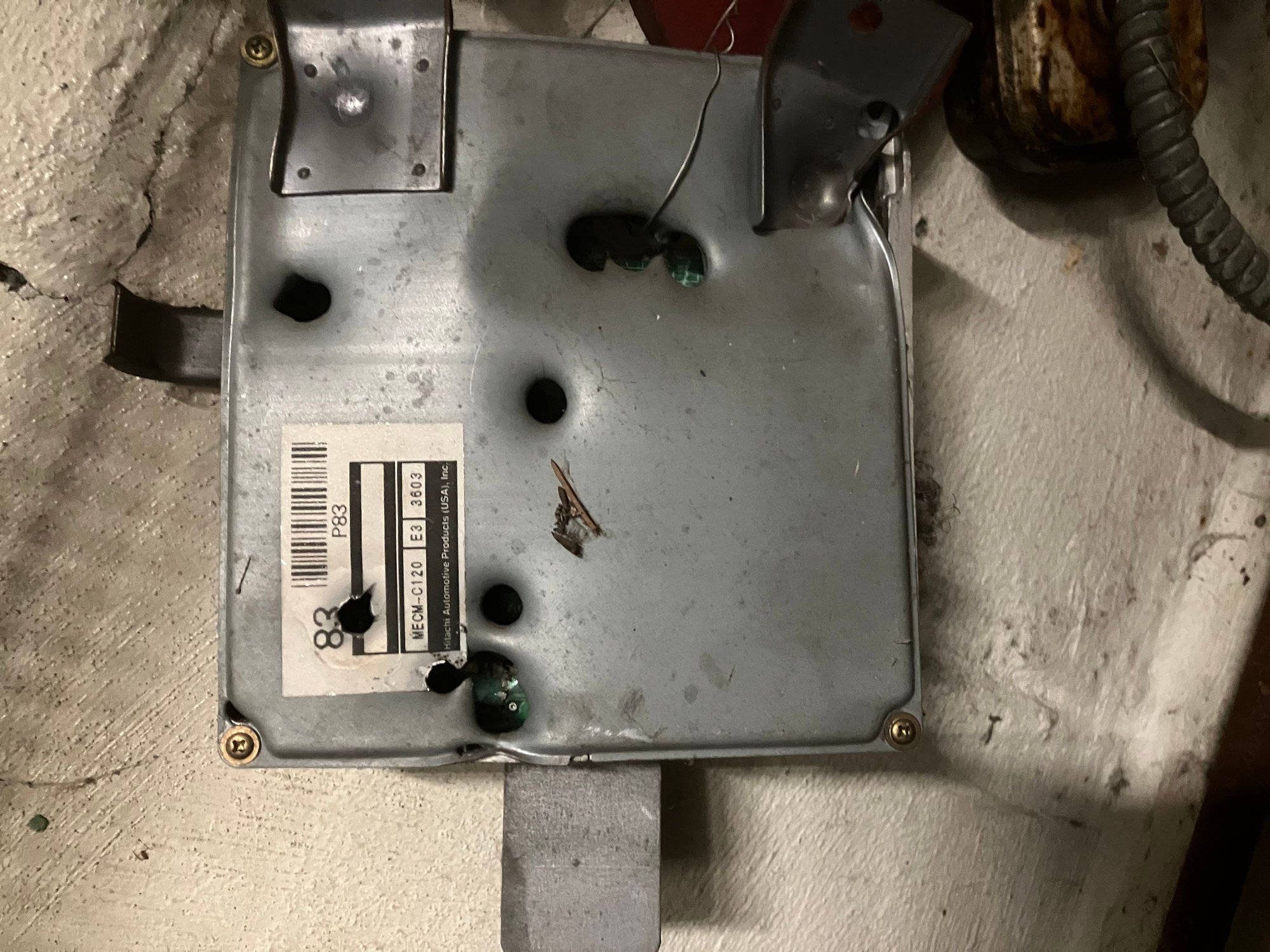

In all my years of fixin these vehicles with computers I have only found 3 bad processors. 2 at the Ford dealership I worked at and 1 on my 1993 mercury Pillager.
It being OBDI required me to do 2 days of following the troubleshooting tree and I ended up with a "Replace PCM" box for my efforts.
So I replaced that PCM with a used PCM of the proper calibration and I had a fix.
I took the bad PCM to the range and tested it some more. I tested it w/ 32ACP from my wife's pistol then tested it w/a 9mm from a DAO pocket pistol and finally w/45ACP as you can see the Gold Cup's trigger is a beautiful thing!
That testing also went a long way at reliving my stress after spending 2 days "ringing out" the harness on the Pillager!
Now back to your problem...
