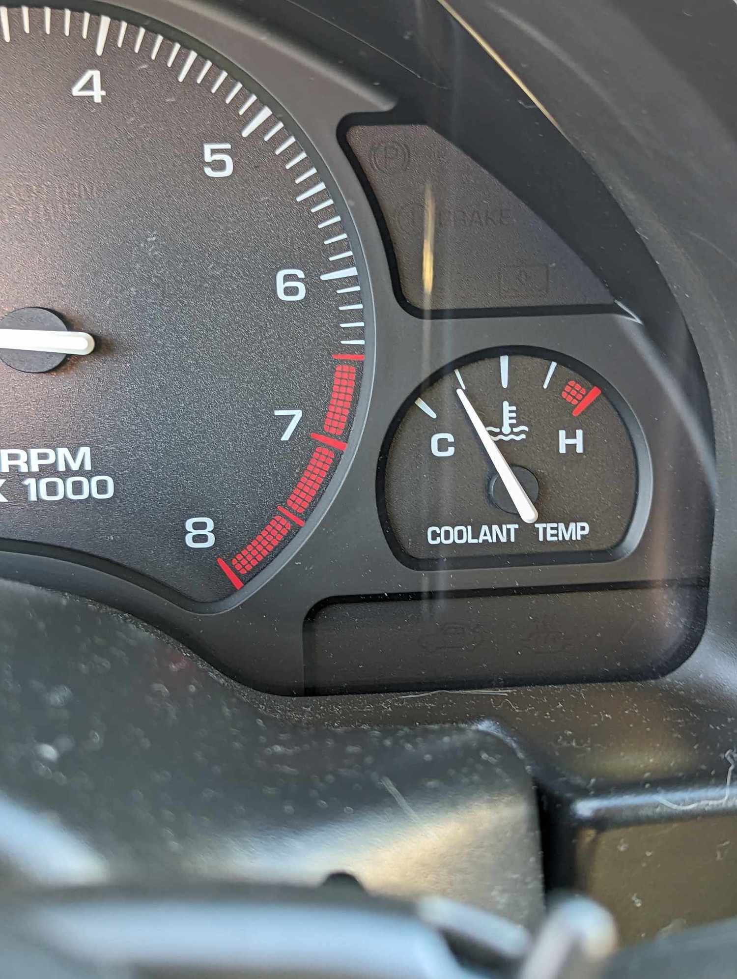

I will check and take pic of the temp gauge when car warmed up. Yes, the Coolant reservior is full when cool.

The first picture is where the gauge is when driving . The second one the gauge when its sitting idlelling, it goes up little.

Textbook indication of a thermostat stuck open on a Saturn S series. Be somewhere between 11:00 and 12:00.
Do not buy an AC Delco branded thermostat with housing. What you get in the box is a cheap aftermarket brand that is known for its exceptionally short lifetime before sticking closed and overheating your engine.
It would be nice if you can find a stant thermostat to match the original which I believe is 185°. Then you can bring use the thermostat housing already in place.
I recommend you change the o-ring on the housing. You need to be aware of the fact that the OEM housing is no longer available and for whatever reason, the aftermarket gaskets are usually the wrong size if you are reusing the OEM housing. I believe there is also an issue with the newer stant thermostats not fitting into the older OEM housings .
Search over on Saturnfans.com . I remember there was a massive thread there about what fits what and what doesn't fit what.
Make sure you orient the coolant hoses pretty much exactly as they were attached or they have a tendency to leak when they are this old.
Motorad. That's the piece of shayte not to buy that comes in the AC Delco box and of course on its own.
