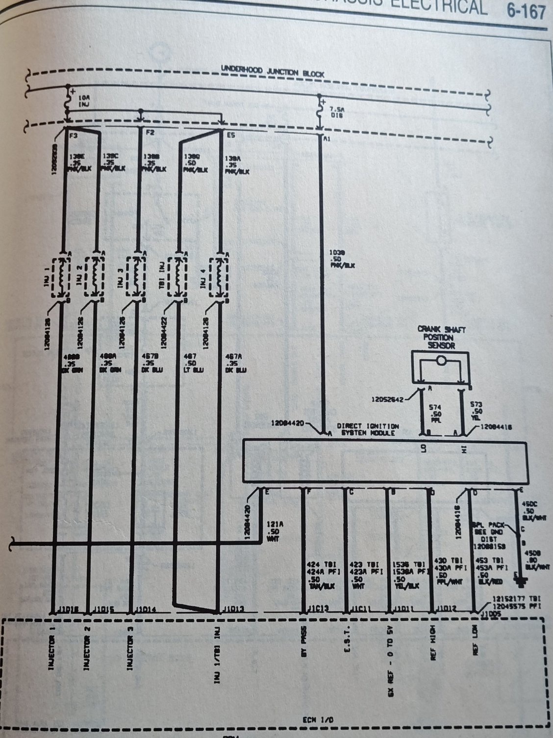

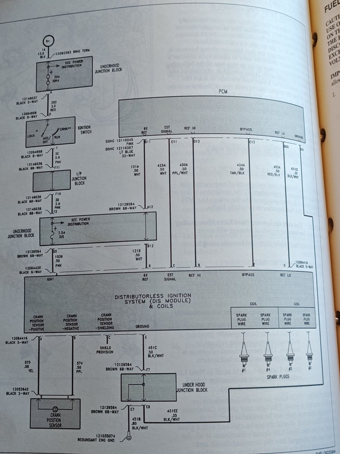

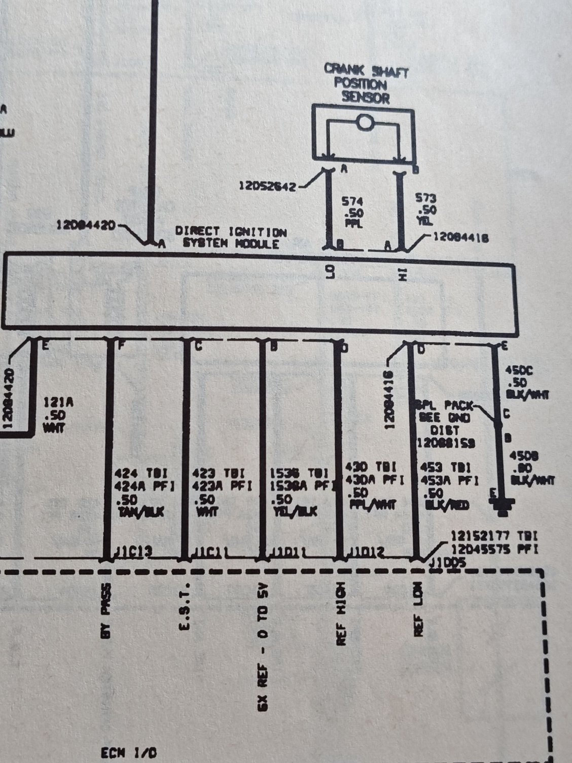

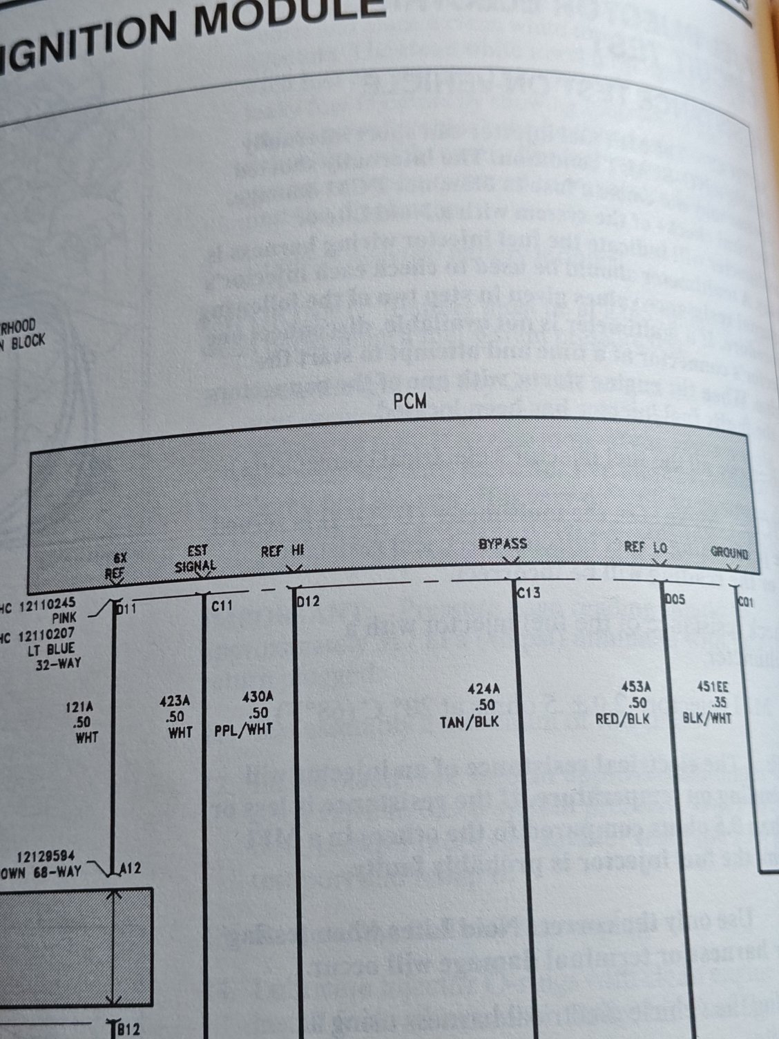

I have attached schematics from the '95 FSM as well as a Chilton 91 to 93 book. I've used the wiring diagrams all the way up through 97 and 499% of the vehicle they are the same. I did not take the time to check and see if they are identical.
The blur on the Chilton's pictures is unavoidable because the ink has diffused outward on the cheap paper it's on. My cell phone has a 40 megapixel camera on it so that's about as good as it's going to get and you can blow it up and still read it.
The full page shots are probably not readable which is why I took segments after that as well.
Per Gary, you definitely want to inspect all of the ground splice packs in the vehicle. With a 31 year old vehicle, there's bound to be corrosion. It only takes one of those grounds to get lifted for the current to find the next easiest path to flow. And depending where that goes, it's amazing the weird ****e that will go on.
Ultimately, I would check all the grounds first, then the wiring between the PCM and ICM / DIS.
There are all kinds of handoffs of the ignition timing control back and forth between the PCM and the ICM depending on various conditions that are for our purposes not necessary to explore but there are explanations out there. Many of the handoffs are triggered when the ignition system encounters problems doing its job and hands control back to the PCM which runs on the base timing programmed into the PCM instead of advancing the timing based on map and other things.
Anyway, if none of this fixes your issue, I would look into a set of rebuilt fuel injectors. They are easy to swap out and I don't think terribly expensive.
