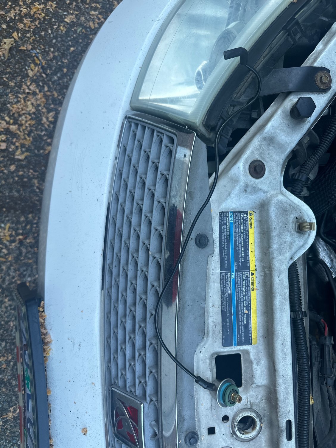

Hey I had a fuel leak coming near the rails got the car teared down until I noticed this line/hose was ripped can anyone help me identify where to get such line/hose: thank you! (Fuel pressure regulator)

Year? Model? Engine?

3.0L v6 2005 Saturn l300 sorry I should have specified

You're right about it not being available anywhere. I've searched for over an hour, and found nothing close to that length. What is it, about 16-18 inches? It looks like the main issue is that the connector at the pressure regulator is broken. Perhaps you could buy one of the shorter lines (Amazon has some for as low as $8) and splice the needed end of the new line to the existing line using a short length of appropriate size rubber tubing. You wouldn't need to clamp it as there is only vacuum on this line. Just use the size tubing that makes a very tight fit, using a little silicone grease if necessary to get it in place.

Where exactly is the leak? We may be able to repair it.

if you see at the end of the line there is a connector which is rubber it’s split

You only need a short rubber hose and replace the split one. Take it to the parts store.
