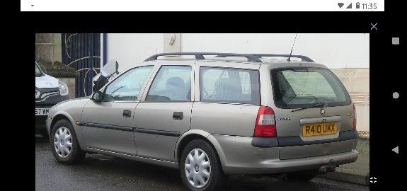

Default easy rear coil spring supply
so I ordered coils for a Saab 9-5 made in Sweden and they worked splendidly on my 2002 LW200!!!
$70 tax/shipping includedthe suspension of the L series is German Opel design and identical to Vauxhall Vectra and Saab 9-5
