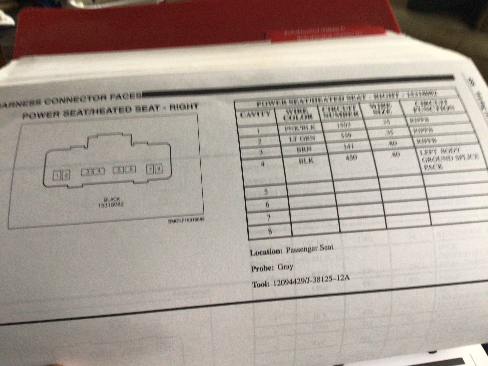

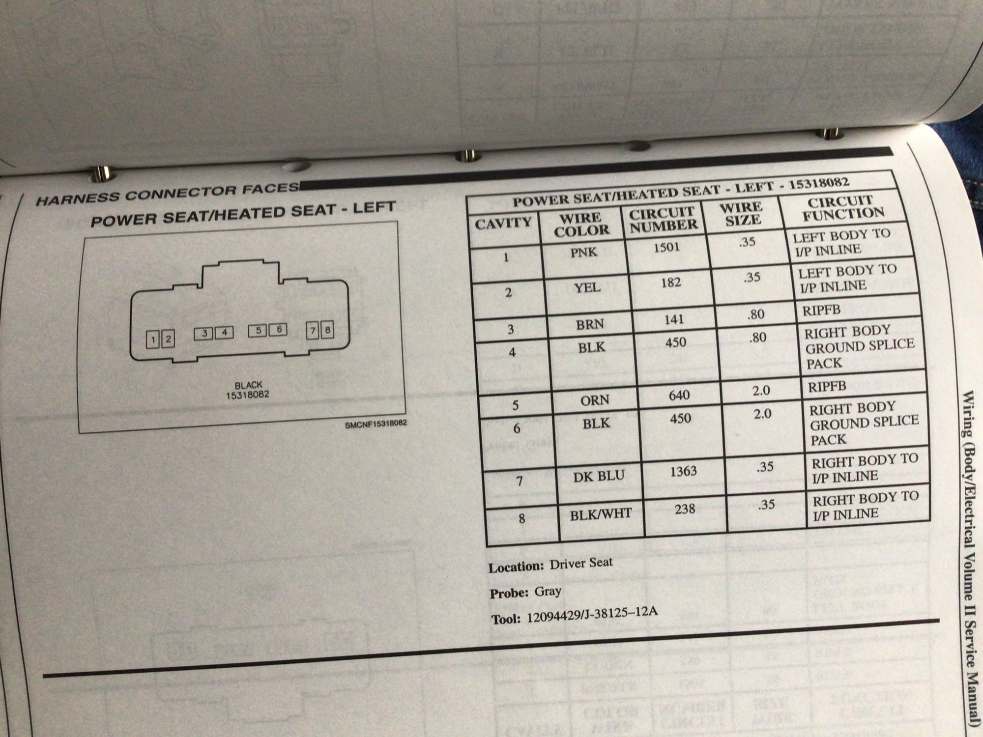

I will look up the wiring schematic and list the wire colors for all the seat options. The seat belt latch has two wires to it to see if the seat belt is being used. Any model above the base model can have the better seats.
Old Mar 29, 2022 | 07:32 PM
Old Mar 29, 2022 | 07:45 PM
orange and black are hot and ground for the power seat, black and brown are the heat circuits, the smallest wires are seat belt sensors.

Thank you for the pics 02 LW300,
Is that in the Haynes manual? I have one somewhere for my Mother's L300, I'll have to dig it out.
If we get a warm, dry day next week I'll pull the seat out and get some pics of the wiring, the seat, and frame.
Old Mar 30, 2022 | 07:11 AM
Saturn Field Service Manual.
