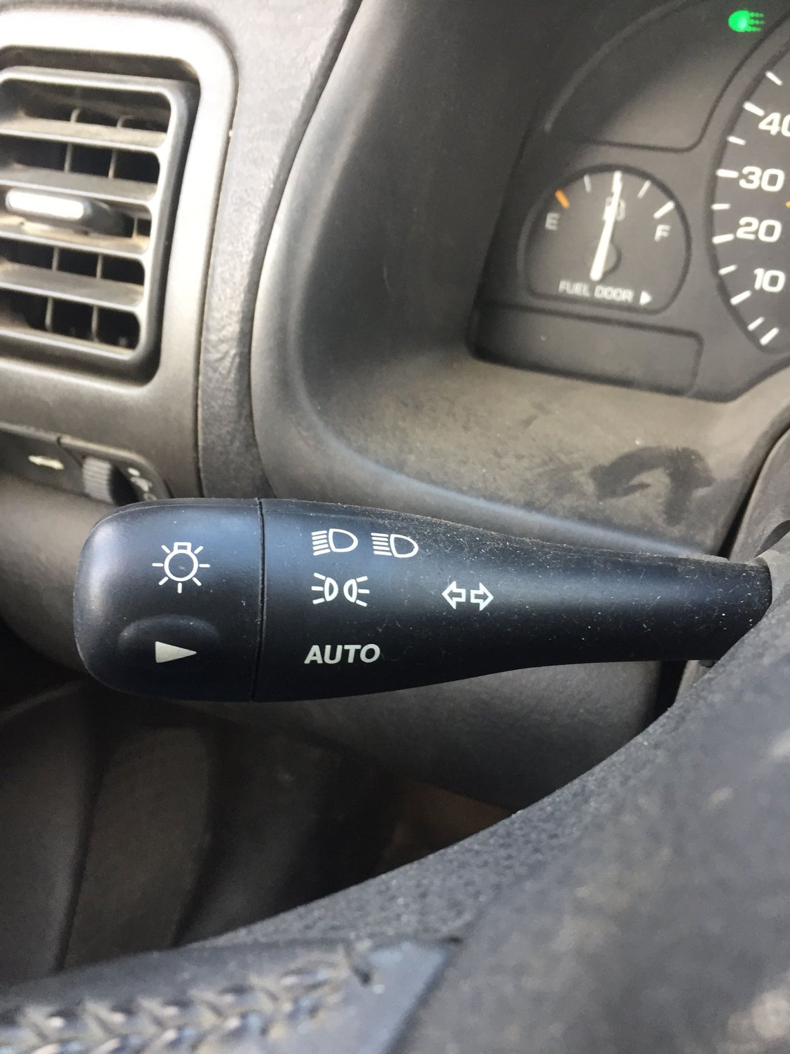

Do you have the correct multi-function switch installed? There is no off position on a 2002 L series switch. I bought a 2002 that had light problems and it had a switch for a 2000 installed. I installed the correct switch and solved the problems. I have a 2000 LS1 and there is an off position on the switch.
Old May 21, 2021 | 09:40 AM
Old May 21, 2021 | 03:59 PM
ADK427's Avatar
Joined: Jul 2020
Posts: 4
That is the same switch I have. If I turn my lights to the "on" position, the headlights don't flash, however if I leave them in the "Auto" position, they flash and people think I'm warning them of somethnig! They don't flash in either position if the High Beams are on.
