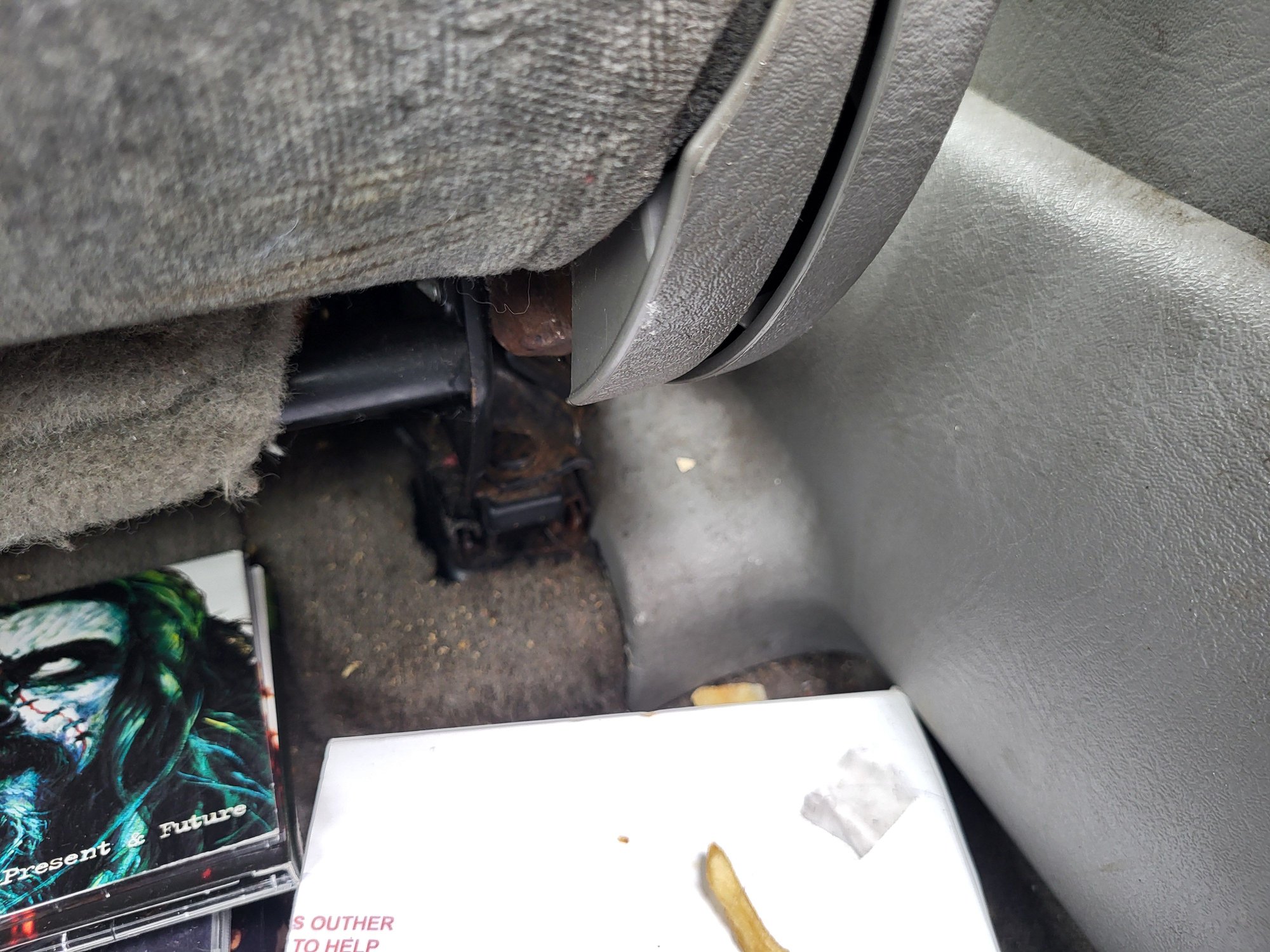

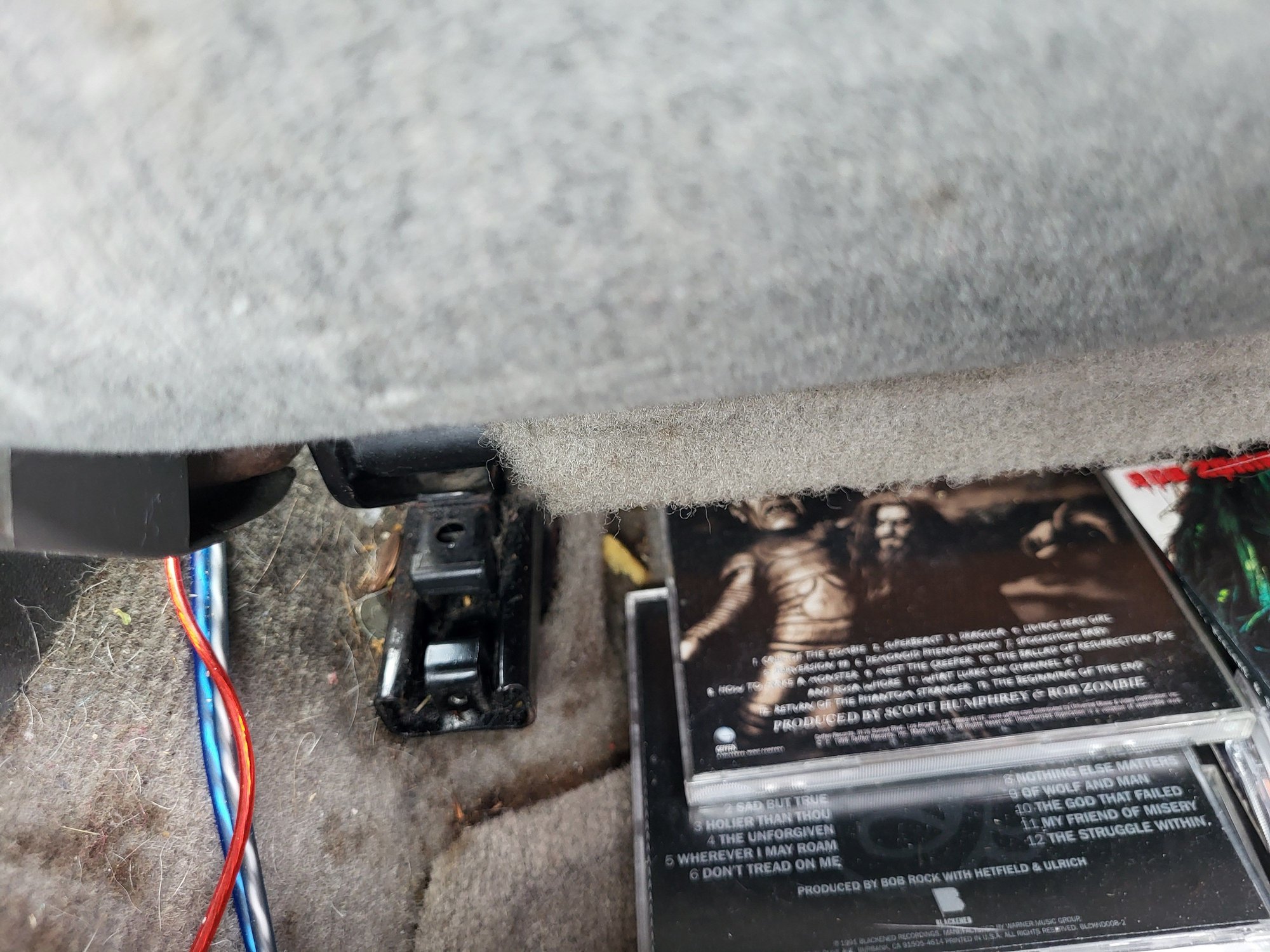

So this is as far as my passenger seat moves forward

Posts: 12,410
Rob Zombie? Metallica? What else. ?
Oh, check to see if there any fries stuck in the back of the seat track.
Are you sure the passenger back end of the track is not rusted in place? Why so rusty? Door seal leak?
