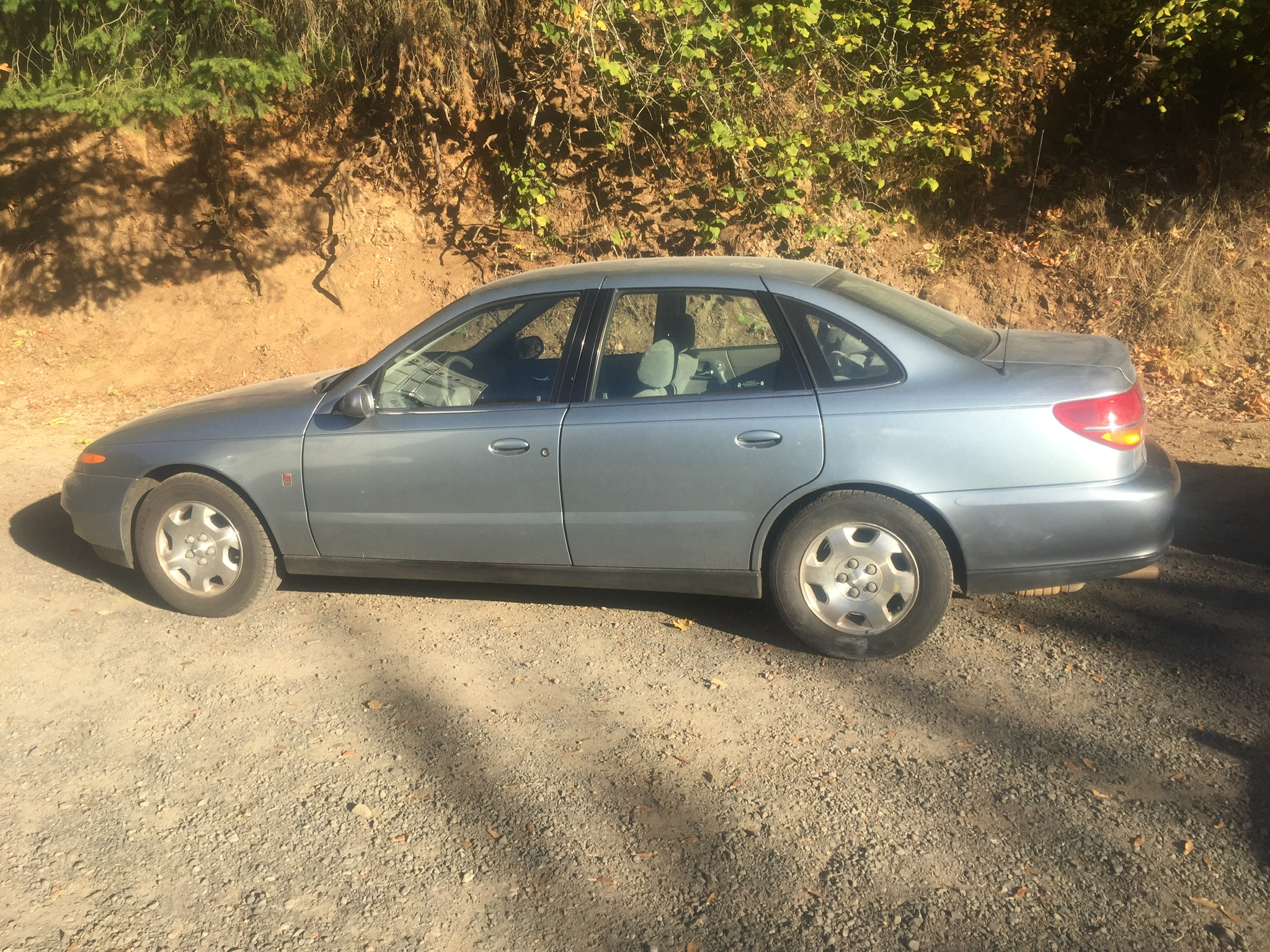

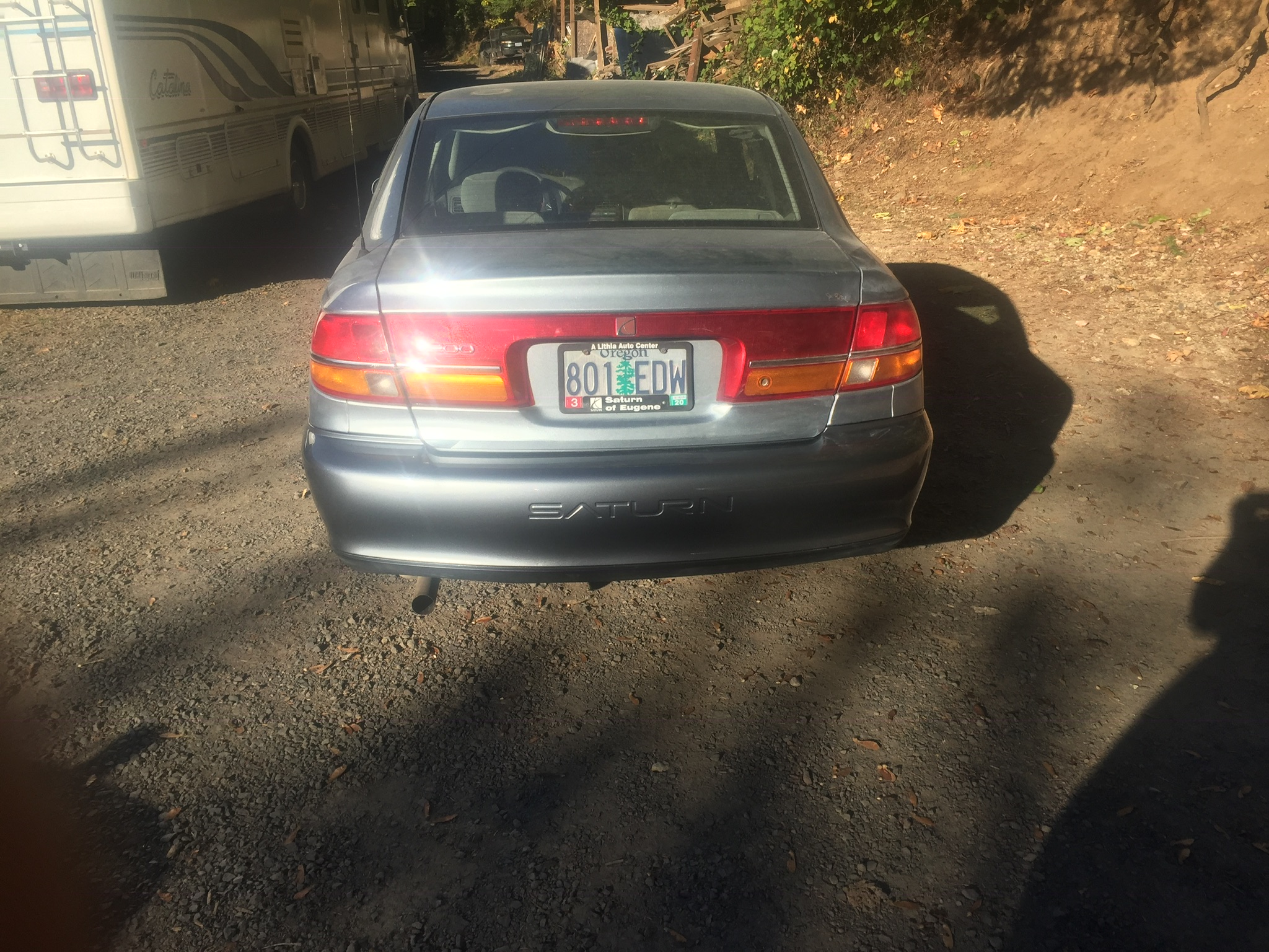

Update on the next for sale L200. I actually painted a spare dark blue bumper the close to correct color blue/silver. Bumpers are hard to match and this the paint mixed by my retired professional painting buddy. He told me up front that it wouldn’t match but would be close enough. I haven’t painted anything but touchup in 15 years but it doesn’t look bad. The original bumper cover had been cycled all the way across and had a hole the size of a trailer ball. It looks fine in person.
Attached Thumbnails Another L200 followed me home-82182645-e560-4034-ae88-340326cf2906.jpeg   Another L200 followed me home-0cb7a008-0ccc-4011-b973-3df28db9c719.jpeg
