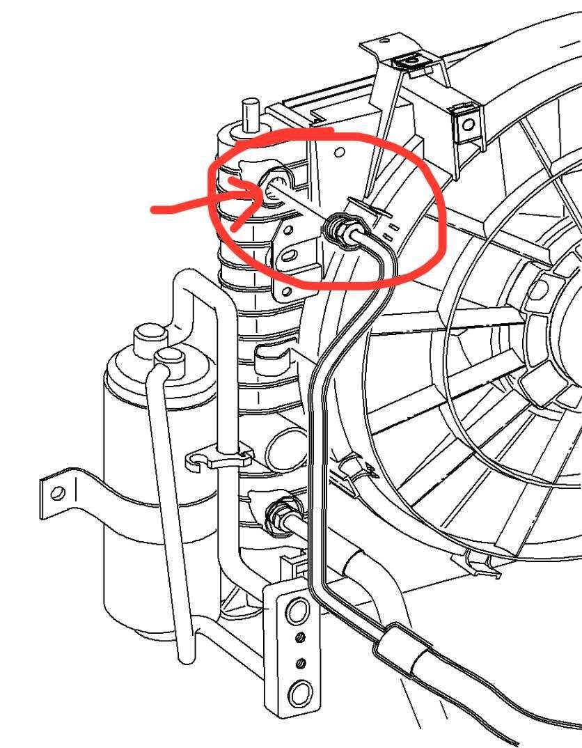

Hello - i had a fairly minor front end collision, and thought everything was okay until i got home and it started dumping all its coolant on my garage floor. upon closer inspection, it seems as though the transaxle cooler line (circled) was no longer sealed to the radiator, and while the line itself is still seemingly firmly connected, the nut (arrow) split and is no longer attached, allowing the threaded part of the connector that it used to thread onto to push inside the radiator a few mm (the nut itself is quite thin). i believe this unseating was caused by the battery shifting on its mount and putting pressure on the line from the rear.
what i’d like to know is, is this as simple as unseating the line and replacing that cracked nut, and if so, does anybody know where i can find the nut? or will i need to replace the radiator, as perhaps the movement of the threaded connector is indicative of something important broken within? thank you!

The radiator needs to be replaced.

Verify where the leak is. Cracked line?

and yes i verified the leak lol
