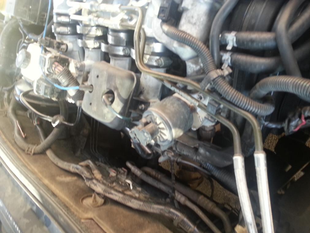

I bought this car a month ago for 2,200 and the next day it went in to the shop to have the heater core replaced. I got the car back and on the way home the heater still was not getting warm. I immediately took it back to the shop and they noticed the coolant turned to sludge due to the oil cooler busting. /sigh Long story short..... $1,700 and three weeks later I get the car back. The heater warms up fine now :-). On the way home though the car started to "cut out" and is gradually getting worse. It is not throwing any codes. Anyone that knows about changing pretty much anything on this car knows that you have to take the whole dang intake off to get to it lol. Well I changed the fuel filter today and the issue is still going on. I want to clean the egr valve but I'm not 100% sure where it is located on my car. It does have the 3.0. I think I found it........ passenger side of engine bay, closer to the firewall. It has a plug on top. I attached a pic. Is this the egr valve? Any other ideas would be greatly appreciated. Thank you

Here's a link to the one that Autozone sells. Check the link and you'll see a picture. That should help you. ww.autozone.com/autozone/parts/2000-Saturn-LS2-6-cyl/EGR-Valve/_/N-je1mpZ93xpy?filterByKeyWord=EGR+Valve&fromString=s earch
Well I cleaned the egr valve and still the same issue. Any ideas? I would normally take it to a shop but after sinking 1700 in it I cant afford labor fees anymore lol. Any help or suggestions would be appreciated.
I'm not at all familiar with the V-6 engine, but have you tried cleaning the throttle body? Go to your favorite auto parts store and get a can of throttle body cleaner and follow the directions. Don't use regular carburetor cleaner because it can strip the coating off the throttle body. Did you check the EGR valve and see if the diaphragm is okay? You can do this by removing the vacuum line to it and either suck on the hose or blow on it and see if it moves. You may have to remove it from the engine in order to do this. I don't know for sure. If the diaphragm seems okay, maybe it's a loose connection in the harness. Unplug and replug any and all connectors that you can find. Do each one five or six times in order to "sweep" the contacts clean. After you do each one, start the engine and see how it runs. If you do them all and then try it and it runs okay, you won't know which one it was.
