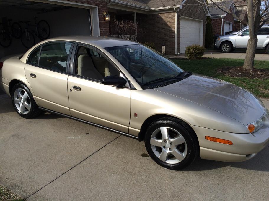

Pics as promised.
Attached Thumbnails 195/55/r16 tires on 2000 SL1-image.jpg

Looks clean man.
Just got a set as well, but for my Ion.

Looks great, Rob. I wonder if a set would fit my LW200? Hmmmmm, I may have to go to the junkyard in the next couple of weeks.

Wait, isn't your lug pattern 5x110? That is the same as the redline, not the base model. Base is 4x100
