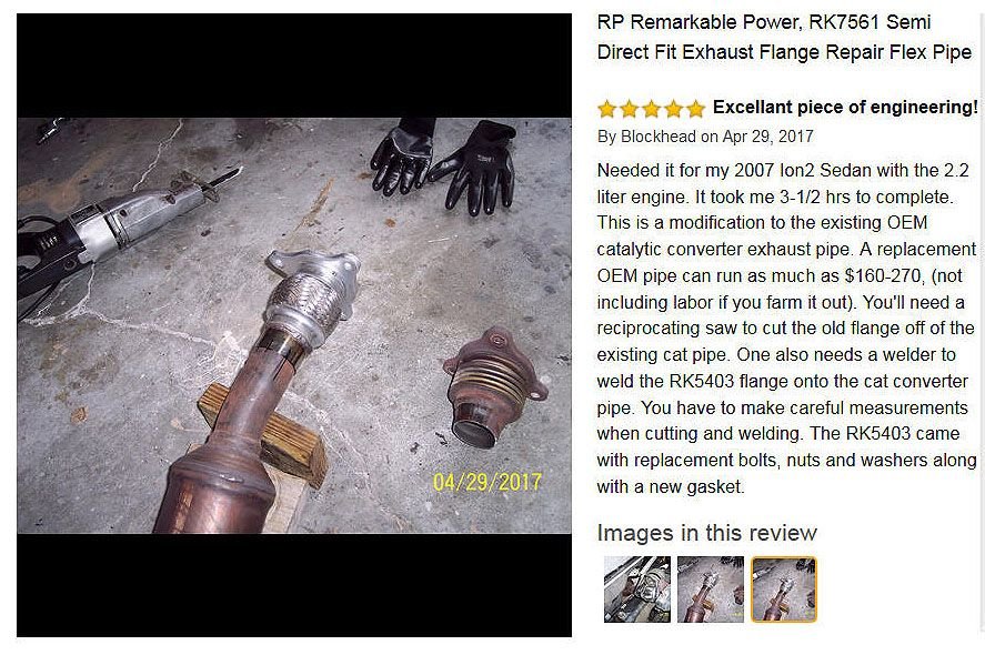

I get a consistent sound upon start up once the car has been idle for a long period of time, (cold). It sounds like an exhaust leak. It isn't the exhaust flange flex pipe, (I already repaired that issue not long ago).

I I will put the front of the vehicle up on jack stands and have a friend work the throttle while you are underneath. The obvious first place to check is the flex pipe. Last thing touched is often responsible for issues; while your repair may have fixed the original issue at hand, you may have inadvertently created another weakness which is now coming into play.

..... Last thing touched is often responsible for issues; while your repair may have fixed the original issue at hand, you may have inadvertently created another weakness which is now coming into play.
Absolutely. That's always been my mantra. I've looked everywhere and found that they're easily available new. So that signals that this may perhaps be a "planned obsolescence" thing. Only thing is that hoisting that thing up under jack-stands prior to start up, and having someone give it a whirl while I squeeze my bloated belly under there to check for leaks is no fun at all. No fun at all....

Perhaps. I did that work and that was the first thing I checked, (as Derf pointed out, 'last thing touched' should be the first thing checked). I checked a couple of times and did not feel any leaks. That gasket and flex pipe was a solid weld job I did back in 2017. But when I get a chance I'll get under there and eliminate or declare it as the problem. Just want to make sure the manifold is not one of those prone to cracking on this model Saturn.
